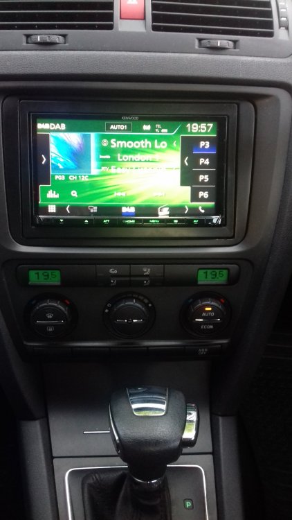

Firstly, only one week in with this.
Kenwood DMX7017, Android Auto (does carply but I have no Apple devices), Bluetooth etc.
Read lots of threads, went with this, so far it does what I want it to nicely, won't be for everyone.
£363 plus about £30 for a USB cable to my phone and a DAB aerial (on windscreen cheap one)
Was'nt interested in it integrating with car systems, Maxidot etc, I'm happy with info I get through Maxidot where it shows. No climate showing etc. Havn't fitted a rear camera (this unit can though), rear sensors are good for me, didn't feel the need for a dash cam (again, this unit can if you want).
What I did want : Voice activated - music, navigation (google maps) and phone calls with my very basic Samsung J3. I wanted DAB radio also. I have a google music account (£9.99 a month).
Saying "Ok Google" into the mic so I dont have to touch a physical button (there is a physical google assistant button on this unit and it works 100% of the time) works about 80% of the time. Possibly a learning curve but because the physical key is easy enough to hit this isnt worrying me.
Ask for any song/artist etc to play and it is played (tried bullinamingvase by Roy Harper because it catches alot of these services/voice recognition out), few seconds and it does it. Ask Google Maps to find any destination and navigate to it, it does. Ask to call someone, it does.
Music goes low or off (your choice) when Sat Nav or call comes in, all integrates well.
Quality of music, DAB, navigation and phone call sound is all very good so far, no dropouts or problems at all that I've seen reported elsewhere on internet.
There are quite alot of settings to mess about with if you want, attenuating different sources to integrate with others, graphic equaliser, speaker configurations etc.
Hope this carries on being a good experience and helps anyone else with similar wants. Any problems in future will let you know.

Looks like this :
