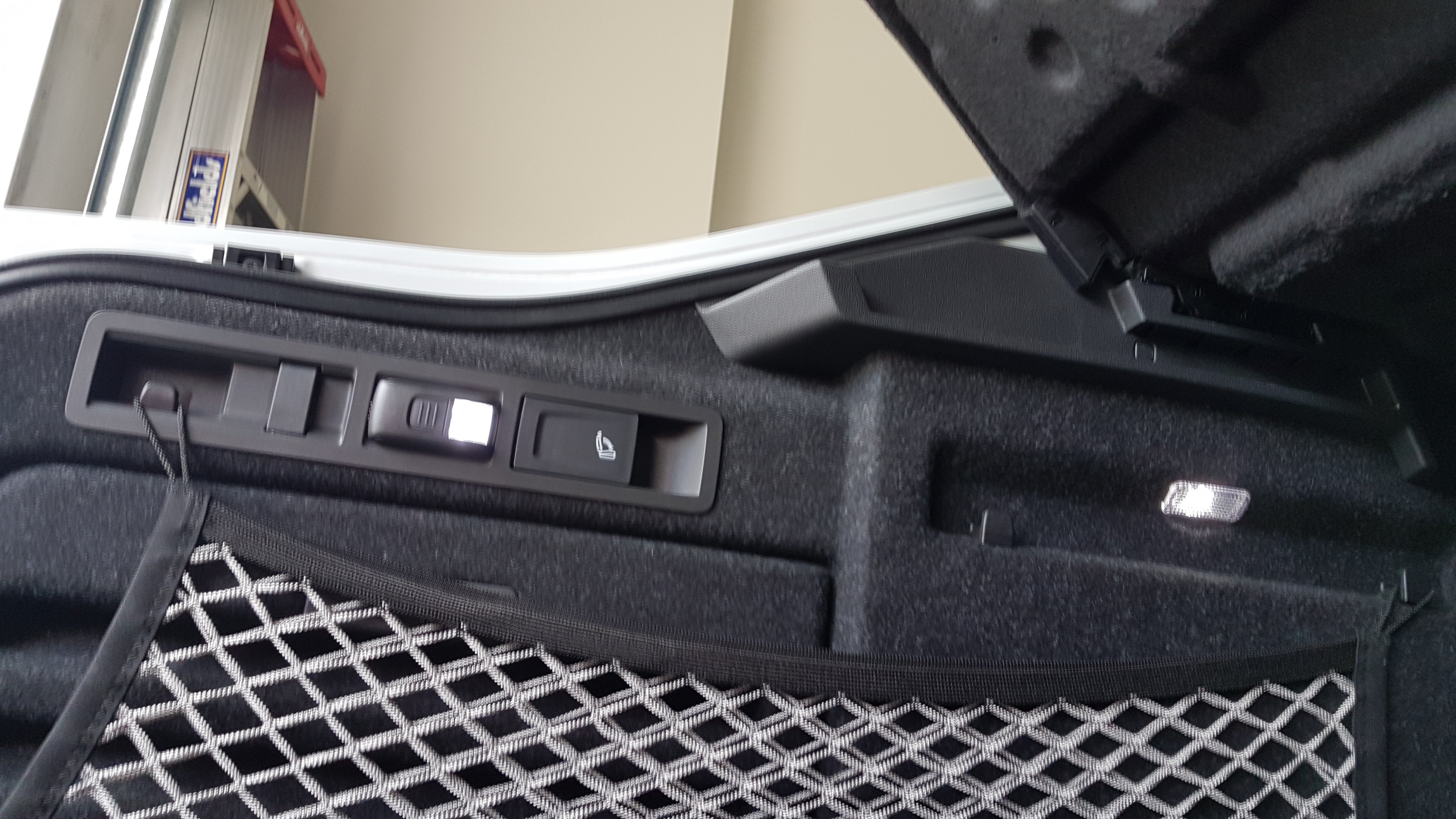

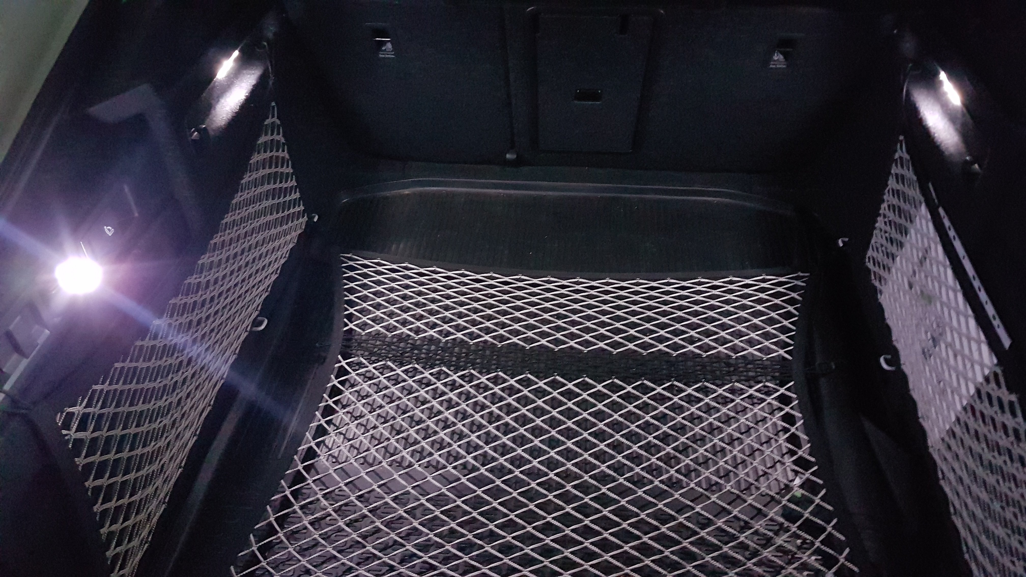

I have replaced the two boot lamps and the removable LED torch with items from the Kodiaq (along with the Glovebox light). They are a higher Kelvin light (Cool White) and the two boot lamps are LED (not W5W bulbs as we have in our Superbs)...
Genuine Part Numbers: LED Lamp - 8J0947409B (x3) / Connectors - 8W0971832 (x3) / Removable LED Torch - 3T0947417F9B9

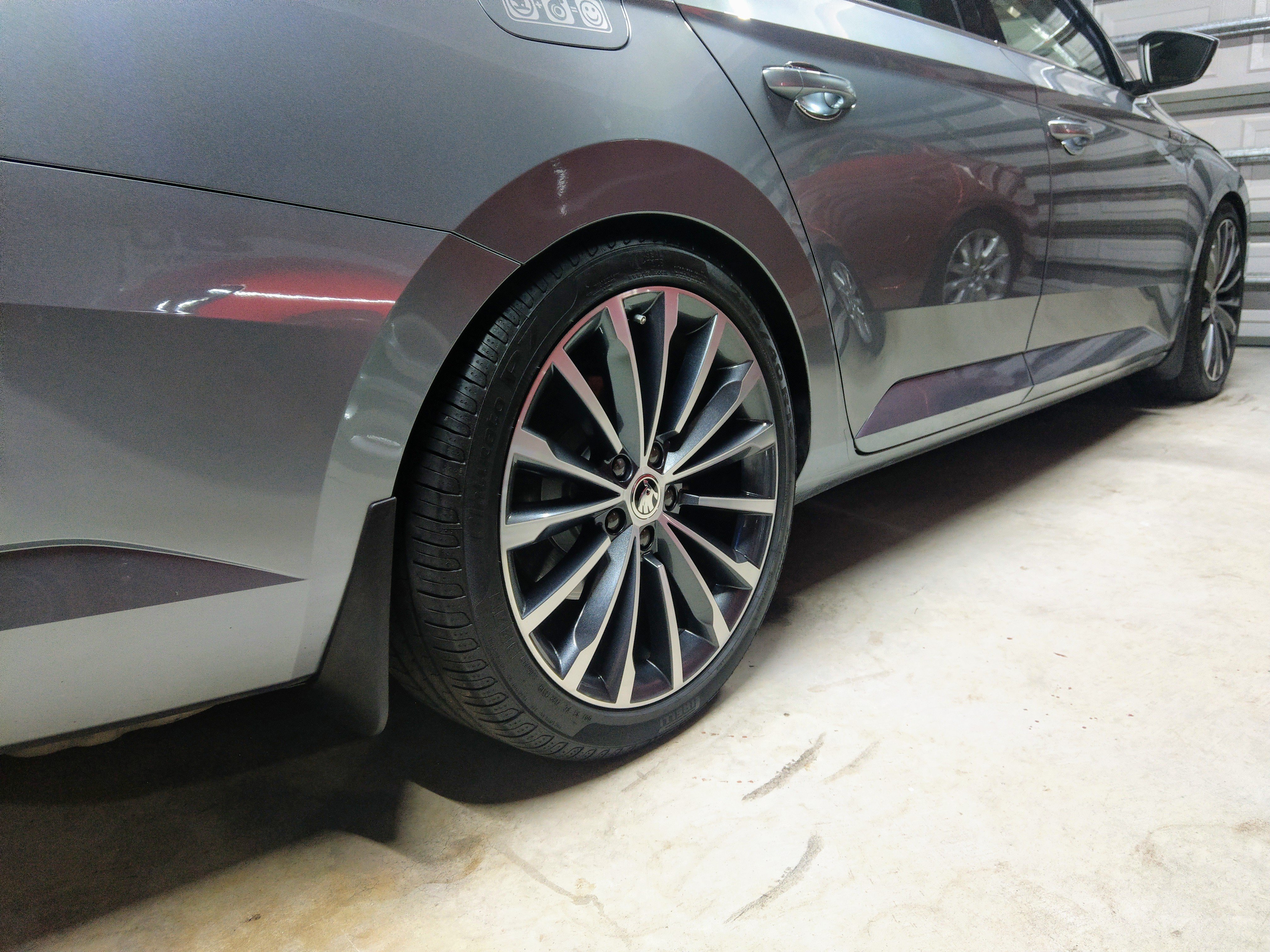

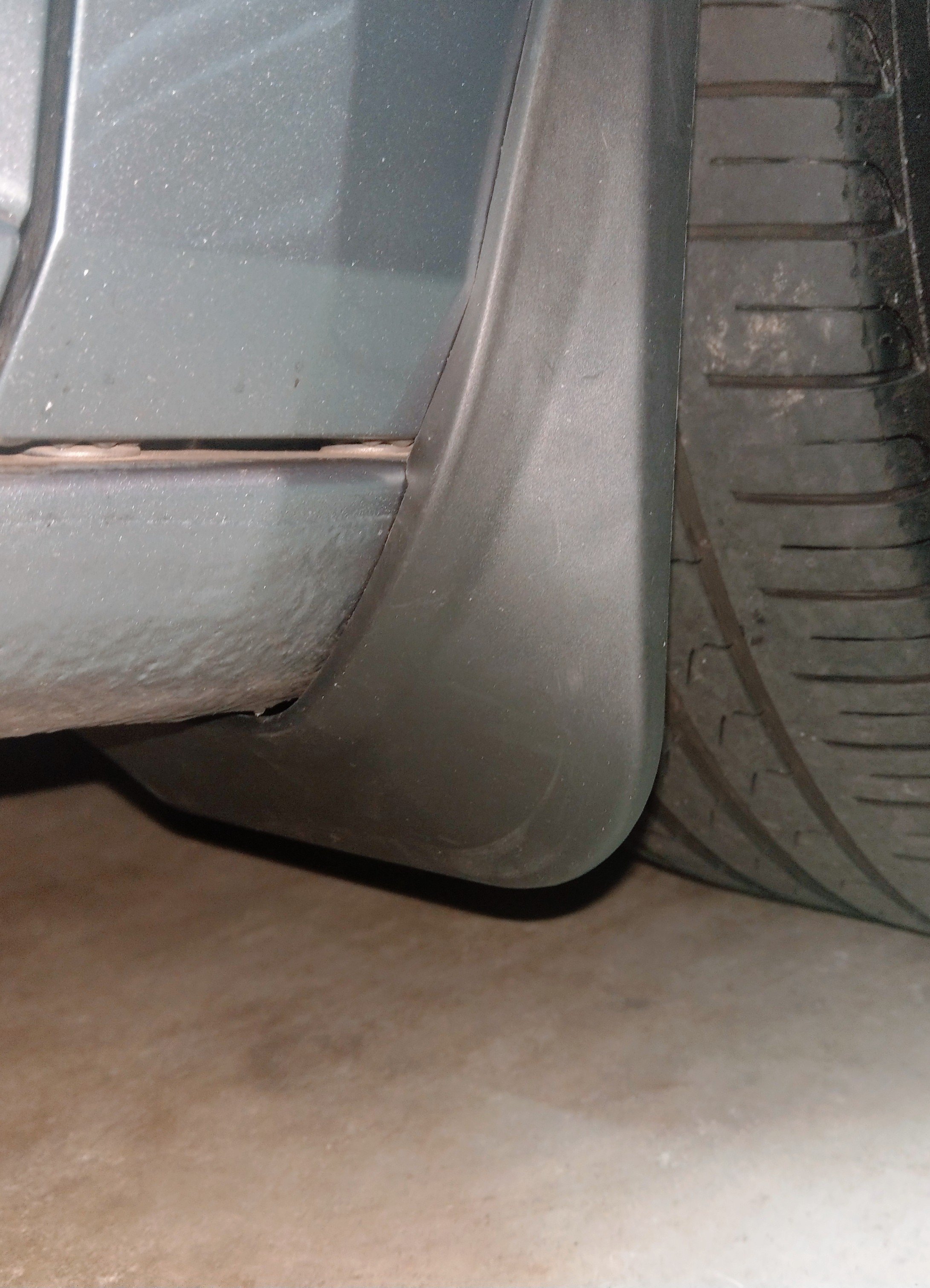

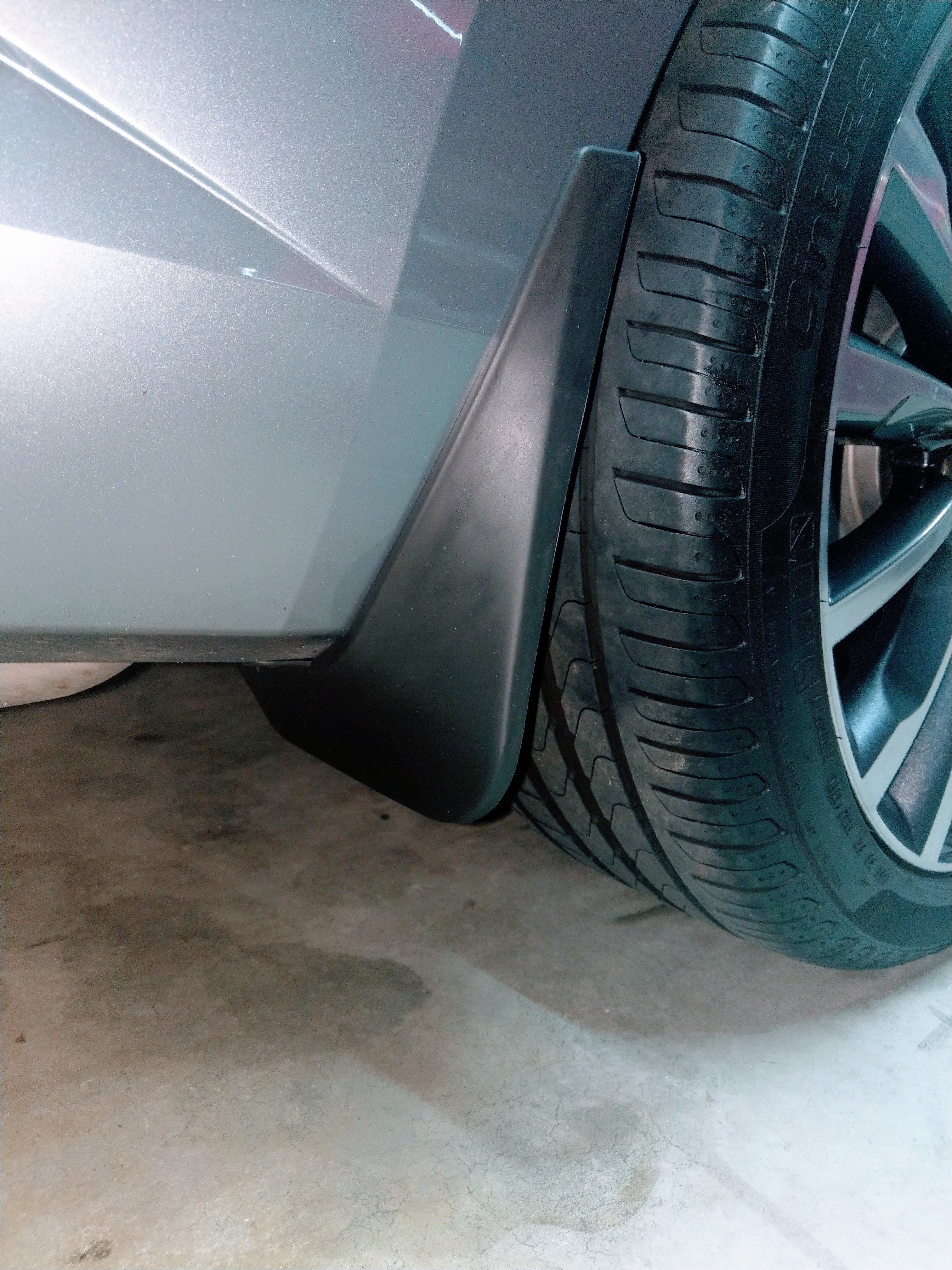

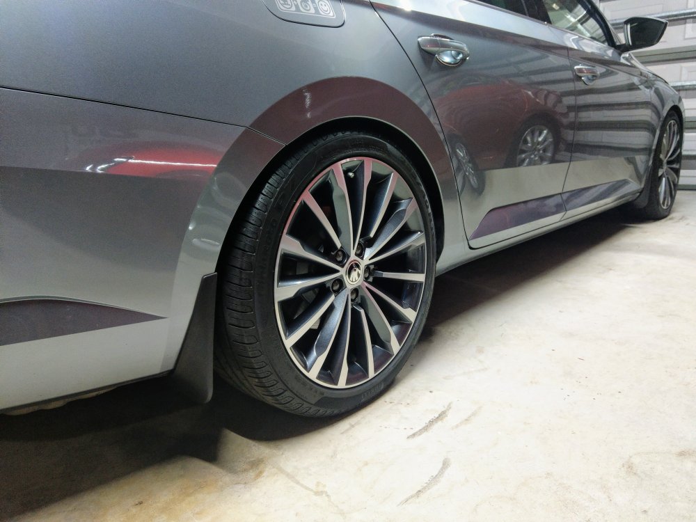

Fitted mudguards to my Superb today.
Happy with the fitment and quality.
Another AliExpress special :)
Front fitment......
Rear fitment......

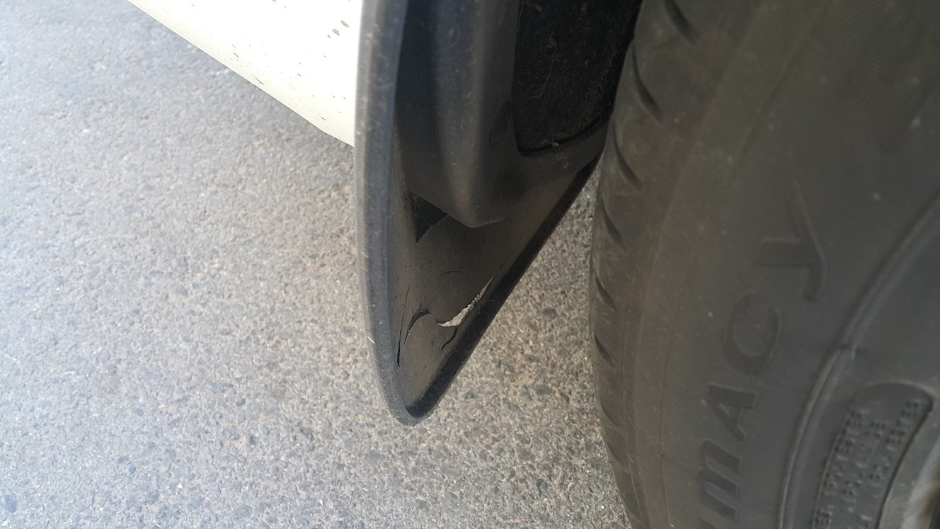

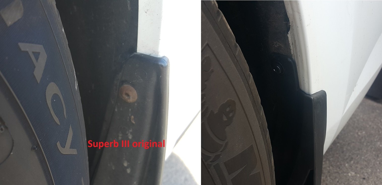

Ali version is smaller and same hard plastic as originals,
one winter and i have to order new 😞
the ones i got from Ali r quite flexible!
i was bending them with no sign of breaking or stress.

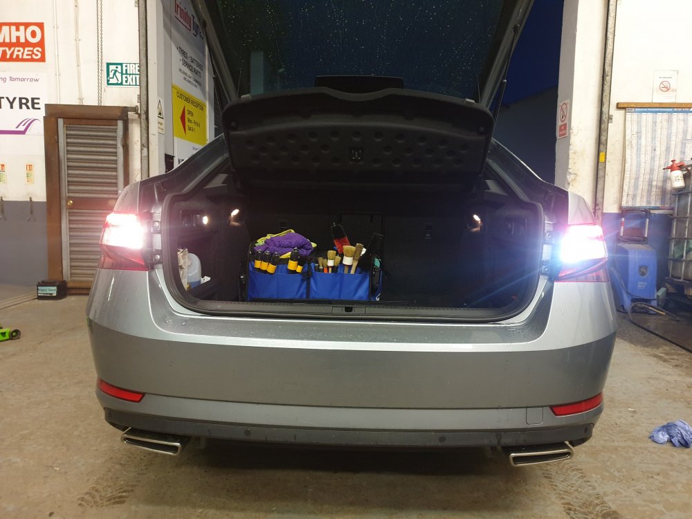

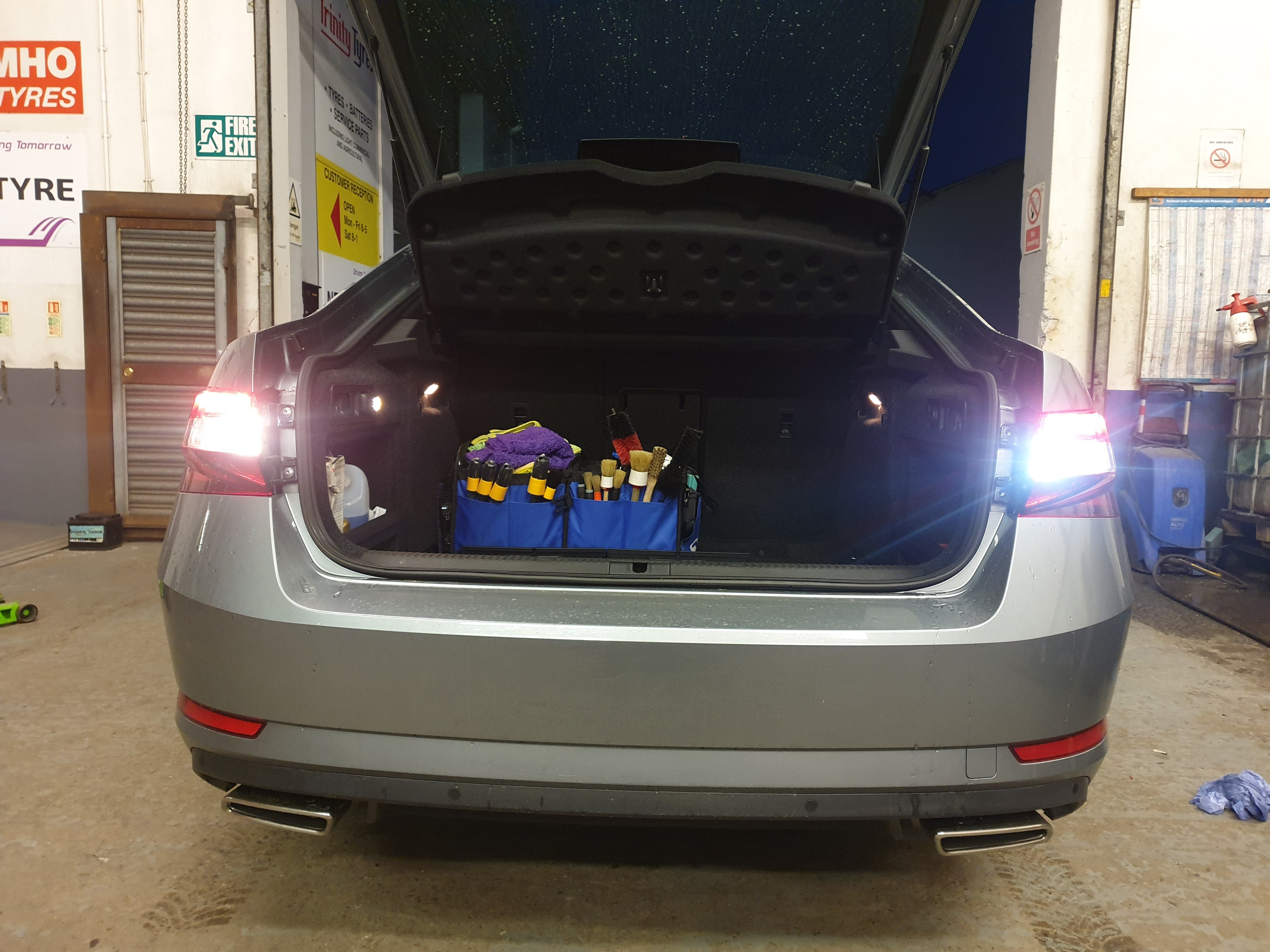

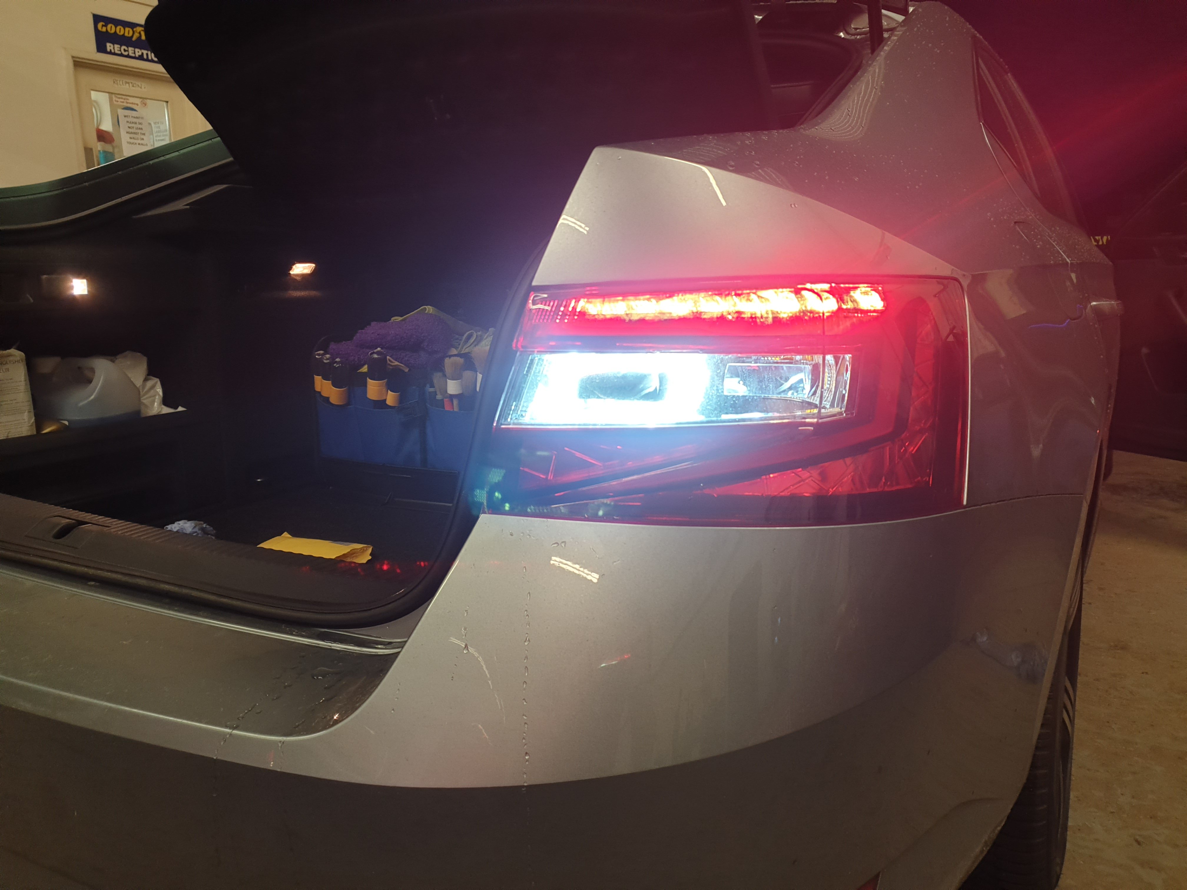

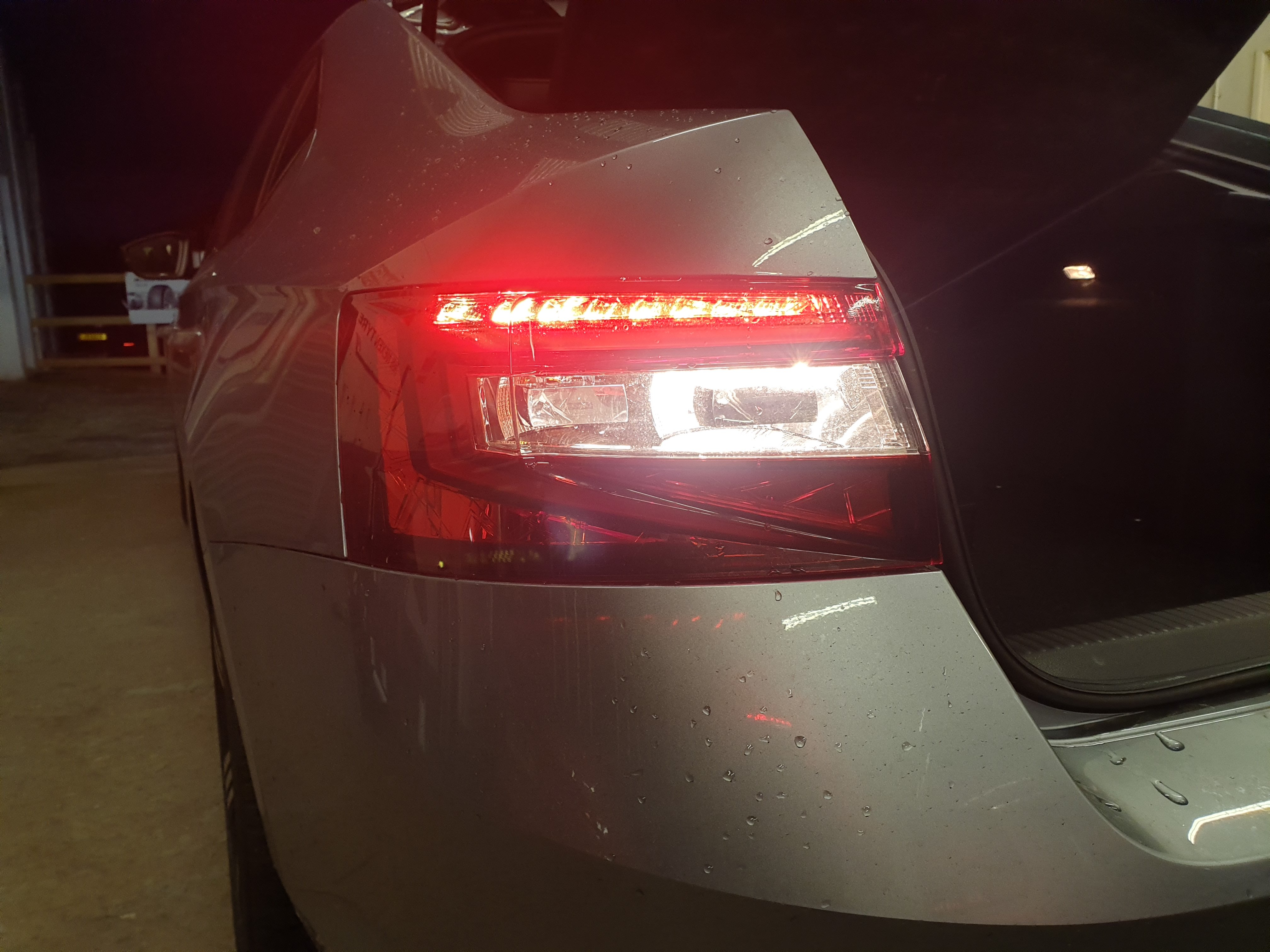

Fitted reverse LEDs... Love them
