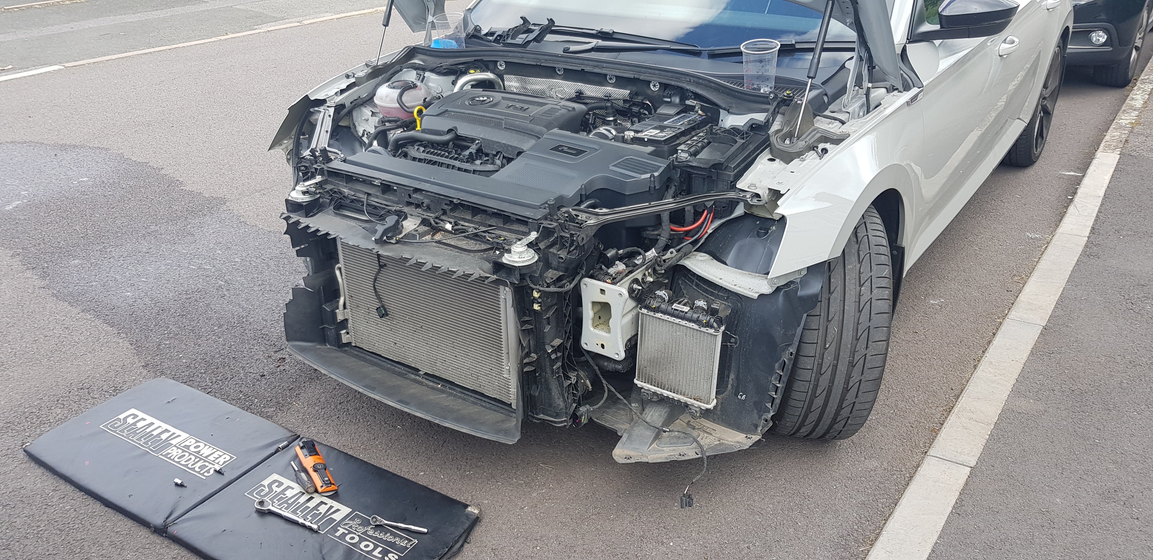

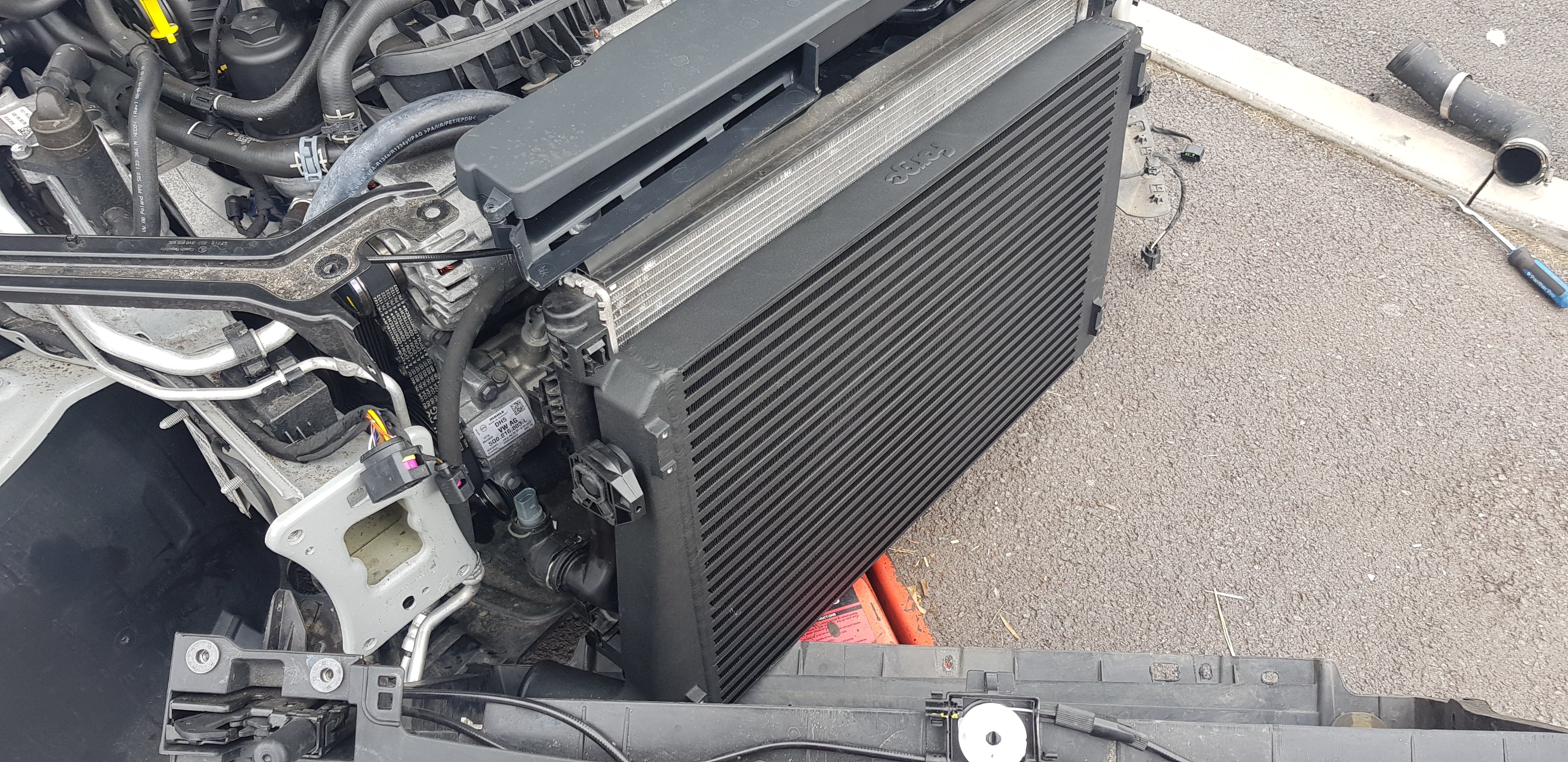

New Forge intercooler fitted. All I'll say is never again 🙄20200720_120513.thumb.jpg.4f15d2b47d0e3aaec6fc7e275b1944c3.jpg
Know what you mean after having an Airtec intercooler fitted to my Vrs245 back in 2018. Once bitten twice shy as they say. Make sure you haven't lost any gas from the air con by checking the climate control still blows cold air. The latest factory refrigerant is very expensive to replace.

Cheers, yes first thing I done was turned the air con on for 30 mins or so and no leaks 👍.
Probably the only job I don't even consider doing on mine myself after having seen how much of a PITA it is on these cars, I'm gonna take springs and shocks install any day over that.
Congrats on the determination and I guess you're going stage 2? If so i'd love to see the exhaust and tuning options you make as it's been unusually quiet on the Stage 2 front for GPF cars for over a year now, especially the international names like APR, REVO and Uni are all stuck at stage 1 it seems, probably cos they still don't offer their own GPF downpipes.
PS. Why Forge though?? Their intercooler is the worst flowing of all options out there, lagging even generic eBay ones :worried:  In fact, most of their products are of average quality/performance at best, they are way too popular for the performance they provide, but they do are cheaper in general.
Each to their own I suppose, I’m more than happy with my Forge products and that’s the first I’ve heard that the Forge is the worst performing. Oh well too late now I’m not returning to stock.
My personal experiences is with leaking BOV's for a different platform but there's quite some testing (independent) that has been done particularly to the intercoolers for this platform too.
To some extent I agree that it's just an IC so you shouldn't worry too much especially if you got it at a bargain price (some of the high-end ones are freakingly expensive for a damn IC) but when you see that they flow the same as a stock GTI cooler you wonder why bother in the first place.
I'd also not want to have to touch it again though as you say.

Looking at those results it does indeed suggest its poor performance regards airflow. But then the same guy tests cooling and his conclusion is it’s the best performing. So I’m not going to worry too much
http://mygolfmk7.com/2020/06/forge-motorsport-intercooler-bench-testing/
Yeap, that's the guy. However if you read the full article and the subsequent articles, he did not say the Forge is the best performing overall, but rather that the Forge was showing the lowest temp rise at the bench cooling sub-test. He continued by saying it lags the rest of the intercoolers flow-wise. Also, at the time the Forge was tested, he had not tested APR and Mishimoto which were found both to offer even better temp rise. The full assessment:
However, the cooling sub-test is only part of the entire testing process and seems to contribute little to the overall performance as all aftermarket IC seem to not be too far between each other. That's why flow differences affects the total performance to a greater extent.
The results of the complete testing are laid out on the 2-dimensional chart below:
There's at least a good temp rise improvement compared to the stock GTI IC so I agree you shouldn;t worry too much, the better flow capacity is probably only an issue on bigger turbo setups, but it's useful to have that info anyway.
So what other mods are you running if you don't mind sharing that?

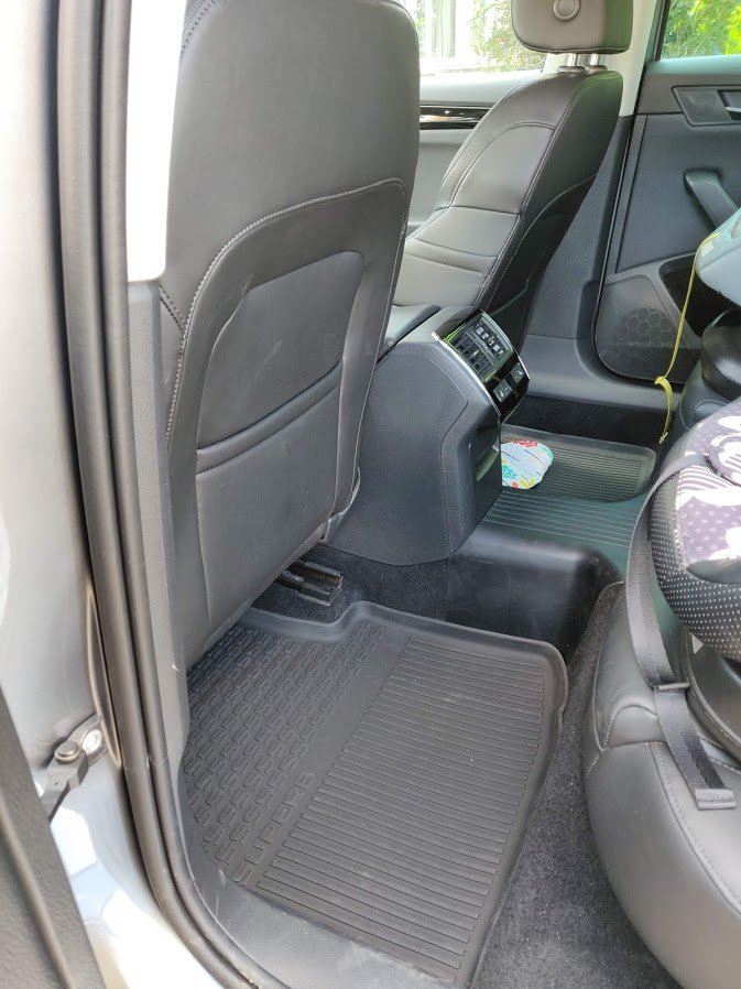

'Fitted' the official Skoda rear rubber mats and tunnel cover today from SuperSkoda:
http://www.superskoda.com/Skoda/SUPERB-III/Floor-mats-Carpets/
Very pleased with the results, they fit perfectly (unsurprisingly) and should further child-proof the car!

I think all cars should come with rubber mats standard and carpet extra. It makes no sense putting carpet on any car floor.
I run genuine rubber mats in both cars (kids do heaps of sports), so much easier to clean.
I love the Tunnel Cover in my Superb, shame the Passat doesn't have one available...
