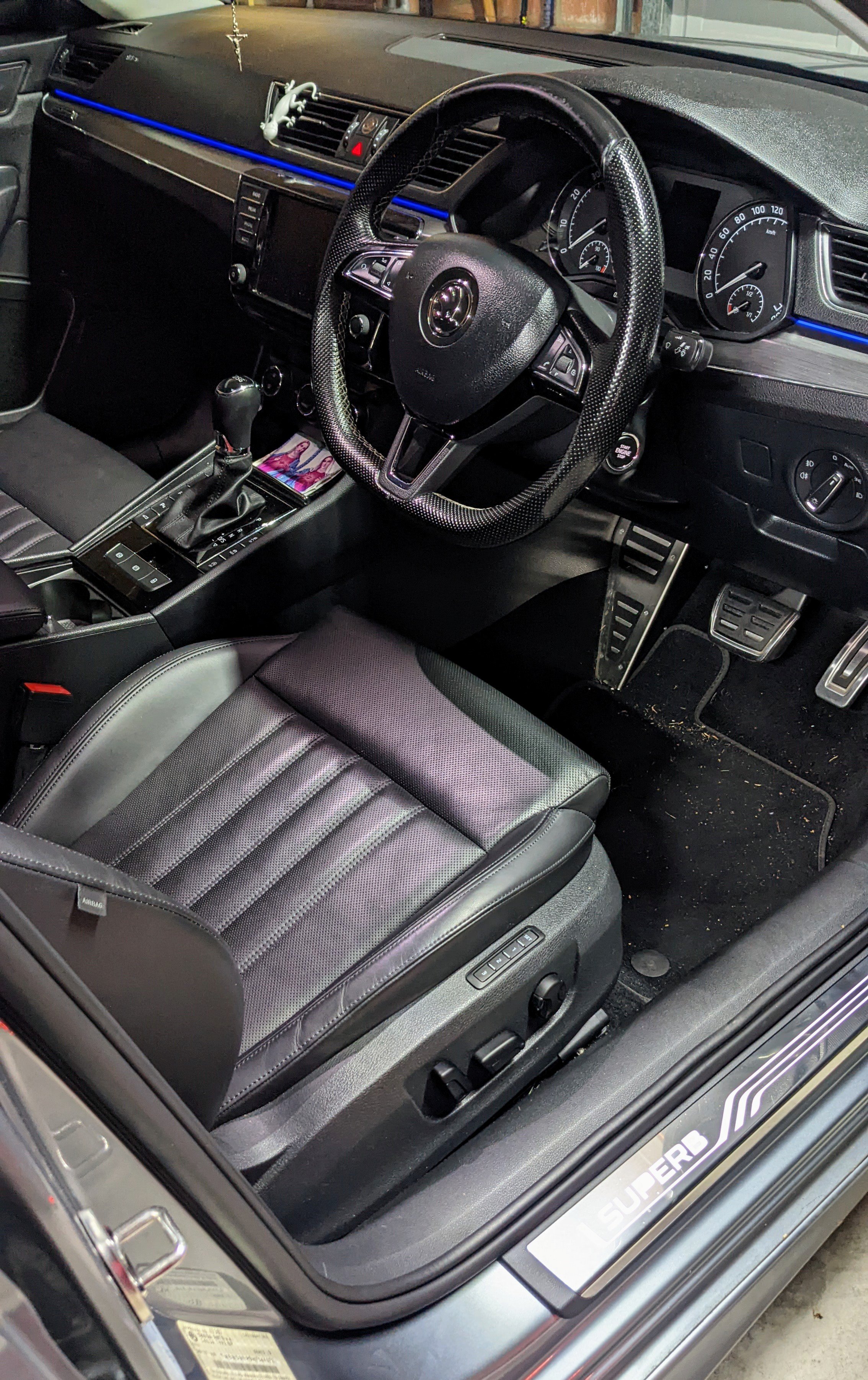

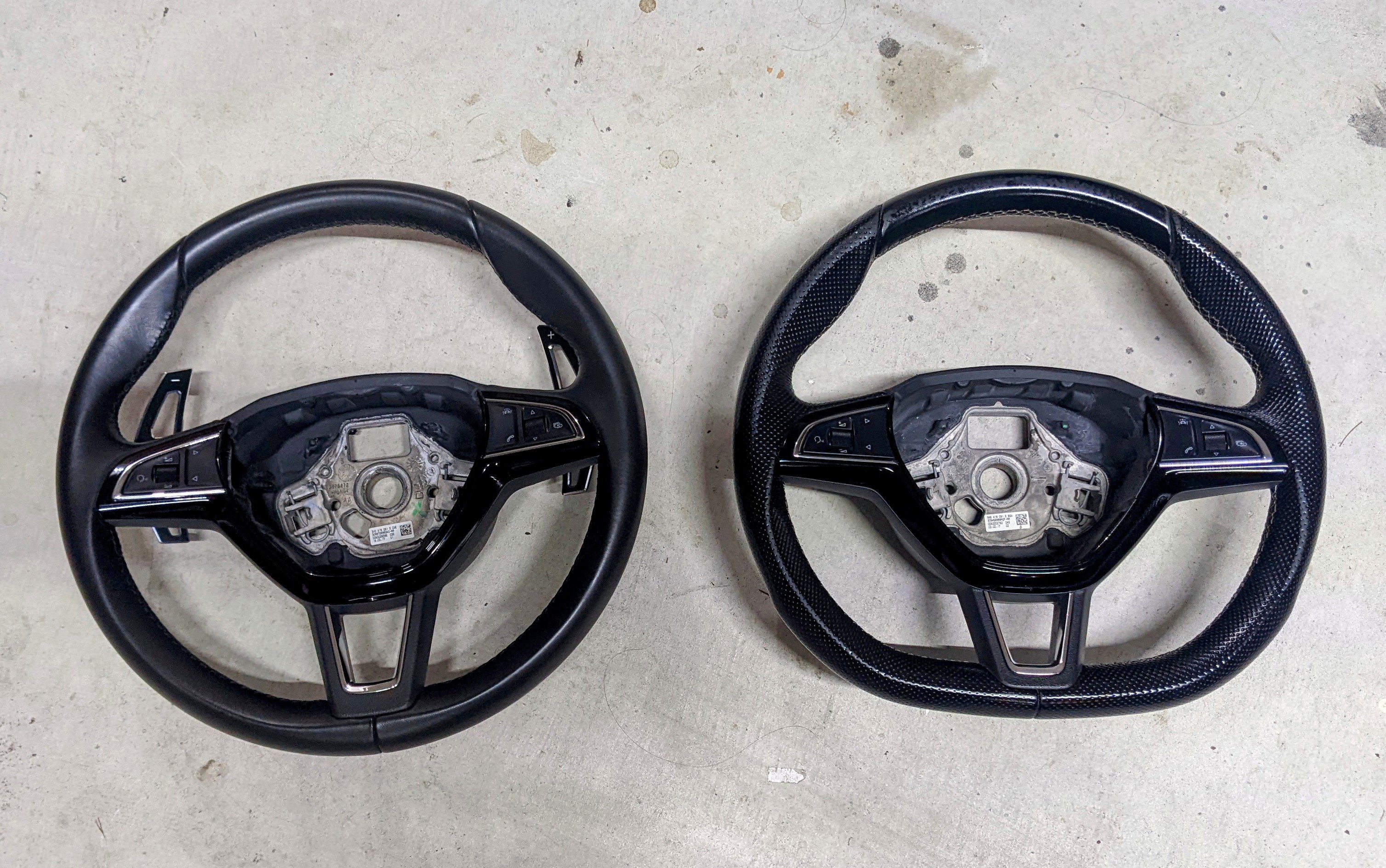

Flattened Gandalf's steering wheel today.
Got the Sportline steering wheel for a price I couldn't resist.
Original wheel - 3VO 419 091 S CWE
Sportline wheel - 565 419 091 E BGW
Swapping out the wheel was quick and easy.
I did not disconnect the car battery.
With the car running, popped out one side of the airbag clip, turned the wheel over, popped out the other side.
Left the airbag module in the wheel, straightened the steering wheel, turned off the car and left it for 20 mins to "sleep".
Then unclip the connectors, remove bolt with M12, to remove the wheel.
Put Sportline wheel in place and tighten bolt, taking care to put it in the exact same spot/alignment. Plug in the connectors.
Push airbag module into place.
Done.
I do miss the DSG paddle shifter extensions though on the Sportline wheel, so I've got a new set on the way, similar to the one I had.
Edited by JR RS
