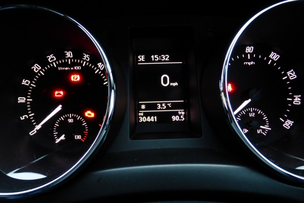

does the dash look like this
Hi All
Llanigraham - Carista didn't to give me an option to add a Digital Speedo option to the MFD.  If it is possible maybe it needs VCDS.
AMD87 - Dash looks almost the same but no Digital Speedo option.  Maybe FL models lost it.
I have just used Carista to put a MPH on the display.
You need the change car to Australia option with a few extras.
In the MFD
Change  l/100km km to MPG
Deselect tick in Alt Speed Display
In Settings
MFD Data
Tick: Diglt Display.
Brilliant, it worked!!  Thanks to all who have helped.
