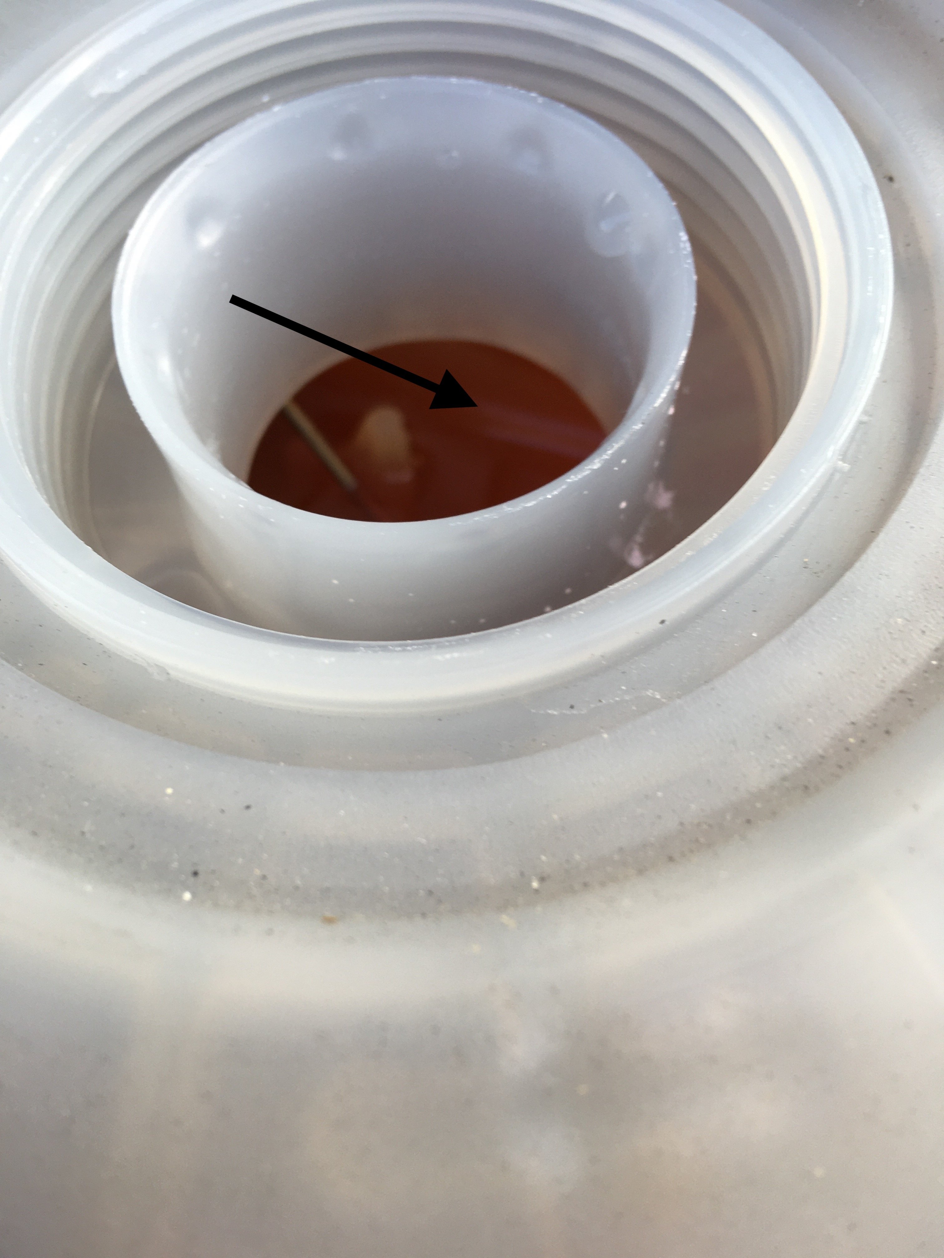

Is this bag of trouble easily located in the bottle, couple of months ago I had a fish round but couldn't find it after alarm bells rang finding it marked MIT Silikat.
Yes Ben, dead easy (well it was for me).  Stuck my finger in and could feel it straight away.  The feint line at the end of the arrow is the top edge of the bag:
This is on my Golf GTI, and I have to say I feel a bit conflicted.  My car's still under warranty, so I could potentially affect it if I remove the bag.  Other reports (as we've also seen on here) are that the matrix getting blocked can be sand from casting the cylinder head.  I think I'll discuss it with my local VW before deciding what to do.

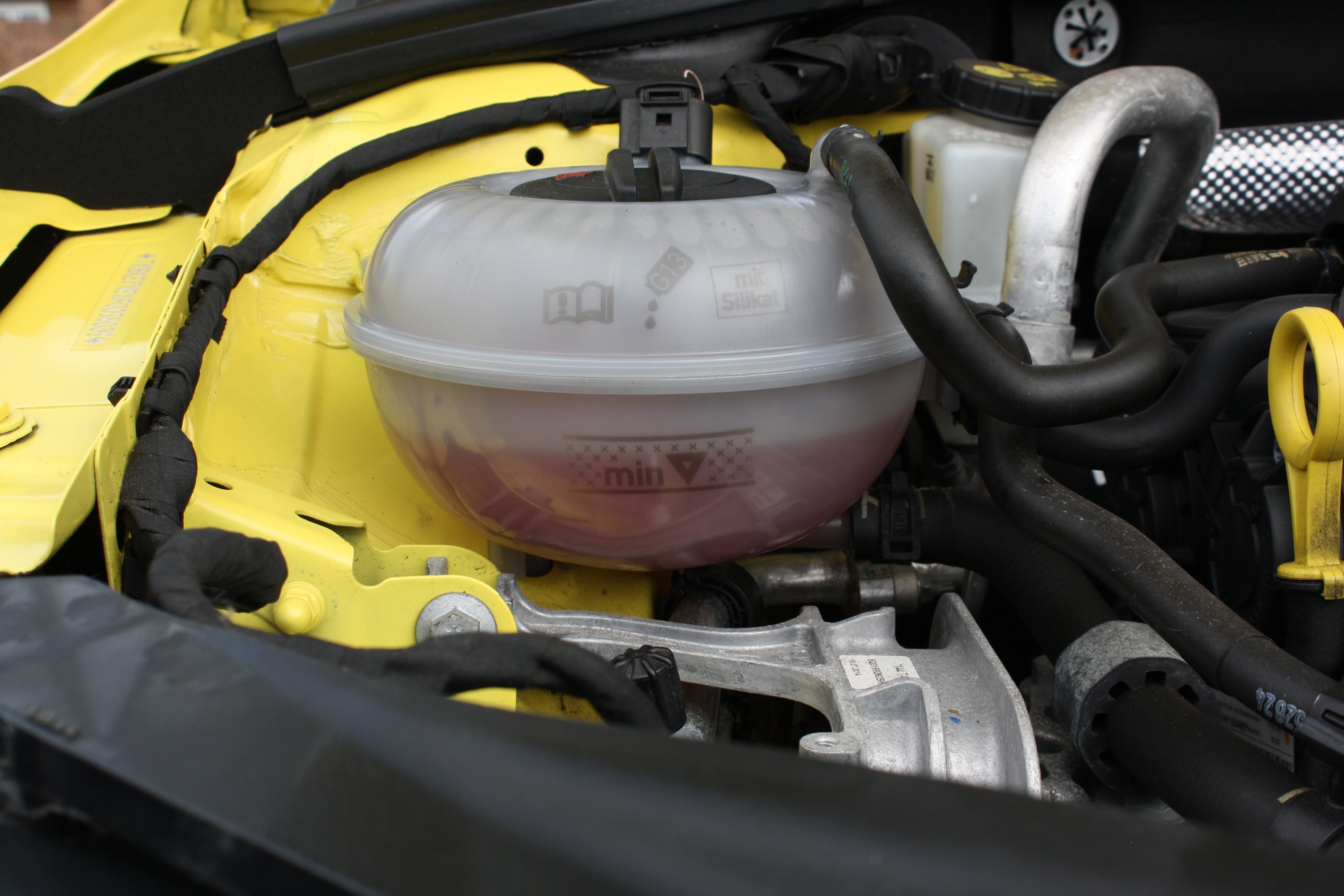

A picture of my expansion bottle ...no bag.
Regards
I have the dual zone climate control....
…& NO "Mitt silicat" writing or silica bag in my tank..& yes I have shone a bright torch through the tank, & the car I have had since factory...

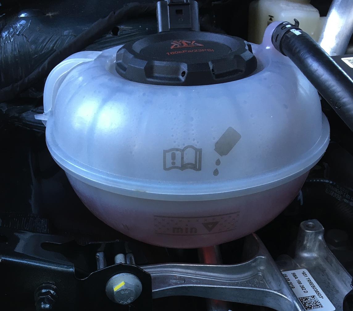

My 2015 vRS had a silica bag:

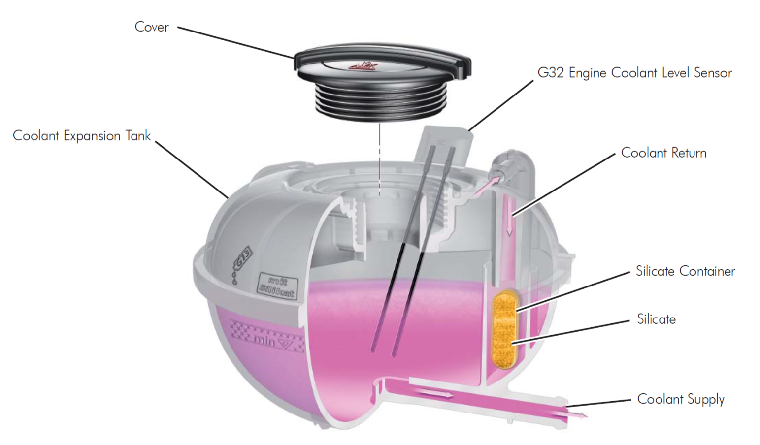

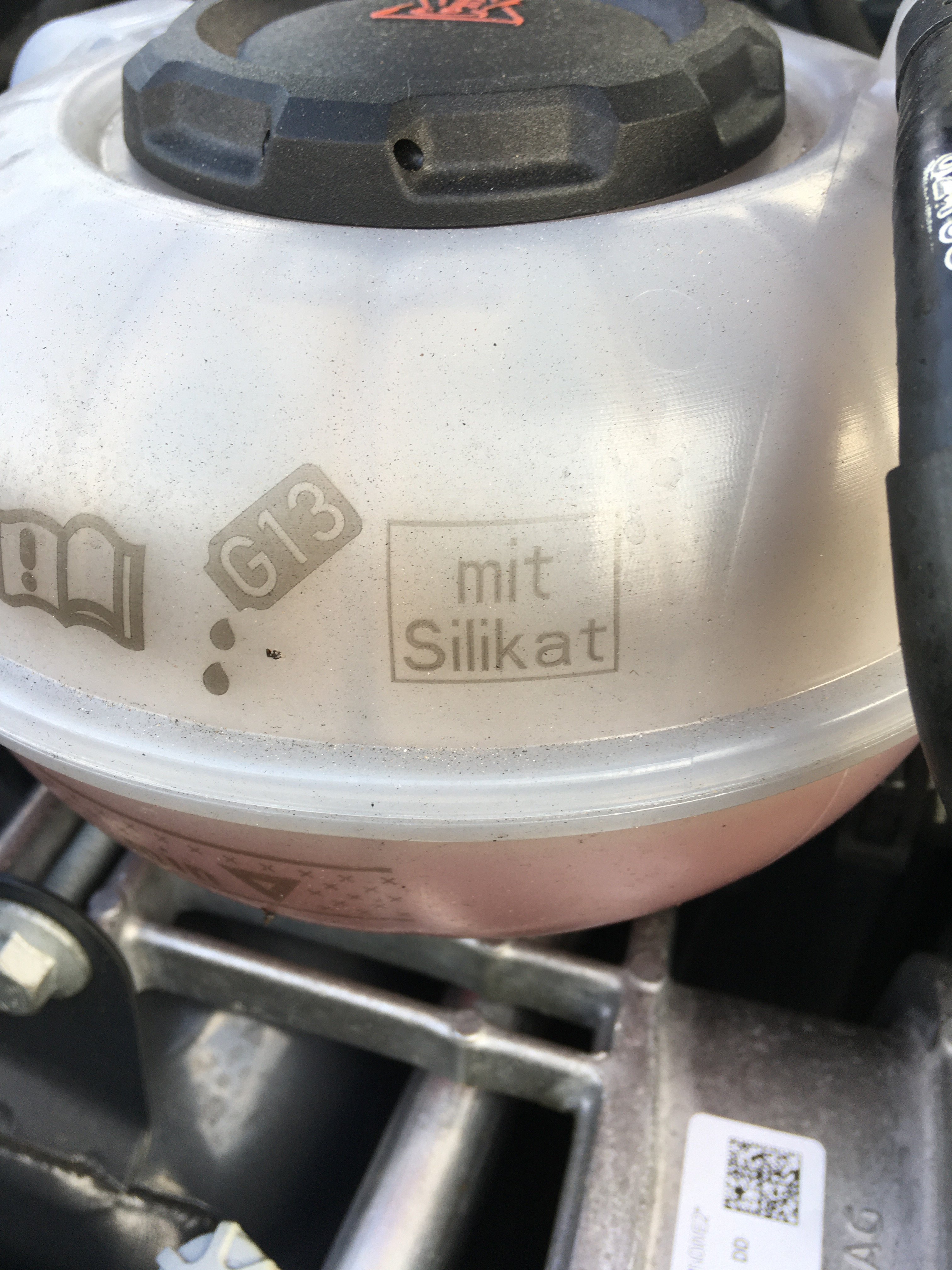

I have a Scout 1.8 TSI made in June 2015. The expansion tank has "Mit Silikat" sign on it. However, I cannot locate the bag with silica in the tank. Please see the video attached. I was wondering if anybody can clarify what different versions of the tank are out there. My thank appears to be double walled. The inner chamber is quite small and there is no way the bag that was pulled out in Youtube video (further up in the thread) would fit in this small space. The outer chamber cannot be accessed from the inner chamber and the silica bag might be in there. Is this the standard design of "Mit Silikat" tank? Or, is this something newer? Is it perhaps, that this setup is 'safer" than the single chamber tank (with the bag placed on the bottom as in the video referenced above)? I would like to get rid of the tank only if it isn't safe. Any help will be appreciated.

Just popped out and removed the silicon bag from the expansion tank. Very easy to do and took less than 5 mins.
I cannot find it or I don't know what to look for. Where was the bag positioned in the tank?
This is what I think is in my car. How do you remove the silicate from its container? There is no bag that I can see. I don's like the colour of the coolant in my car.  It is not pink, more like brownish/reddish.
This design is new to me. When I checked my tank which was labelled mit Silikat l couldn't find any bag. Presuming it had been removed earlier I'll have to check out for this tank design.
