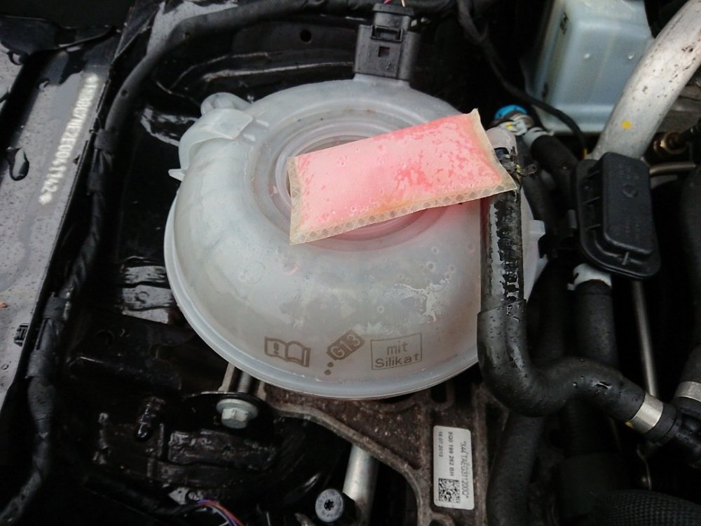

Just read this thread, so decided to go out and have a look at our octavia.
Sure enough.
IMG_25012020_095648_(1080_x_810_pixel).thumb.jpg.e7f375a2af719074e2d0a9500987f461.jpg
Was a bit of a sod to get out but and few cuts and scrapes and I managed to fish it out.
That is big! Nothing like that in my tank although the "Mit Silikat" stamp is present

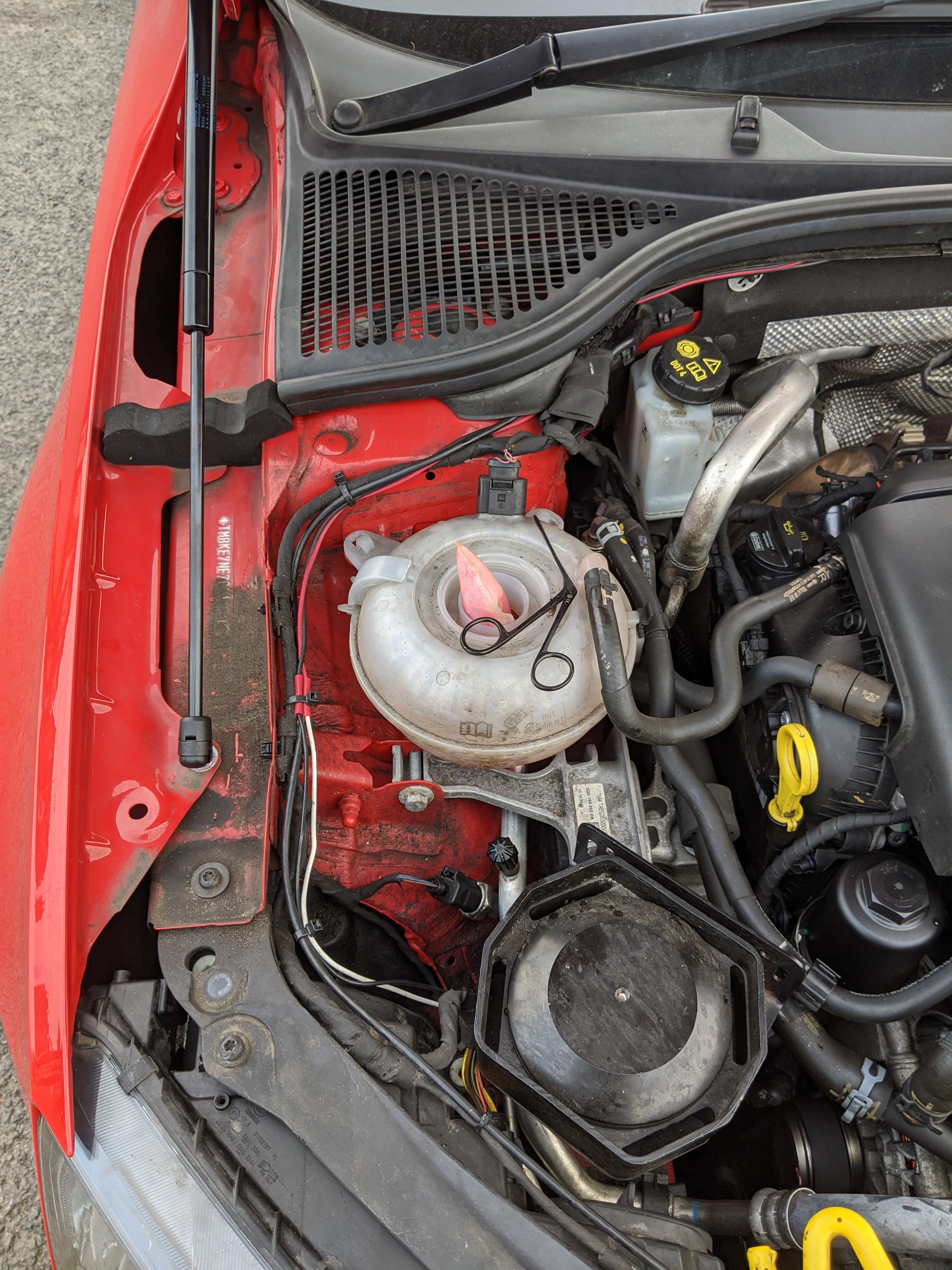

bit fiddly to get out as the silica was pretty solid and the wrong shape for coming out the round hole at the top. the little mosquito forceps were handy to grab an edge, but i went very gently to avoid tearing the bag. overall took less than five minutes to do!
