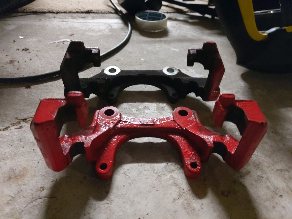

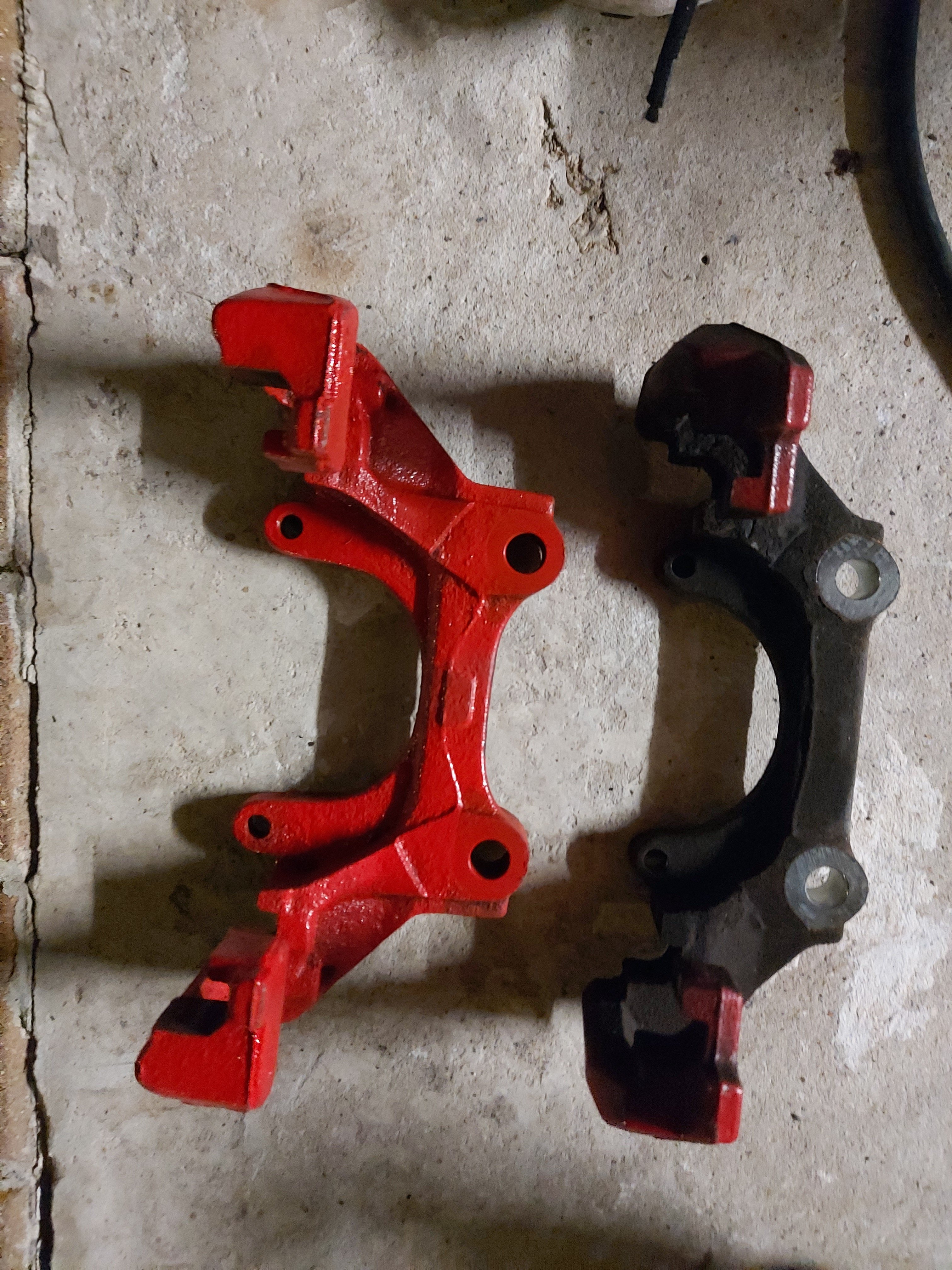

I managed to find some Audi TT mk1 312mm caliper carriers for £20 they seem to fit. The calipers on the 6spd 110ps fabia are 288 and 312. New discs and pads arriving next week
The caliper istself it´s the same of the TT, you just need to swap carriers and dust covers.

The TT caliper brackets are very slightly different. The one from fabia is half painted and the TT one is fully painted. I couldn't get the spring clip to stay on. The small tabs are on the inside on TT and outside on fabia

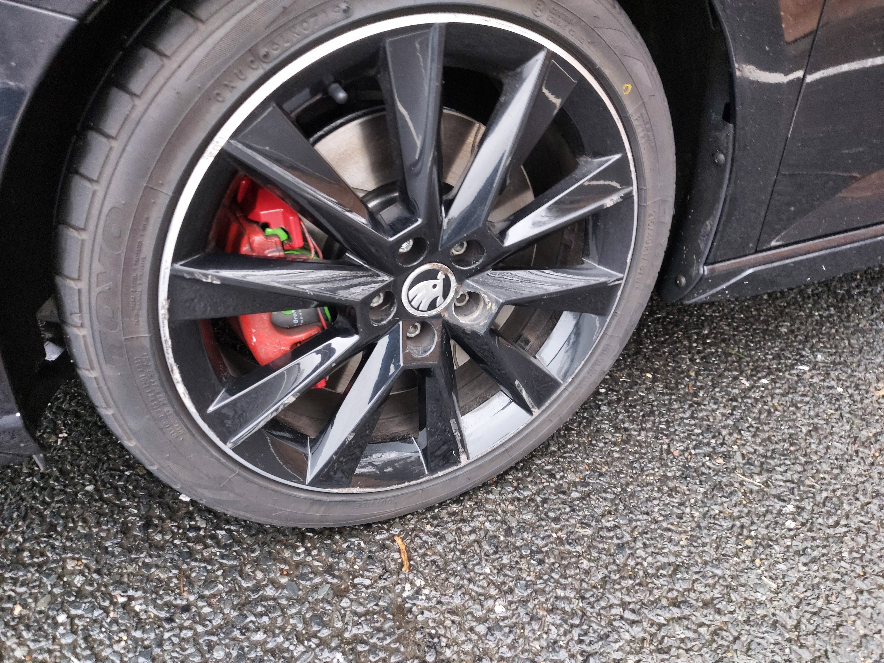

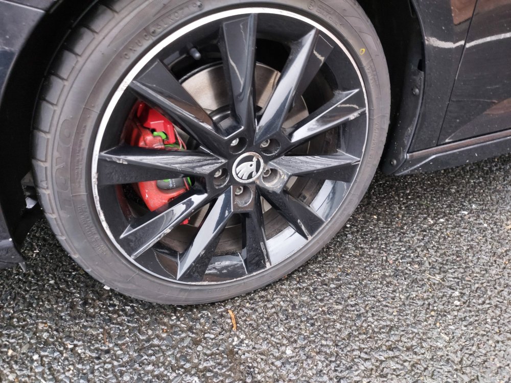

I have managed to upgrade to a 310mm setup. On the 6 speed fabia the calipers are the same as the A1 polo 6r 6c ibiza. I've used 312mm discs from the mk1 tt and green stuff pads that fit the 312mm brakes on the Ibiza cupra and A1. Pics to follow. Was very easy with the right Caliper brackets.

The Mk4 setup didnt work properly the calipers are a bit different. I did not want to change calipers as i have not done it before. not 100% sure how to bleed brakes. So i used the  my stock 288mm caliper from the 1.2 110ps 6 speed manual fabia. and just changed carriers, discs and pads.
The carrier was from a Polo 6r,6c 1.8GTI - BTW the slightly older 6r,6c 1.4GTI has a 288mm setup i believe
My stock caliper is the same part number as the Polo 310/288 setup
There seems to be limited options when it comes to 310mm discs. so i used 312mms from a mk1 tt/ mk1 octavia.
