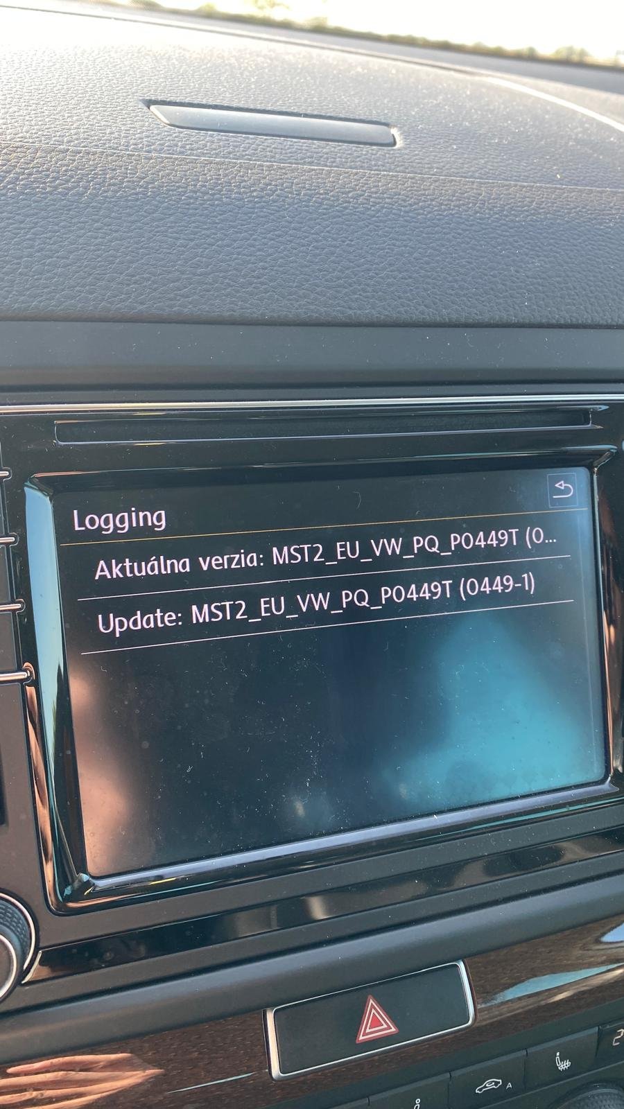

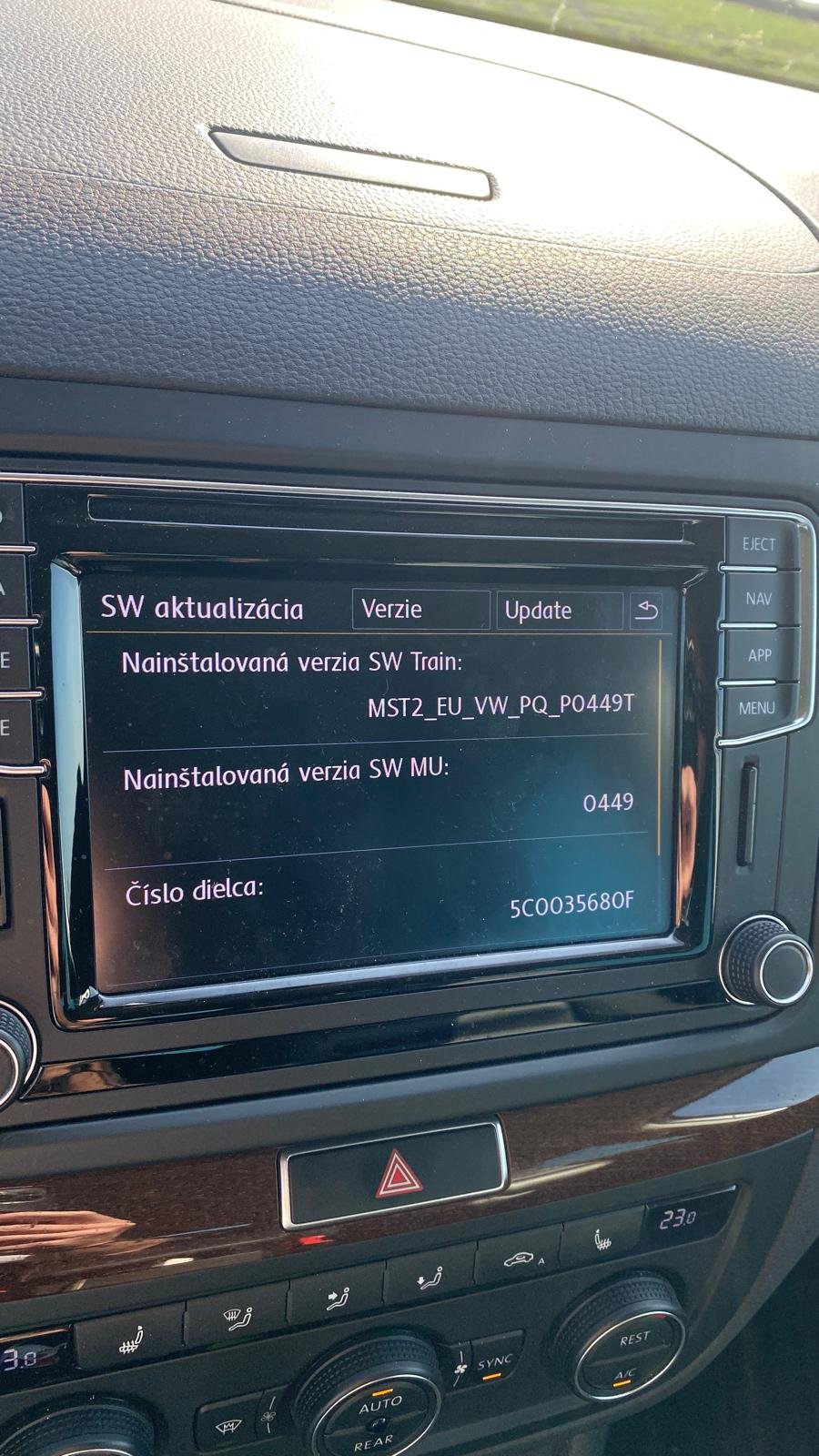

Hi @pab567 im looking for firmware update for my VW Sharan 2017, the software details are on the pictures.
Thank you for your help !

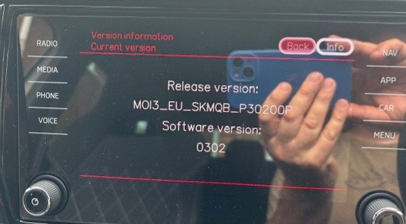

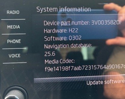

Hi all, would anyone kindly help me with an update for this MIB3 in my Skoda Karoq. It misbehaves quite often and I realise it could be down to the out dated firmware as it has never been updated (2021 Karoq). Currently I have version 0302 on it.
Many thanks for any help.
Kind regards
Nath

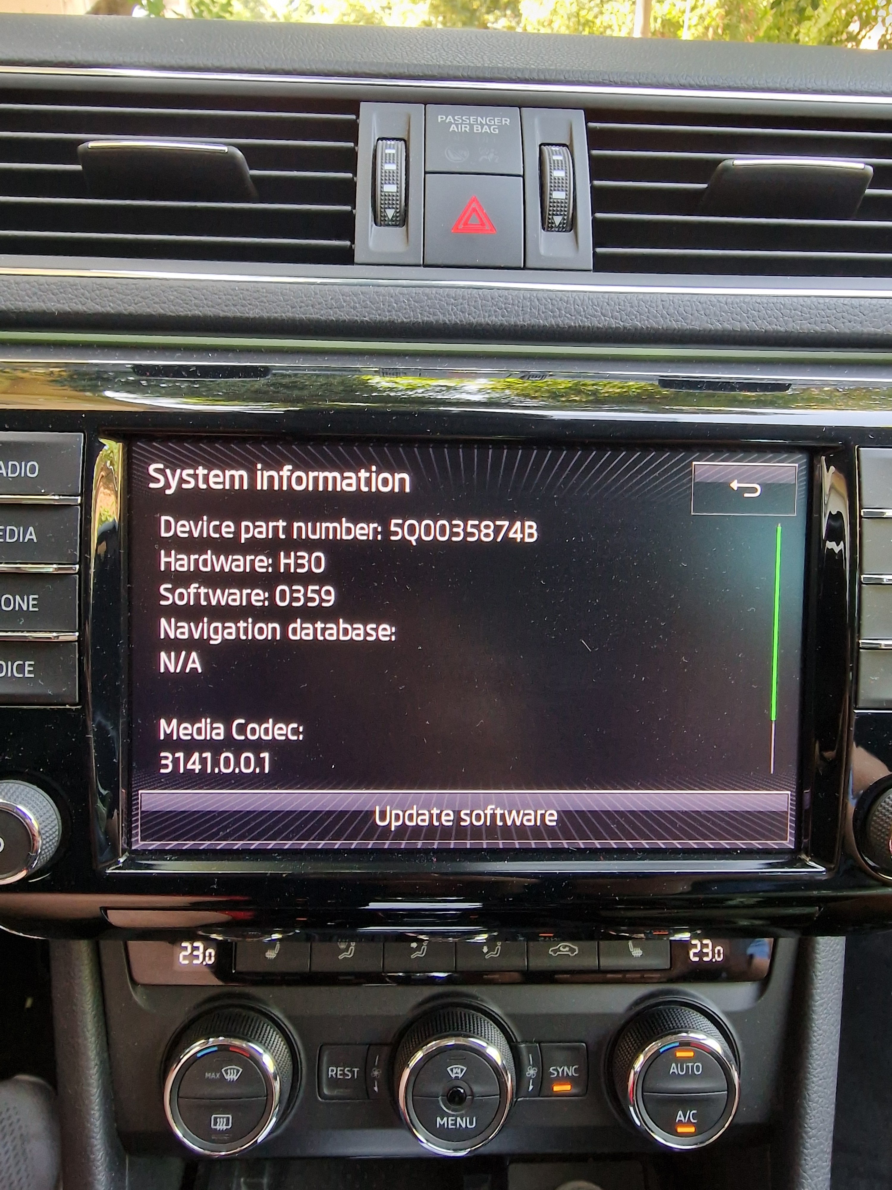

Hello, I have a Seat Leon infotainment with hardware H30, SW 0359, train MST2_EU_SE_ZR_P0359T.
Could someone please share the MST2_EU_SE_ZR_P0479T firmware package (.7z) with me?
Thank you!
You can Not Install 0479 direkt
