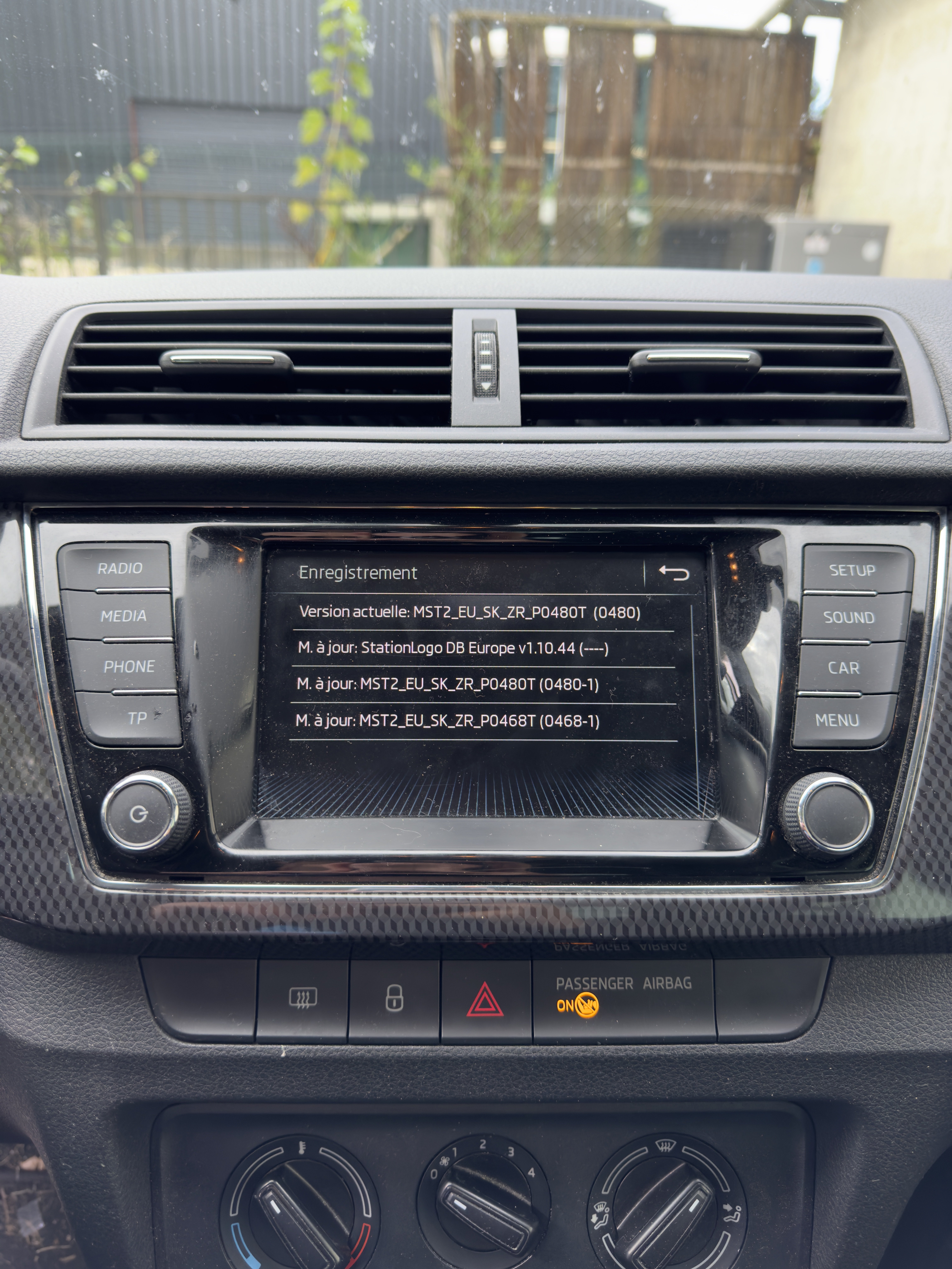

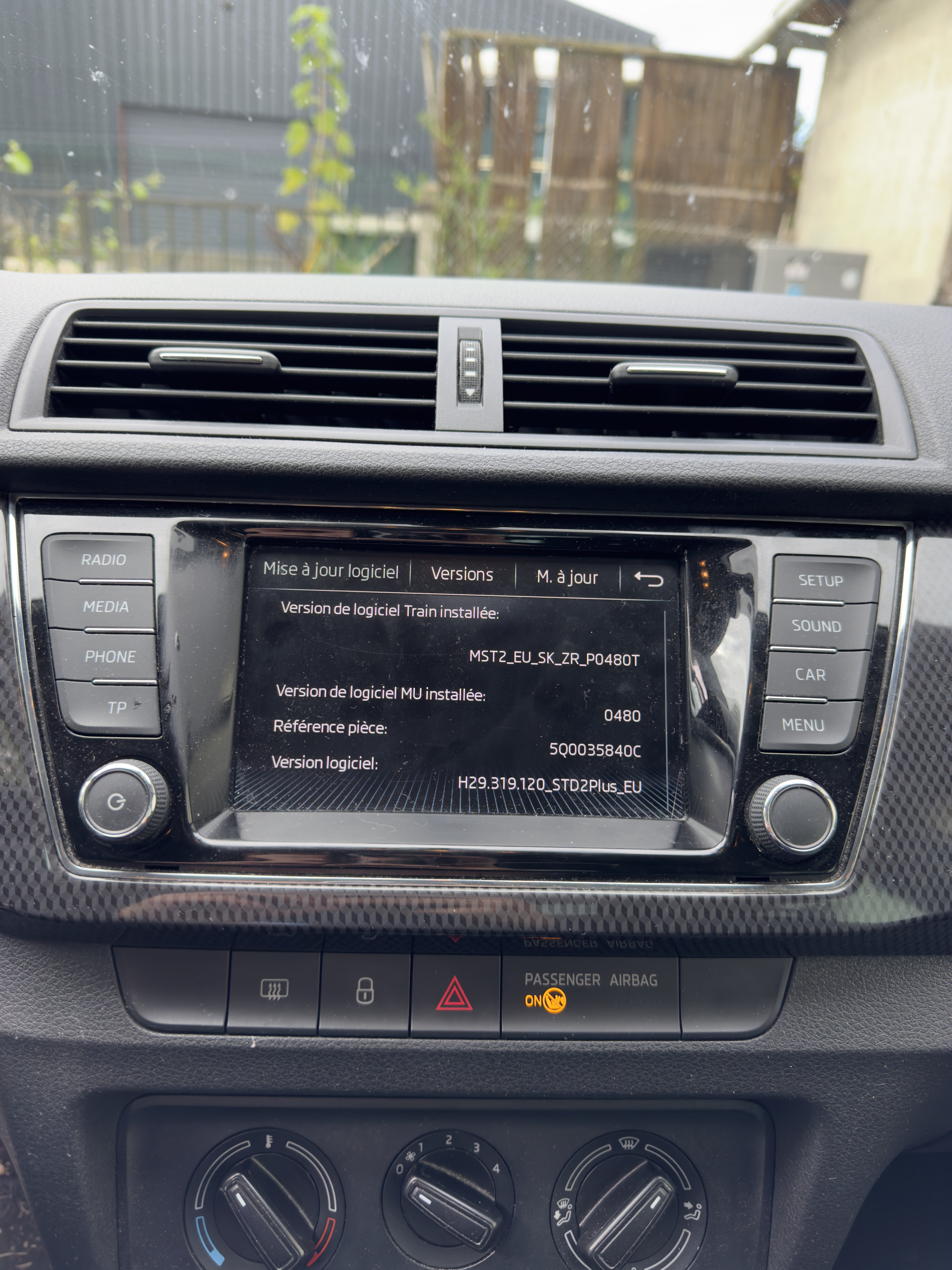

@pab567 Can you give me the latest update necessary for my MIB station ??
I also have problems with the 12V battery, where I get a message saying ‘12V battery almost empty, infotainment system shutting down’ or ‘12V battery almost empty, drive to recharge’. As a result, the start/stop system is not working and is buggy.
I checked the battery at the garage and at home with a multimeter to measure the alternator voltage, and everything is OK.
Some forums mention a problem with the infotainment system and say that it needs to be updated, and for some, the engine control unit needs to be replaced.
Can you send me the tutorial again so I can update it correctly?
You already have the latest firmware installed (0480).
I suggest you check your battery dynamically, with charging-dischargin cycle. It's very probable that one of cells is broken - I had the same recently in my car.

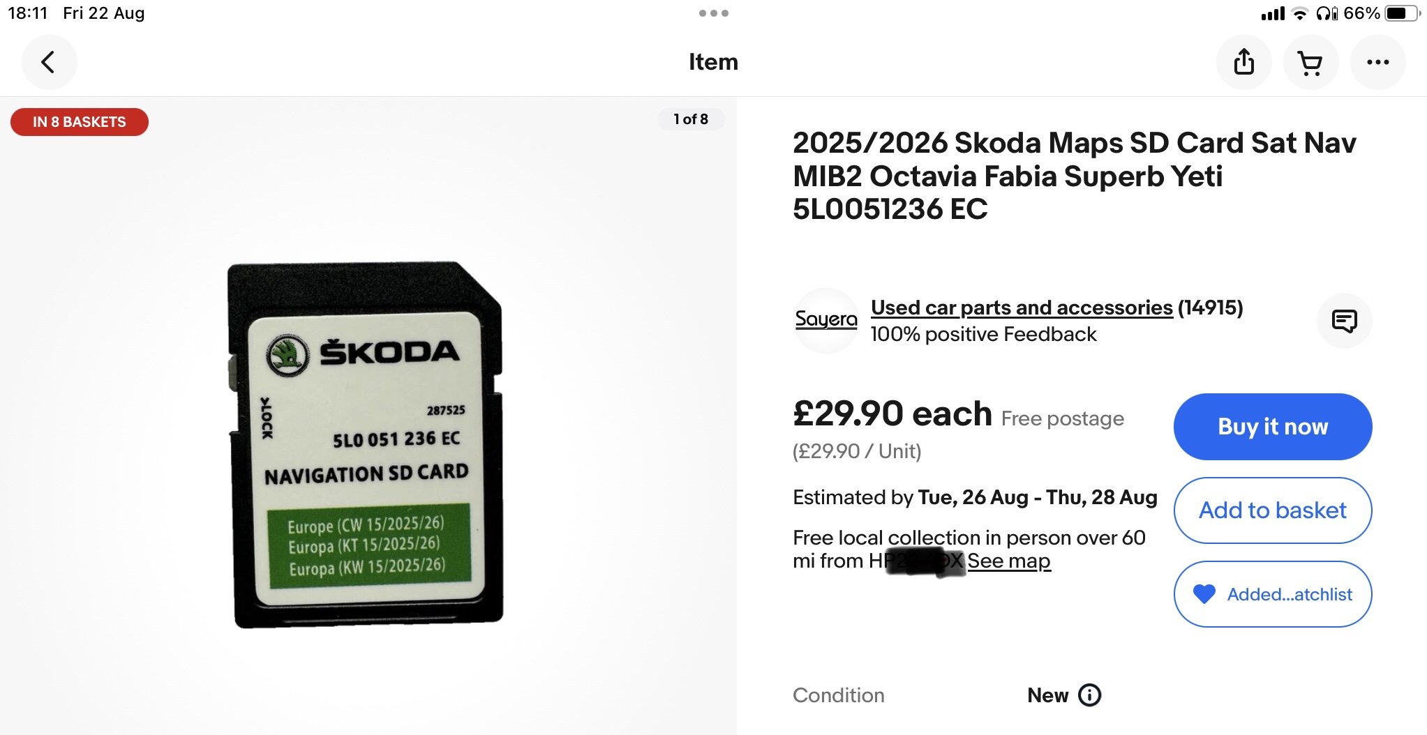

Reassurance please! The satnav in my 2018 Octavia 3 hasn’t ever been updated. I have added a screen shot of an eBay listing below for a replacement card. I have checked, and the part number of my unit is on the list quoted in the eBay listing, so it looks ok, I think. I understand not to buy a cheaply, but to get a Skoda version.
So, does this look OK? (no repercussions on any advice given, I assure you!) And if so, is it simply a case of old card out, new one in?
Thanks in advance
Malcolm
