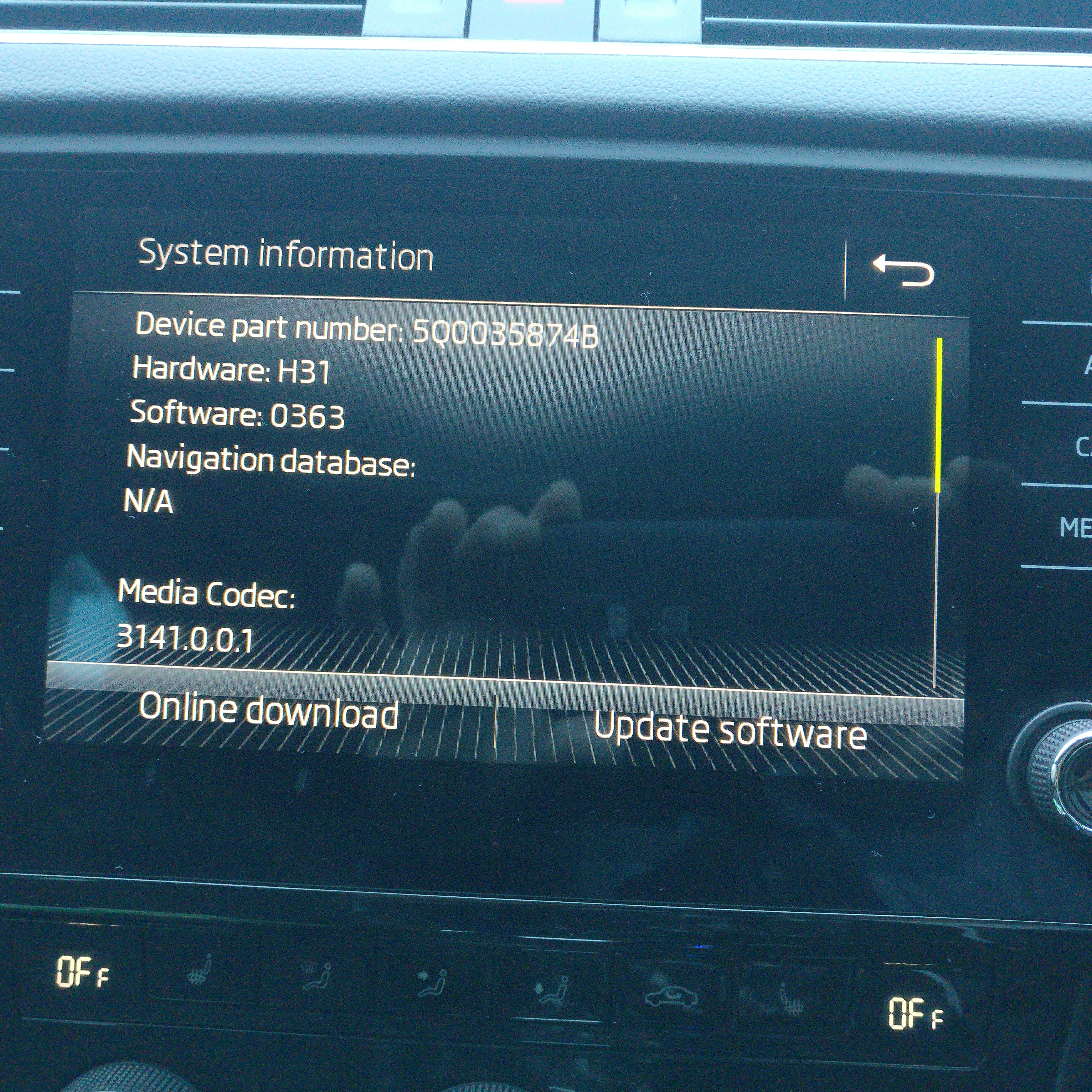

Device part number: 5Q0035874B
Hardware: H31
Software: 363
Appreciate any update on this one please. Thanks.

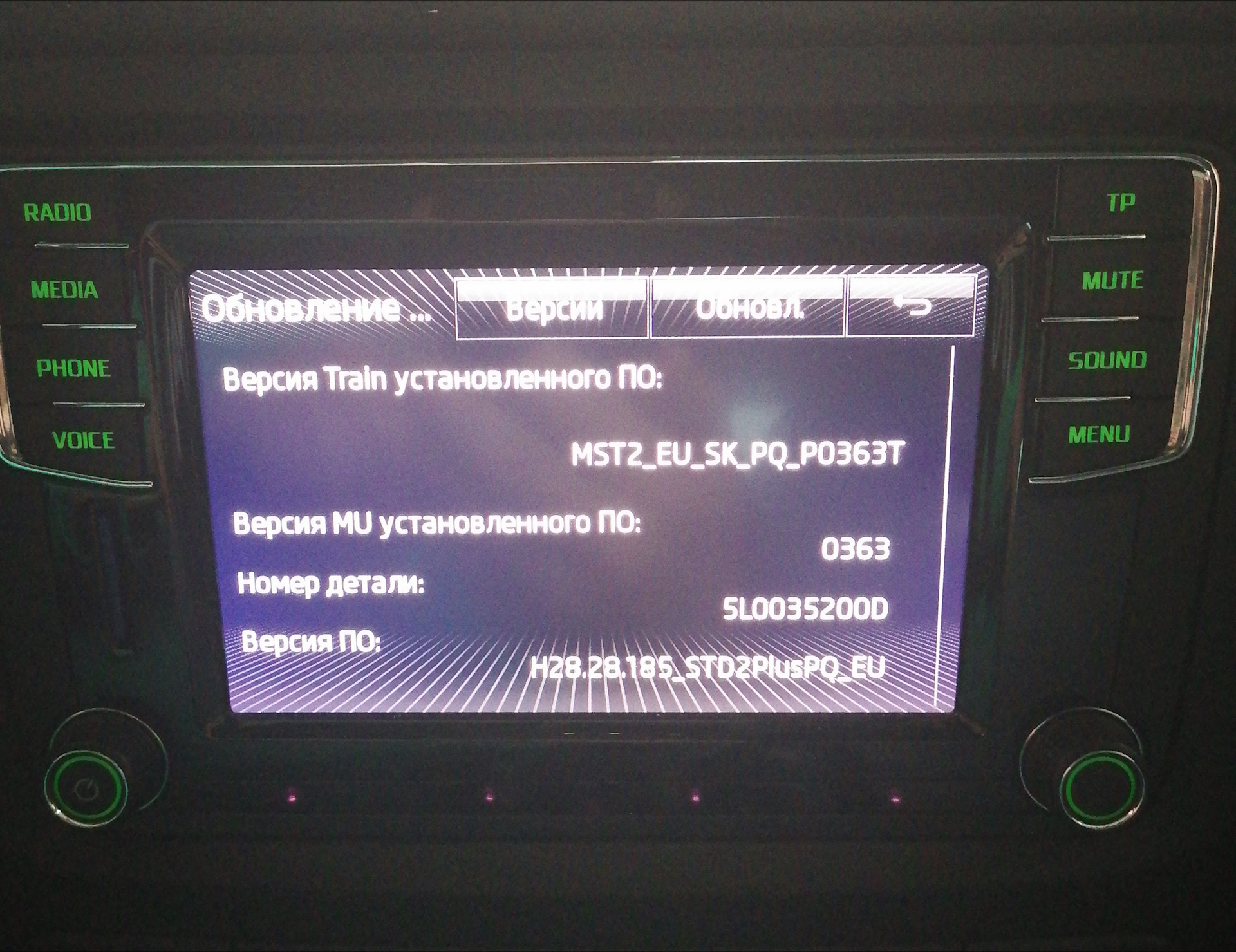

Hello! I have Bolero 5L0035200B on MST2_EU_SK_PQ_P0253T. Cp off, swap patch. But voice control is not active. I want to upgrade the firmware to 0363 or any other from Technisat HW3xx. Please help me with a link to firmware 0363.
Sorry for my english)
I'm looking for this firmware
help me please!

I saw 5L0035200B with firmware 03xx, incl. I think it is possible. You can try to go to 04xx, but I also cannot find MST2_EU_SK_PQ_P04xx in the public domain. If you have a SW for Technisat Composition Media HW3xx or HW4xx. I would be grateful if you could send me the link.
It is important to understand that we do not risk anything when we try to increase SW. If the transition is unsuccessful, the radio tape recorder will be restored to emergency mode.

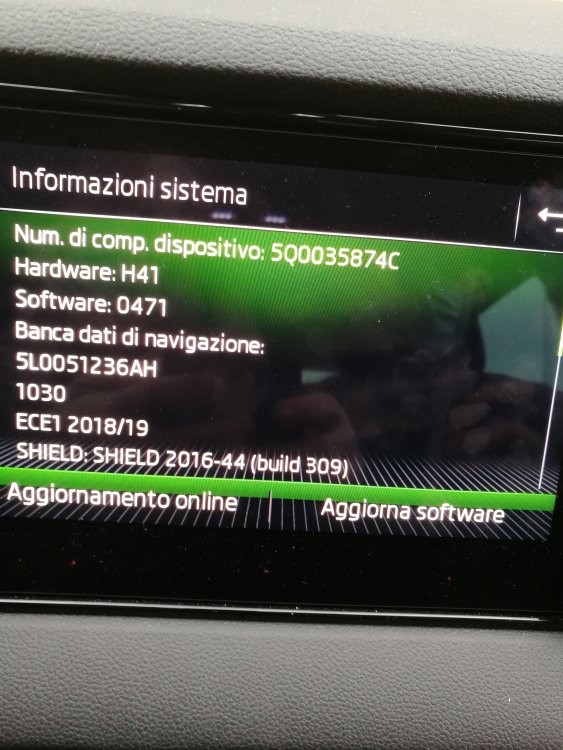

ciao a tutti
possiedo la skoda Karoq 1.0 TSI Style del 2018 e vorrei aggiornare il firmware dell' Amundsen.
Necessito del file per il mio apparato ed una guida per eseguire l'operazione.
Potete darmi indicazioni in merito?
Tradotto con google
Hi everyone
I own the 2018 Skoda Karoq 1.0 TSI Style and would like to update the Amundsen firmware.
I need the file for my device and a guide to perform the operation.
Can you give me information on this?
Translated with Google

It's NOT possible to upgrade from 02xx to any other than 02xx using regular update. To achieve it unit must be first hacked and then flashed using firmware with specially modified metainfo.txt. This is definitely NOT a piece of cake and I do not recommend to make it to anyone who is not fluent in QNX and does not understand what is the impact of changes he is doing.
Software 04xx for SKODA PQ does NOT exist at all.
I have NOWHERE found 03xx software update for SKODA PQ, if anyone has it pls contact me on PM.
