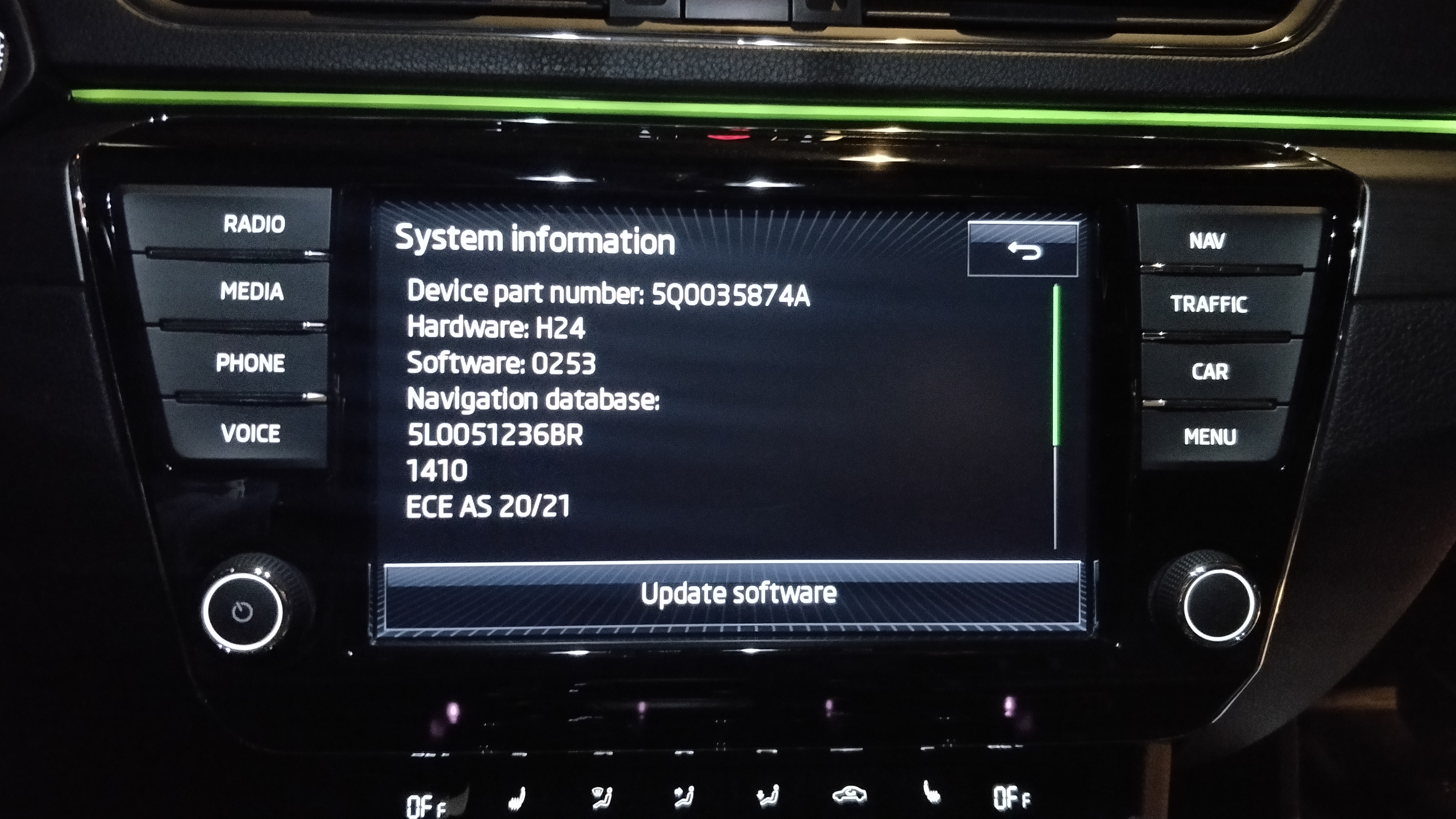

In your opinion, can this fix the problem that I have: TSR not working in fusion mode with 2021 maps database for Montenegro which is on the list of enabled regions for this option?

4 minutes ago, pab567 said:
Pls describe your problem in details.
I have an fabric trraffic sign recognition - option on my superb 2016 with amundsen mib 2 unit. With the newest maps for my region, it doesn't show street signs info in fusion with navi database, but only from the front camera in restricted mode, when the maps sim card is out!!! When I put the maps card in slot, somehow it blocks  the camera data to be shown as well with message: "no traffic signs in this area" or something like that. My country Montenegro, is on the list of supported countries for this option. If this is the official statement from Skoda I'm not sure why it doesn't work in Montenegro like in the rest of region like Croatia for exemple. Is there a way to fix this, other than turning off the fusion mode (btw. camera and database) using VCDS?
Thanks,
Dan
First of all, update your maps. Use VW portal select beetle then Discover media then choose required region (Montenegro is present in 3 of them).
So, as I understand the maps for vw and skoda are compatible, but the vw ones are more detailed as skoda uses vw maps to make her own. Hope this resolves the problem with data that I need for TSR.
Thanks, I'll try this and reply...
These are the same maps... there is no "Skoda" and "VW" and "SEAT" version, it's exactly the same set of files...

I already have installed the latest maps from skoda update portal for my vin. You think that reinstalling them from vw portal will make a difference?
As pab567 says the files are exactly the same, so there's nothing to be gained.
Maps you showed on picture (1410) are NOT the latest version - on th ewebsite I linked you will find 1520
