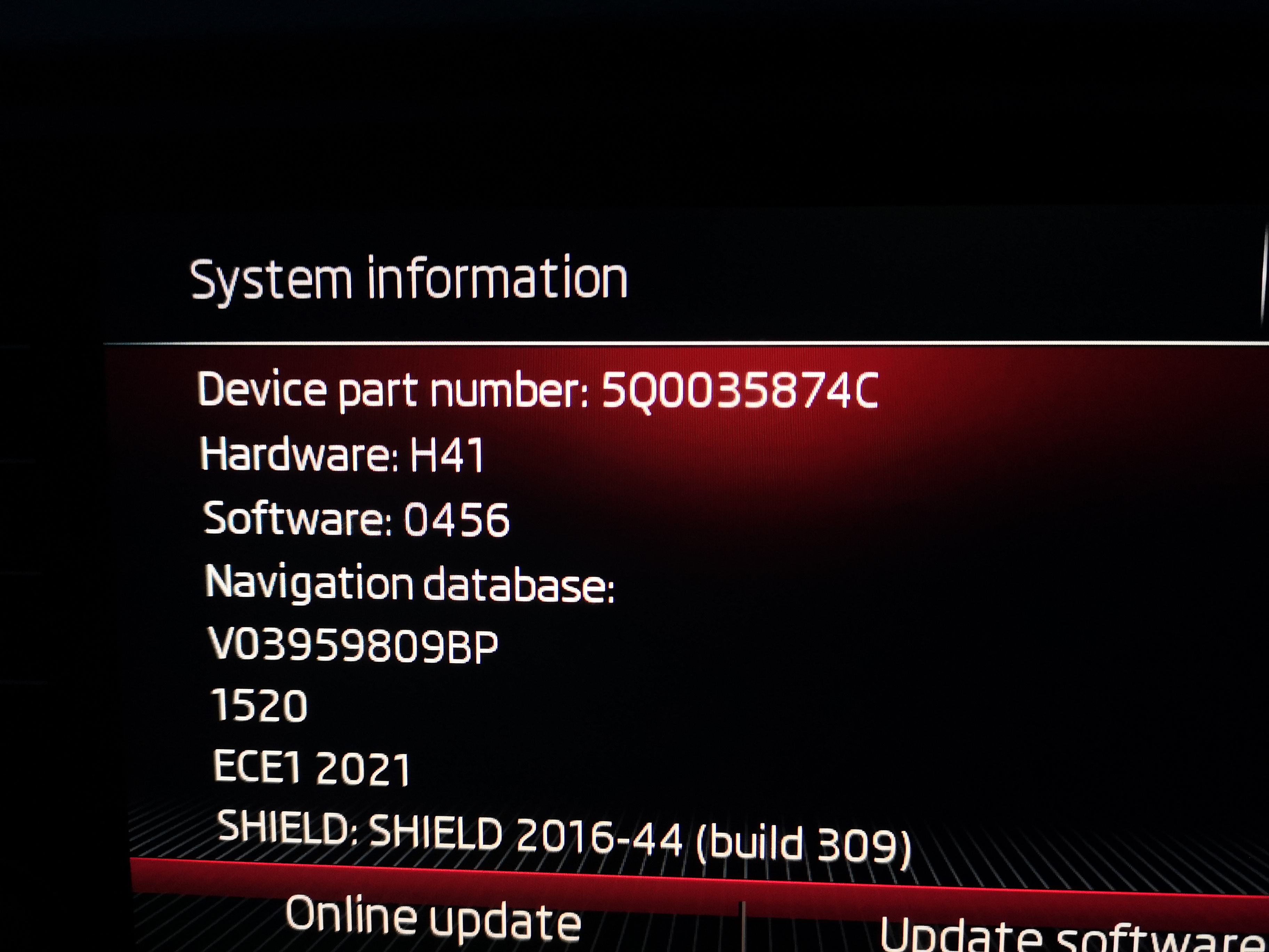

29 minutes ago, varaderoguy said:
Okay - that looks like an Amunsden system.  I think in theory you can go to 0478 (latest SOP-4 variant).  You also need new maps - you have the OEM 2018 maps.
thanks! i just got the car and ordered a fast 64gb sd card for the map update already. i will have a look at 0478, is it on the mega share? what folder?

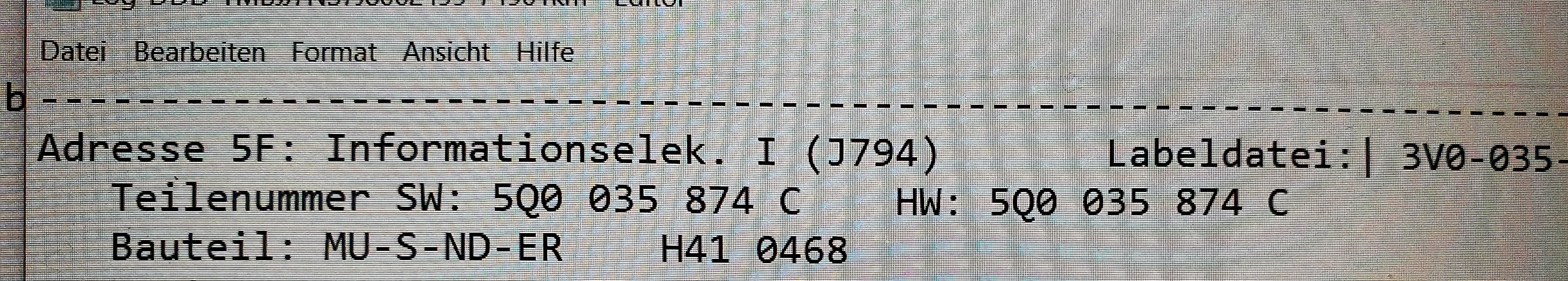

1 minute ago, langers2k said:
You have an Amundsen so you'll need an official Skoda SD card for the maps.
You can use any SD card for the firmware update though :)
Yes, generally, the SD Cards for the Maps come in 16G or 32G.  These needs to be Skoda/VW Discovery media cards.  They are about a £30 for a 32G SD card (will allow the full ECE A1 maps to be installed).
Hi Varaderoguy.
So my unit is a Admundsen 1?  The car is a Fabia III from 2018.
When i check the skoda update website and i enter my VIN, i can download the maps. and they guide me to ECE A1 filename: STD2_1410_EU_A1_202022.zip
This file seems to be for the MIB2, correct?
If they give me the map download... how am i suppost to update it? write it over the origional card?
Your picture shows a 5Q0 035 874 C, this is a MIB2/MIB2.5 Amundsen :)
You can get later maps from VW, it a Discover Media as fitted to a Golf from 2017. Current AS and EU1 map links below:
- https://navigation-maps.volkswagen.com/vw-maps/DiscoverMedia2_EU-AS_1520_V13.7z
- https://navigation-maps.volkswagen.com/vw-maps/DiscoverMedia2_EU1_1520_V13.7z
Yes.

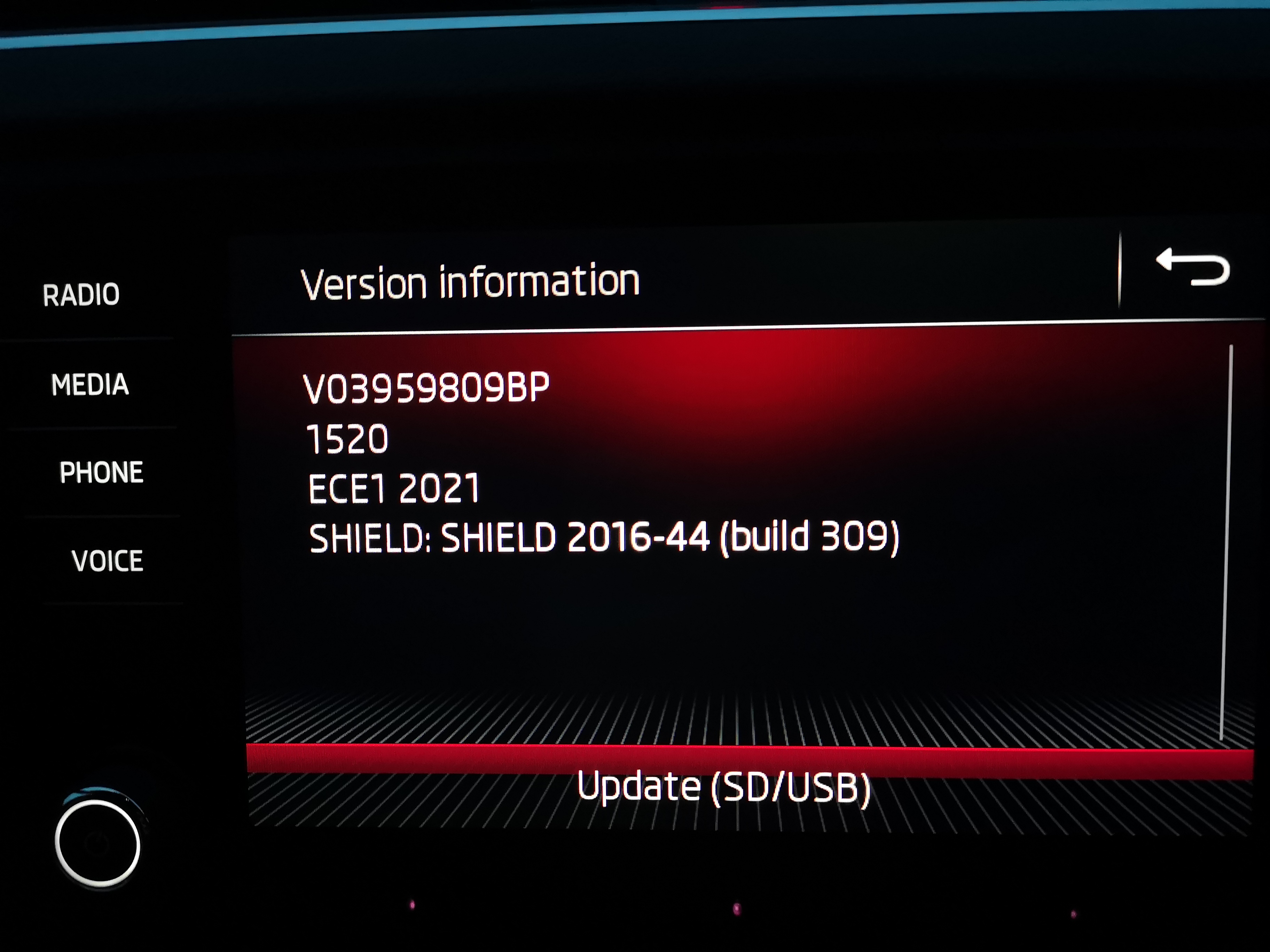

Amundsen it is!
p.s. i checked the PR code list...
Yes.
Overwriting now :) thanks!

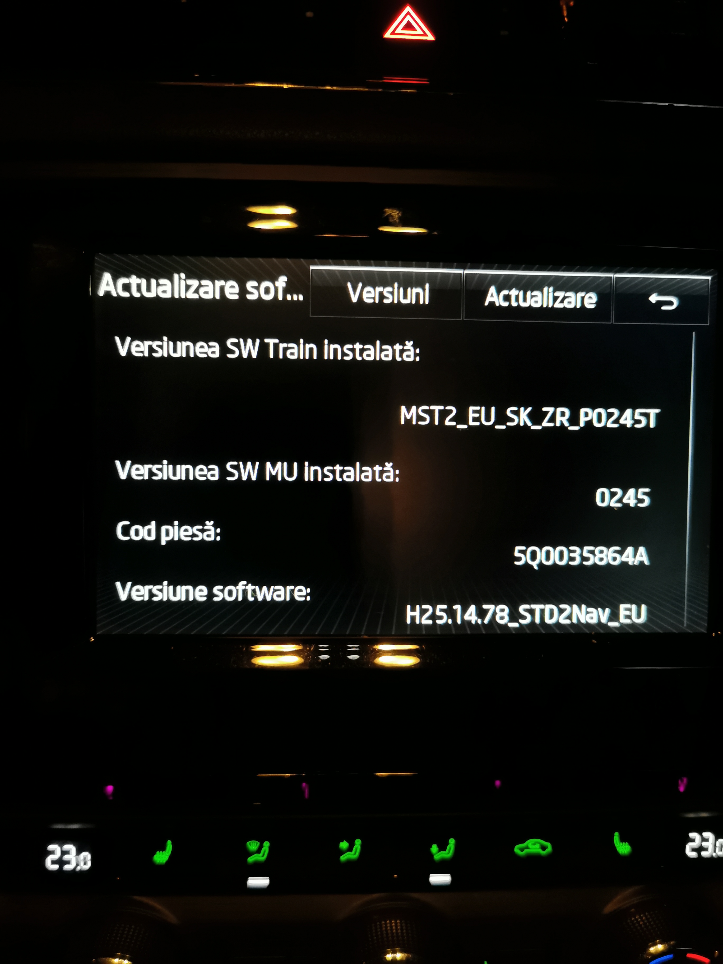

Greetings @pab567,
Could you please send me the link for the latest SW for MIB?
I'm having issued with reverse gear wich not put the unit in proper screen .I think it could fix that.
5Q0035864A
HW:H25
SW:0245
PM

1 minute ago, Funkenflug said:
For
Hi,

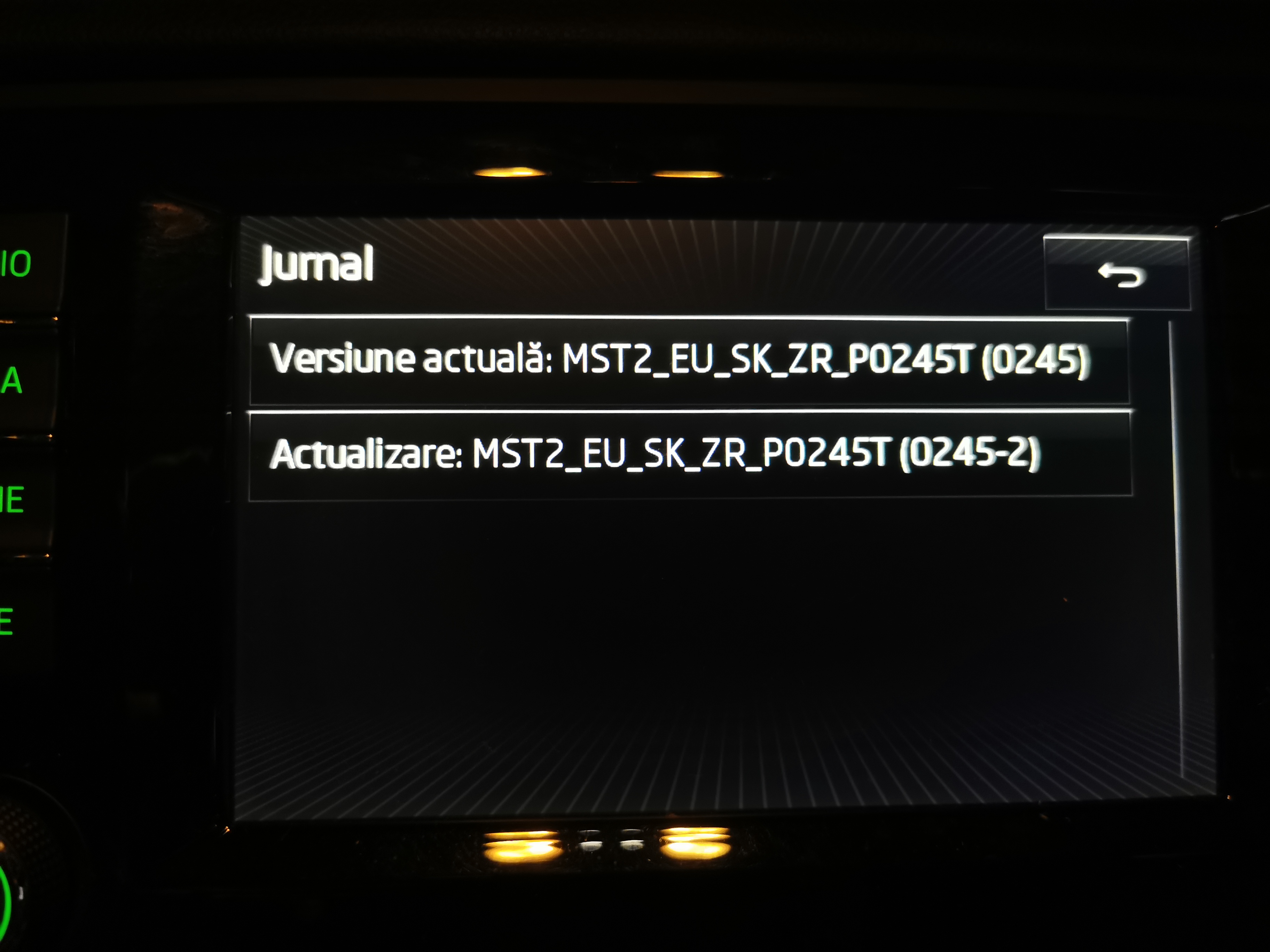

Do you know how much out of date is   Amundsen 5Q0035874A / Hardware : H25 / Software : 0245  ? I am trying to find a way to reconfigure the Traffic button to SmartLink and i found this topic.Since is working fine,its worth update it?
Thanks
It's impossible with this version of firmware 02XX.

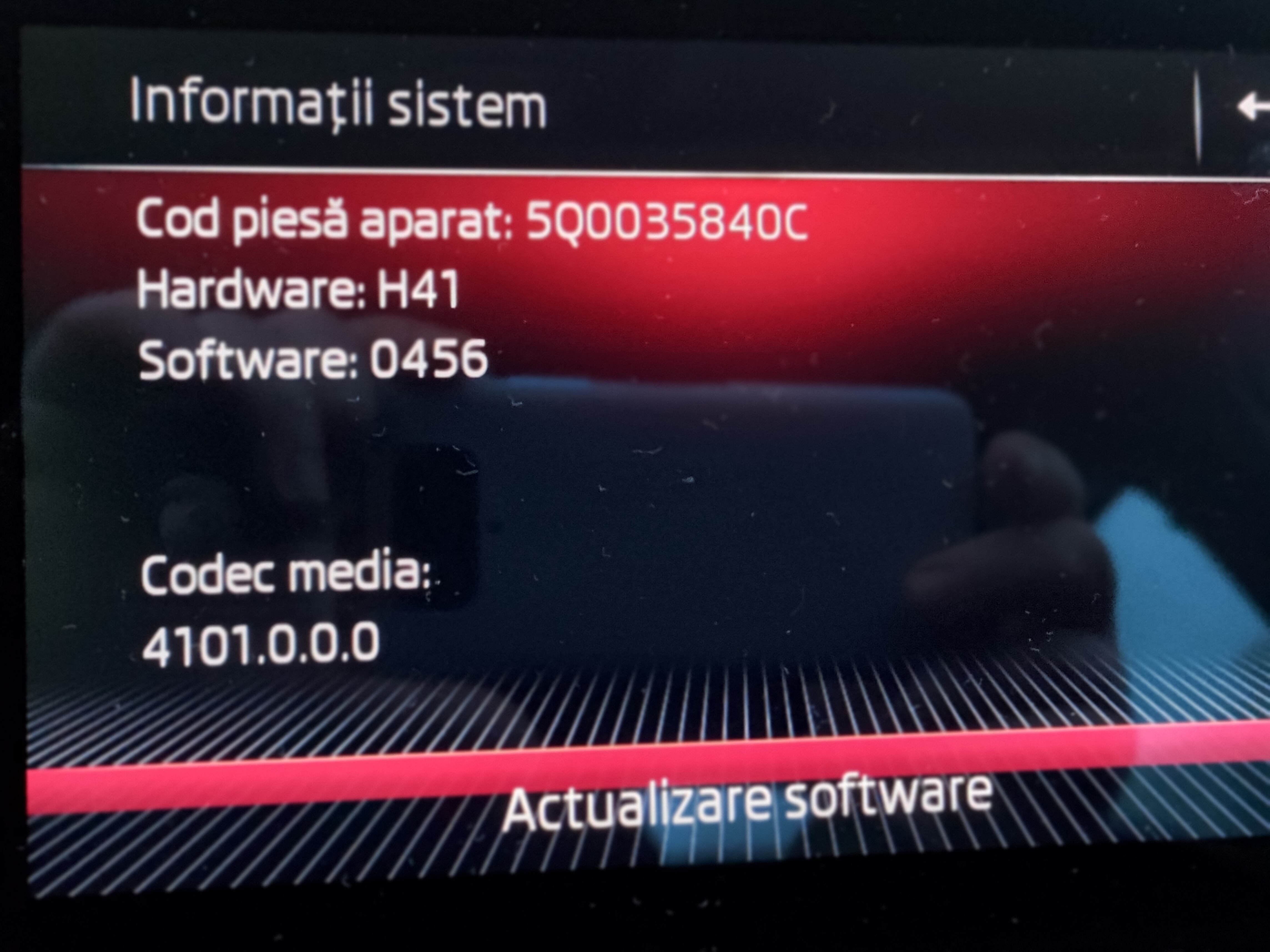

Hi @pab567
Do you have an update for below Amundsen unit
Nope, this is the most recent version I am aware of.
