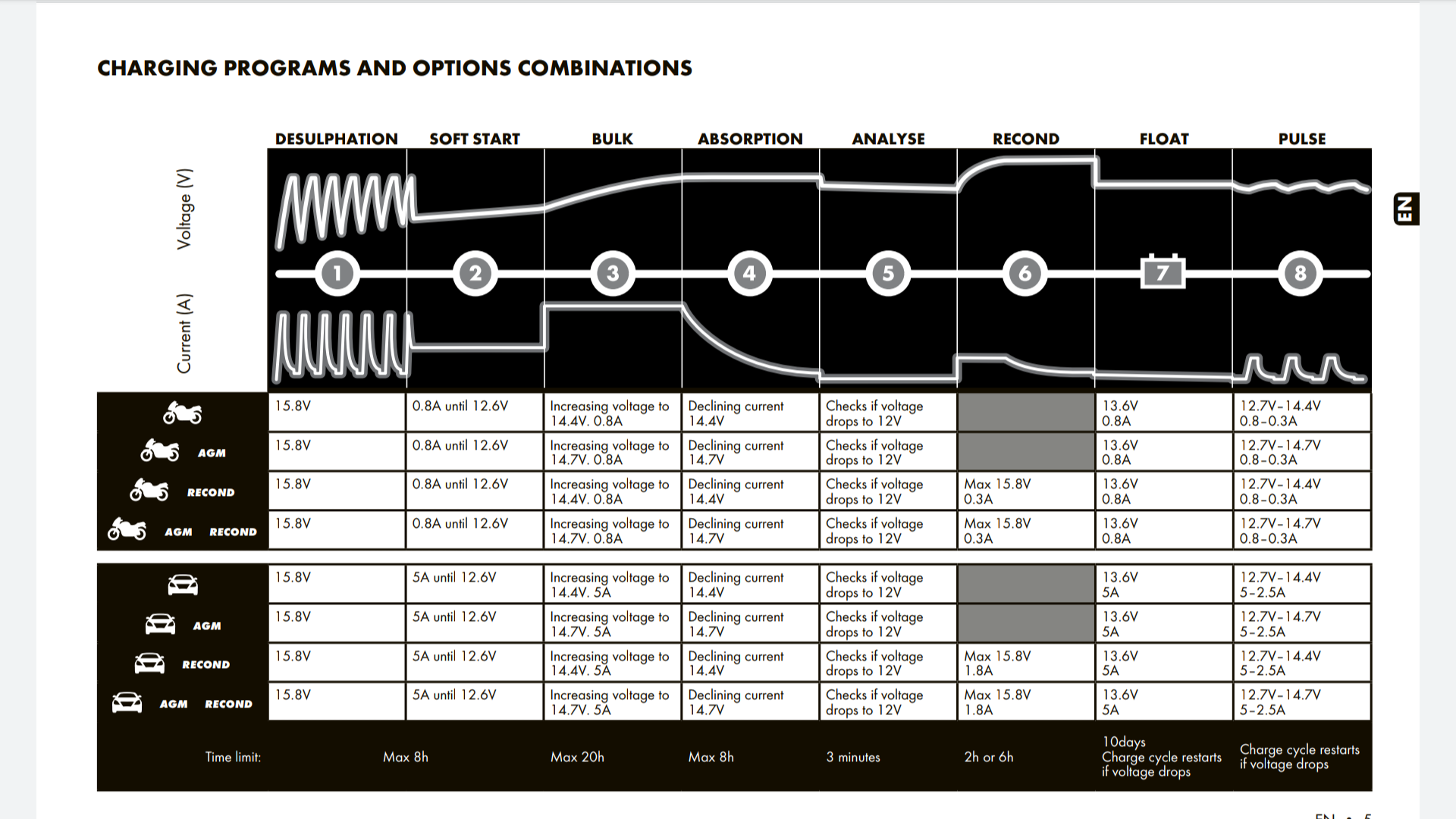

So I've read, however not according to the CTEC manual.
I got a ctec mxs 5.0 like many others have, as it's generally regarded as the go-to charger and is sold as an OEM ones for many cars.
However the charging profiles look like this.
The only difference I can see is that the AGM battery charges 0.3v higher, but with the same current.
Not saying the smart charger isn't worth it though as clearly it does have current control and a cycle.
