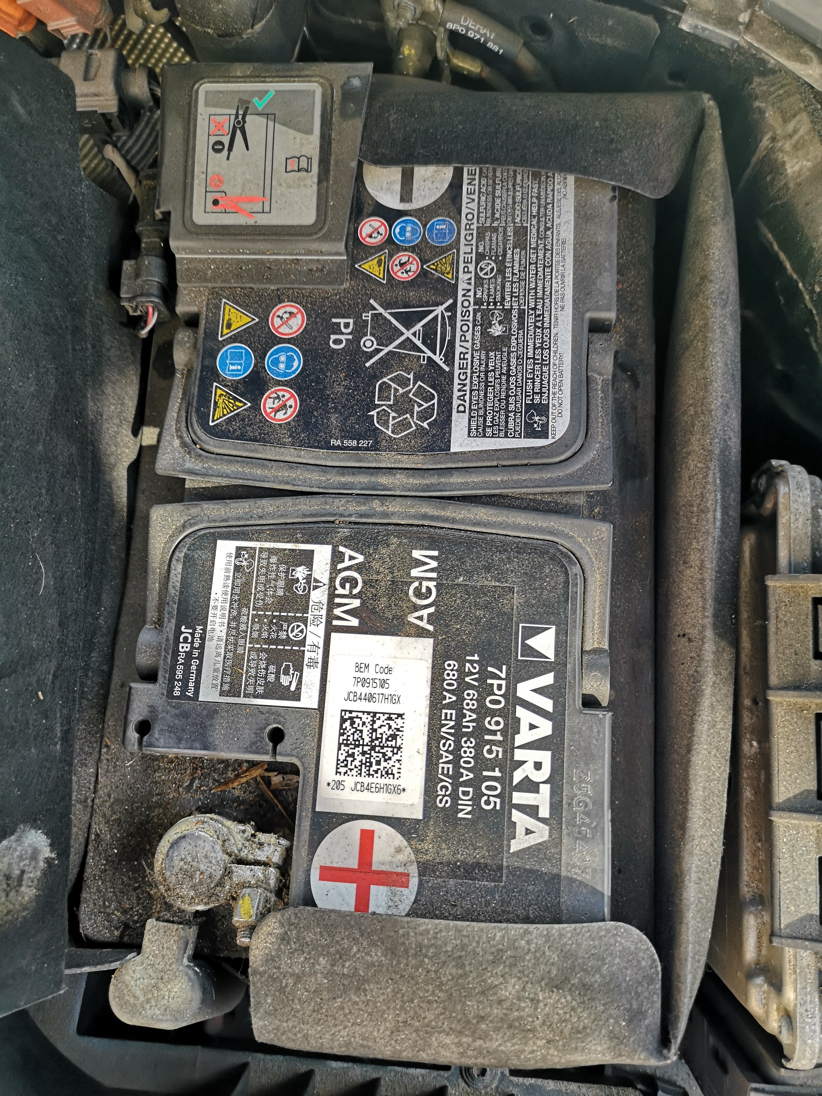

On 17/04/2020 at 10:11, Moosekat said:
Thanks for everything guys.
I think I am going to get the Varta from Tayna, which looks great. My only issue is reprogramming my Octavia for the new battery. Does not seem to be anyone near me (Maidstone) with VCDS.  Anyway I have a pic of the battery in my car at the moment to make sure I am replacing it with the right one.
What are the downsides of not reprogramming the car when installing a new battery??
I installed mine in my '63 Octavia vRS in July '19.
(E39 Varta Start-Stop Plus 096 AGM Car Battery 12V 70Ah (570901076) £140 Inc VAT delivered from Tayna)
No recoding or VCDS editing done. Zero issues with the electrical system.
