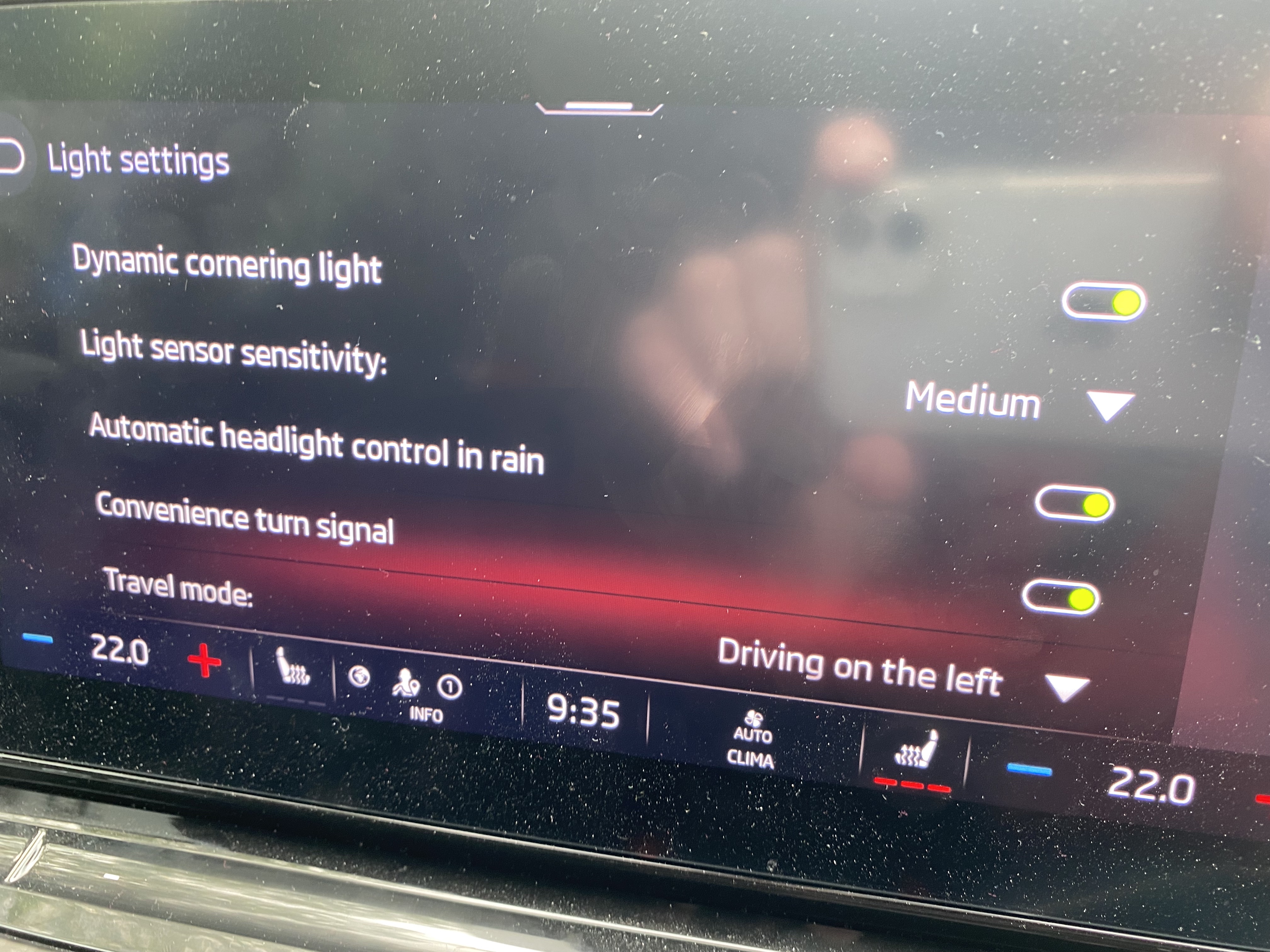

Out of interest where in the myriad of menus did you find that setting?  I've got the PDF manual but short of scanning through the whole thing and having no lock with a word search I would be grateful for a nudge in the right direction...
 Yes I find the PDF manual fails to explain a lot of things.  This setting is in the “Vehicle” app, under “headlights”.

I have this issue too but only intermittently.  For example, yesterday I drove down the M3 from Basingstoke to Southampton and back during the day in fairly light traffic.  All the way there ACC worked perfectly, frequently passing slower vehicles in the lane to my left, but on the way back it kept slowing down because of them.
I had been wondering for some time if the radar was misaligned or had two wide a view ahead, but then I noticed for the first time that in these situations the lane assist display actually showed a white car in the neighbouring lane - as someone else has explained above.  So, my car knew that the car it was slowing down for was in the lane to my left, so had no excuse for slowing down.
When I got home I looked around various settings and found that the car was incorrectly set for “Driving on the right”.  If the car thinks I should be driving on the right, then it would correctly prevent me overtaking a car to my left.  But the mystery then would be why it often does allow this.  I’ve changed this setting to “Driving on the left” but haven’t had an opportunity to test it so far.
i'm wondering if this setting also explains why I have been finding I get flashed when using the matrix headlights on rural A roads?
It will take me a while to know whether this change has helped with these two problems but I will report my findings when I’m confident it’s made a difference - or not.

... I found that it had set itself back to “Driving on the right” and wouldn’t let me change it.  I wonder if it’s badly worded (in translation from the German or Czech) and actually means “Right hand drive”, in which case it is correct after all. If so, possibly it sets this based on its knowledge of the driving rules in the country the car is in, in which case it's right that it wouldn't let me change this setting.

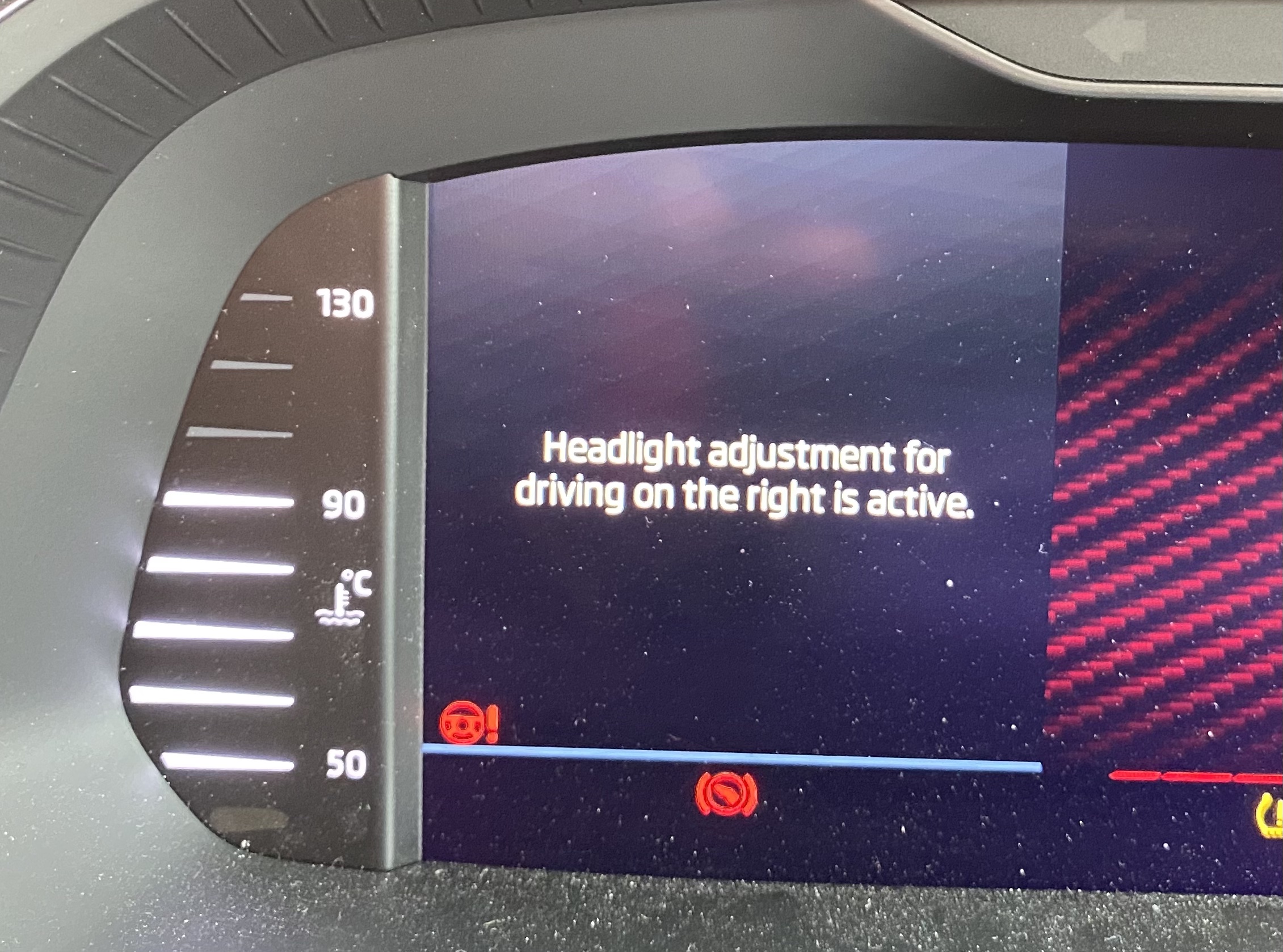

This is the bit that is really strange...
When I started the car this morning, I checked the "Driving on the right" setting and found that it had changed to "Driving on the left" (see attached image).  I hadn't changed it and, as before, it wouldn't let me change it back to "Driving on the right", even if I'd wanted to - I still don't know which is right.  It remained on "Driving on the left" all the way there and all the way back.  My conclusion is that this setting has no effect on the behaviour of ACC and probably only affects the headlights (which is reasonable as the setting is in the "Headlights" section of the settings).
Also, today, both times I started the car, I saw a message in the left dial on the instrument panel, which I've also shown in an attached image.  This message said that the headlights were set for driving on the right.  I don't think I've ever seen this message before.  It's also odd, as the Infotainment screen insisted that the headlights were set for "Driving on the left".
I'm really not sure what to make of all this, other than that the whole system is badly messed up.

With thanks to alancha I have found the setting and changed my setting to read driving on the left and so far.......on the 2 journeys that I have made along the M9 here in Scotland it has worked!!!  Not once did it hesitate....so progress indeed.
For the information of MCG1975 if you go to car exterier or external and select mirrors if memory serves me right it is the last option.  You have to be static though as it will not allow you to make a change whilst the vehicle is in motion.
