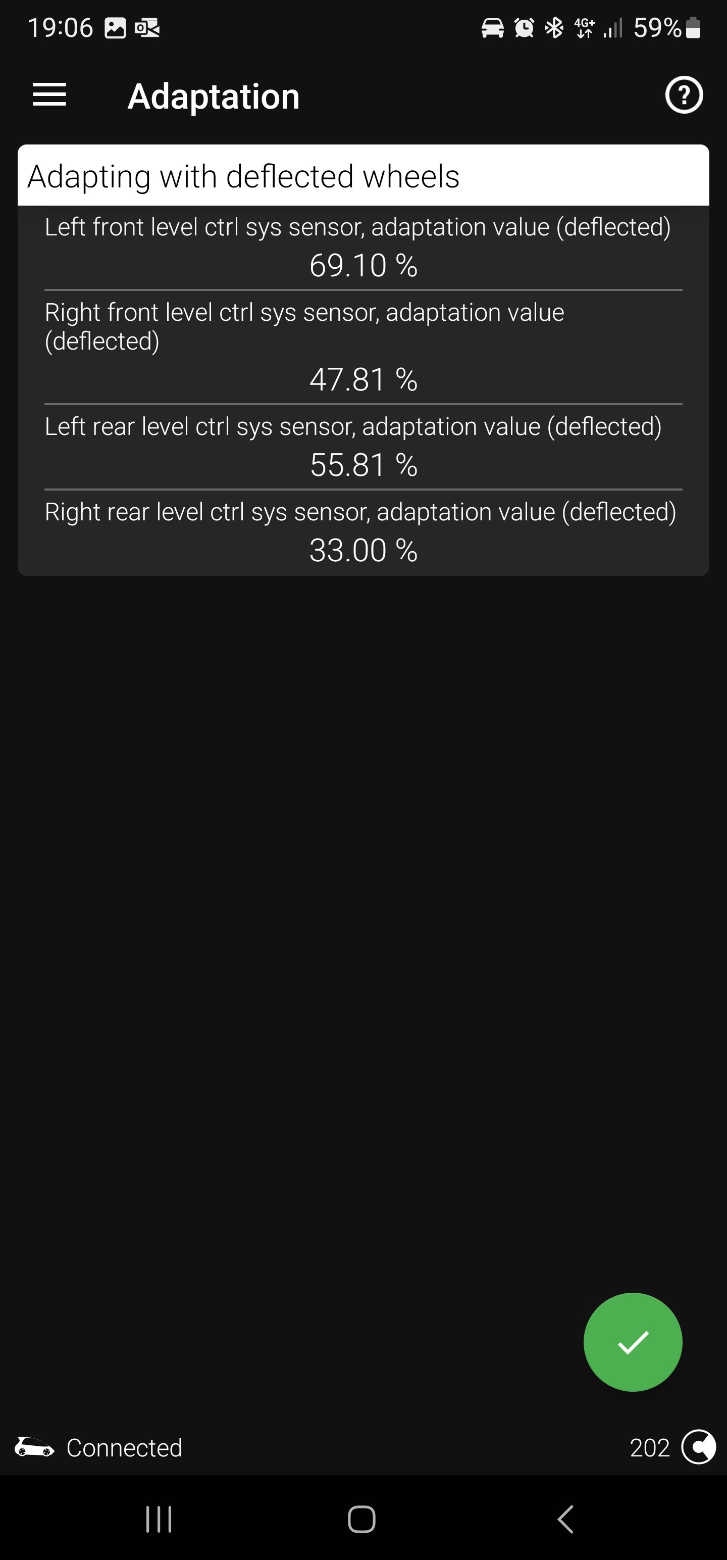

Wow, I'm idiot! Thank you !
Just FYI, before and after - used Monroe front replacement stock
image.png.ec3ffca5766f0e372fe01a548b15f734.png image.png.8ecaa208b53b5b282927e4a88687195e.png
Yes the values will change always, even if small difference the suspension work will improve after calibration, as you may know there's no two equal resistances from manufacture you always have a x% tolerance.
Did you replaced coil springs together with mounting kits ?
- If so, and if you have possibility, repeat the procedure after 300-500km, assuming new parts (coils/rubbers) will fit on place it may change a bit couple mm.. - "but it's not mandatory"

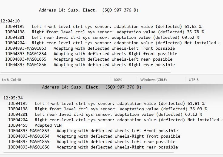

I've just done this in vcds after replacing the rear springs. Not a huge difference in the numbers or the drive ('normal' setting still feels underdamped).
At least I know it's set up correctly.

Does it not measure Rear Right deviation? I notice on your results it says not installed.
The rear only has one sensor, unlike the front which has 2x sensors (one for each axle).
Hence a total of 3x sensors if u have DCC.
