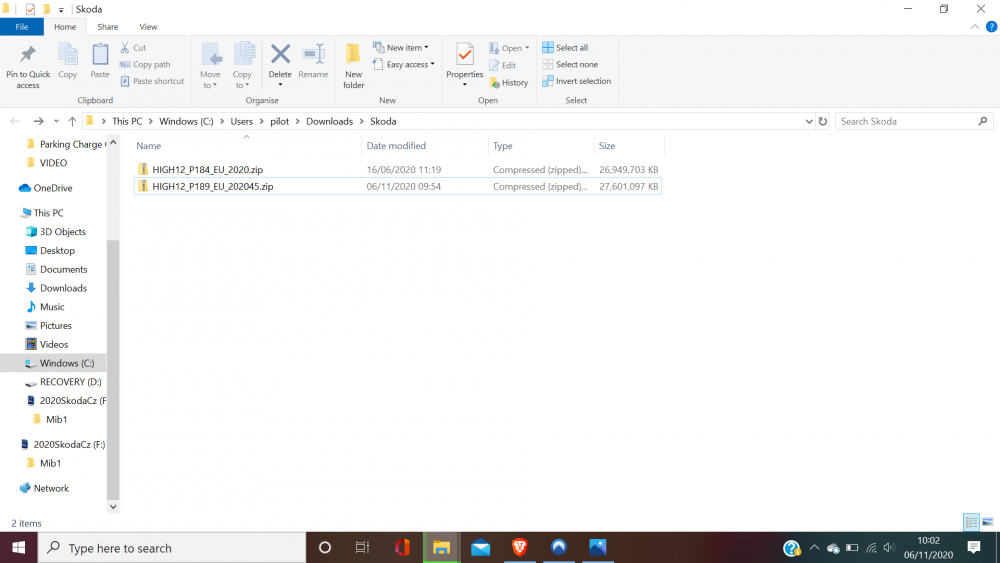

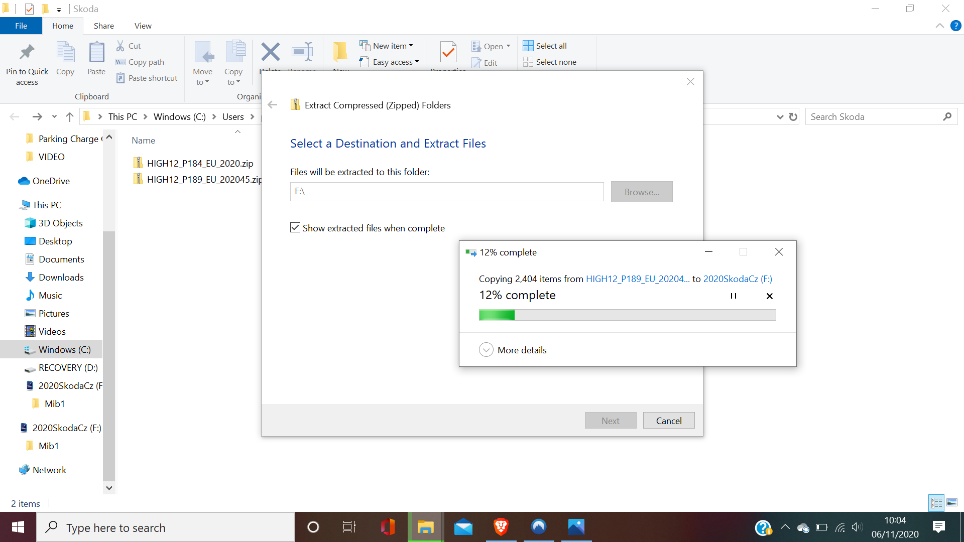

  • A minor point but unlike the 2020/2021 update, this one won't quite fit on a freshly-formatted 32GB NTFS card (so don't waste 20 minutes or so unzipping it until it fails at 99%). No problem unzi
No problem unzipping / installing when reformatted FAT32. (I'm not sure why some Youtube videos recommend NTFS, though that worked last time for me).

I've just downloaded this and tried copying it to a freshly formatted FAT32 32GB USB Stick but getting "Not enough Space"
Any ideas?
This is what my 32GB card looks like after unzipping:
Cheers. Looks like my 32GB stick is formatting to 28.6GB!

You are copying the extracted files aren't you?
Reformat it to FAT32 but select the option to make the cluster size 4KB instead of default - that will stop the many small files wasting so much space.
