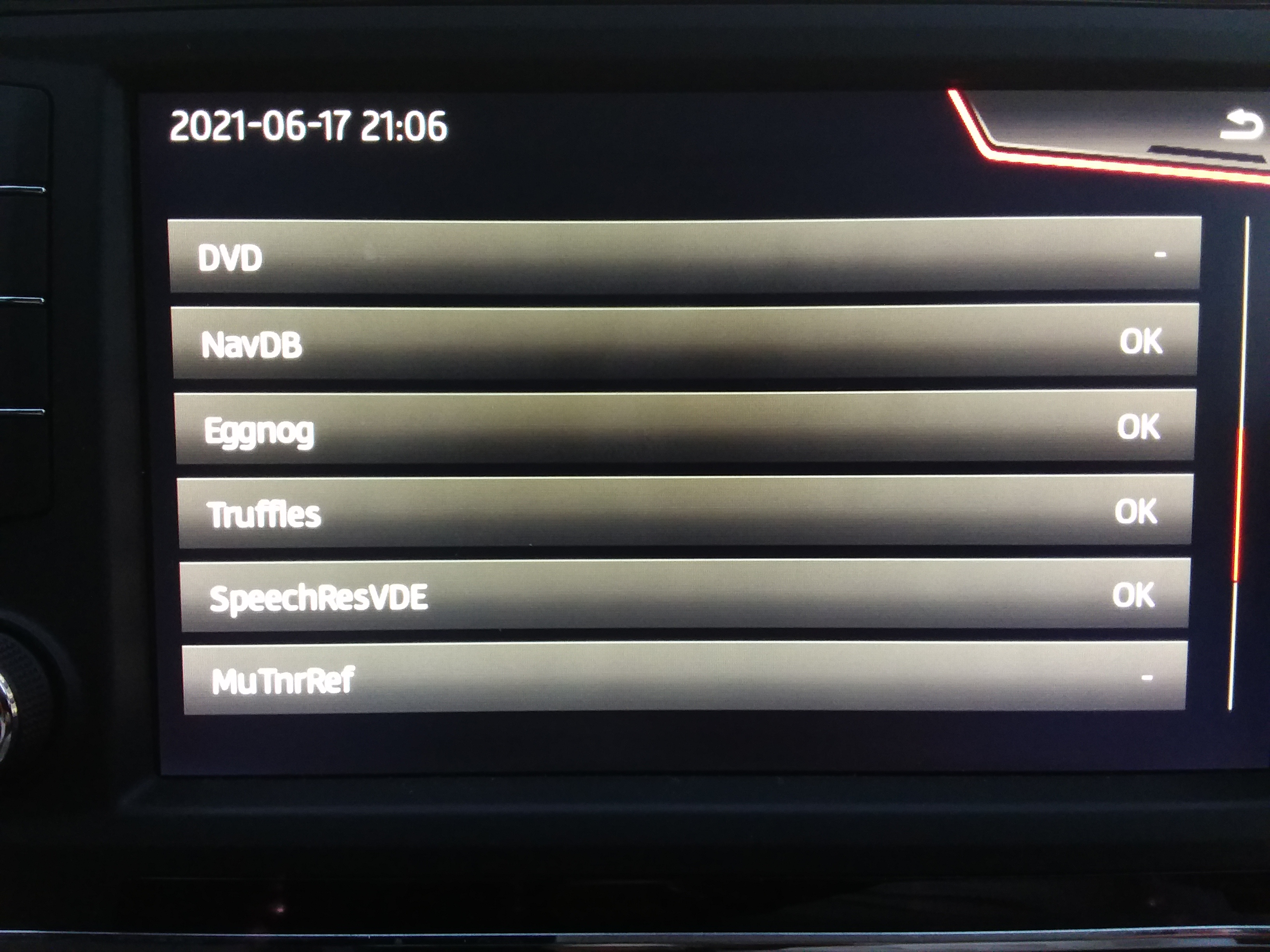

I prefer to see the process, countries, Eggnogs and the like.Β
Suspect newer units have faster processors in them so the 2016 mib2 high is beaten by those that came along later why they get the job done quicker. Use to be over an hour in background mode.
Β
You see the final screen in the developers menu and know job done πŸ˜‚. Those comforting OKs. Now an honorary Skoda navigation lifetime FeC Seat 🀣.
