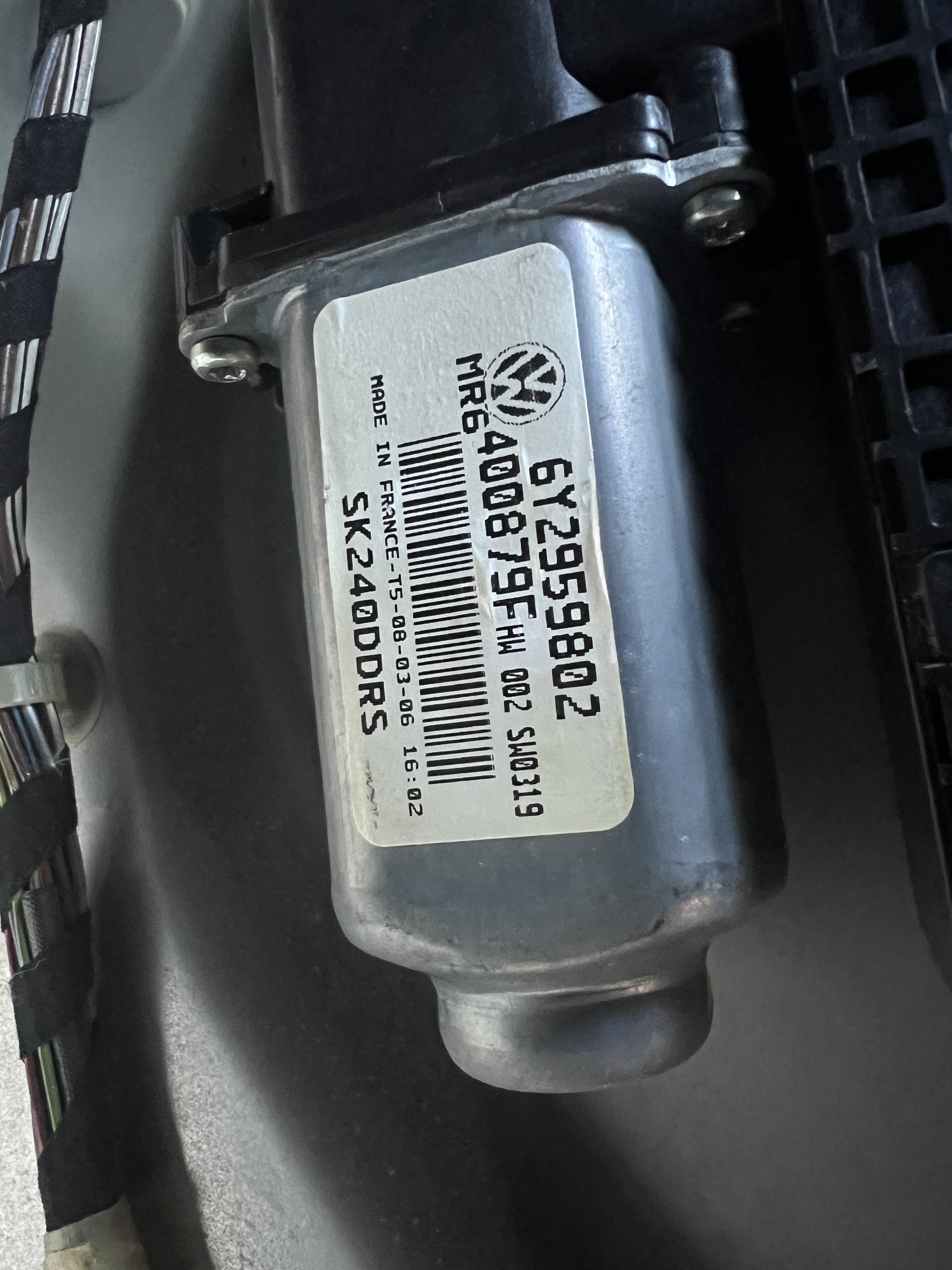

Hi,
Im hoping you can help in anyway at all.
My daughter started learning to drive last summer (2023) so I brought her a car. A 2006 Skoda Fabia ….
FABIA HATCHBACK - 1.4 16V Elegance 5dr Auto 75hp
(She passed her test in January 🎉 - no more a mum taxi!)
The car was all working fine in the first few months of getting it…. And then the winter weather hit! Major damp issues in the back footwells (which my brother has now fixed 🤞) , and the electric windows have stopped working. My brother is fairly good with cars etc, he tested the volts in the motor etc and it was all still ‘live’ but nothing he has tried (fuses etc) has fixed the issue.
when my daughter got home yesterday she said it was so hot in her car and it was not great that she couldn’t open the windows…. and we aren’t even into the hotter weather yet.
Will you be able to help in anyway? I’m (we’re) desperate.
I forgot to say, we have tried a new motor with module ( 6Y2959802 - SK240DDRS) that didn’t make a difference.

Hello Rachel, I'd be glad to try to help. I'll send you a Private Message in a few minutes.

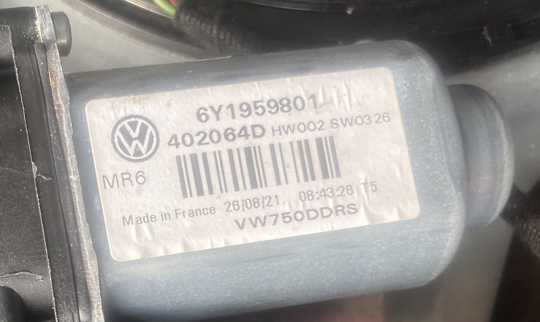

I need your help if you’re still offering this service for my T5? I replaced this 2 years ago with a brand new part from VW and it’s broken again,  I may have the old one kicking around if you needed stock. It’s VW705DDRS. I hope you can help me!
Edited by MichaelVWT5
  • Sponsor
Hello Michael, thanks for getting in touch. I'll be glad to help with this, and will send you a Private Message in a minute. 👍

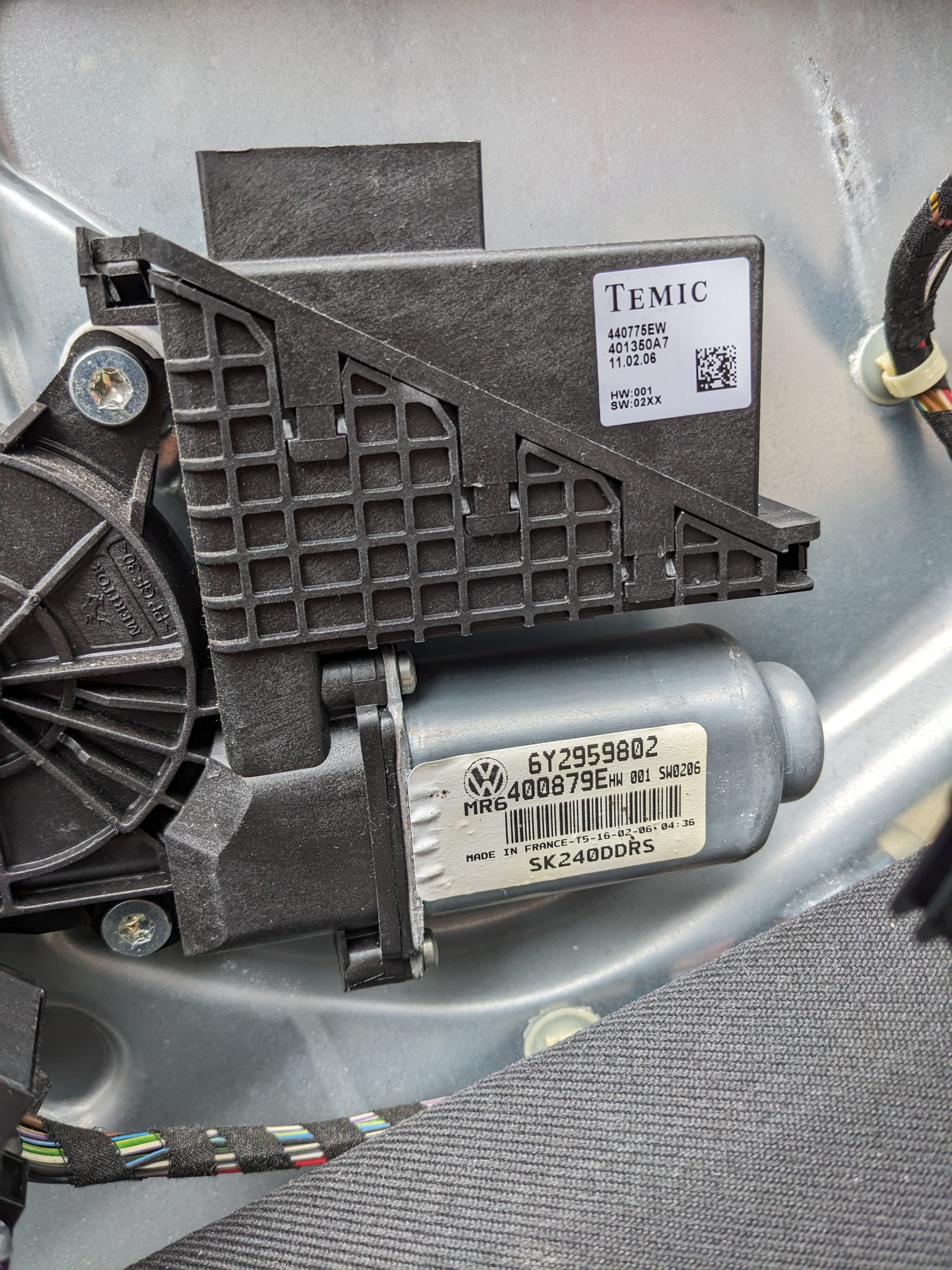

im looking for a repair on my window motor… 6y2959802. Please can you let me know where I can post and pay etc.
thanks Mike
  • Sponsor
Hello Mike, yes of course.
I will reply to your private message shortly,  just got to do the washing up first. 😆

Hi Pete,
I'm looking to repair the window motor for my T5 transporter, the part number is 6Y1959801. Please let me know if you are able to help?
Best Wishes
Mark
  • Sponsor
Hello Mark, I'll be glad to help.  I'll send you a private message in a sec, with a contact number for whatsapp etc.

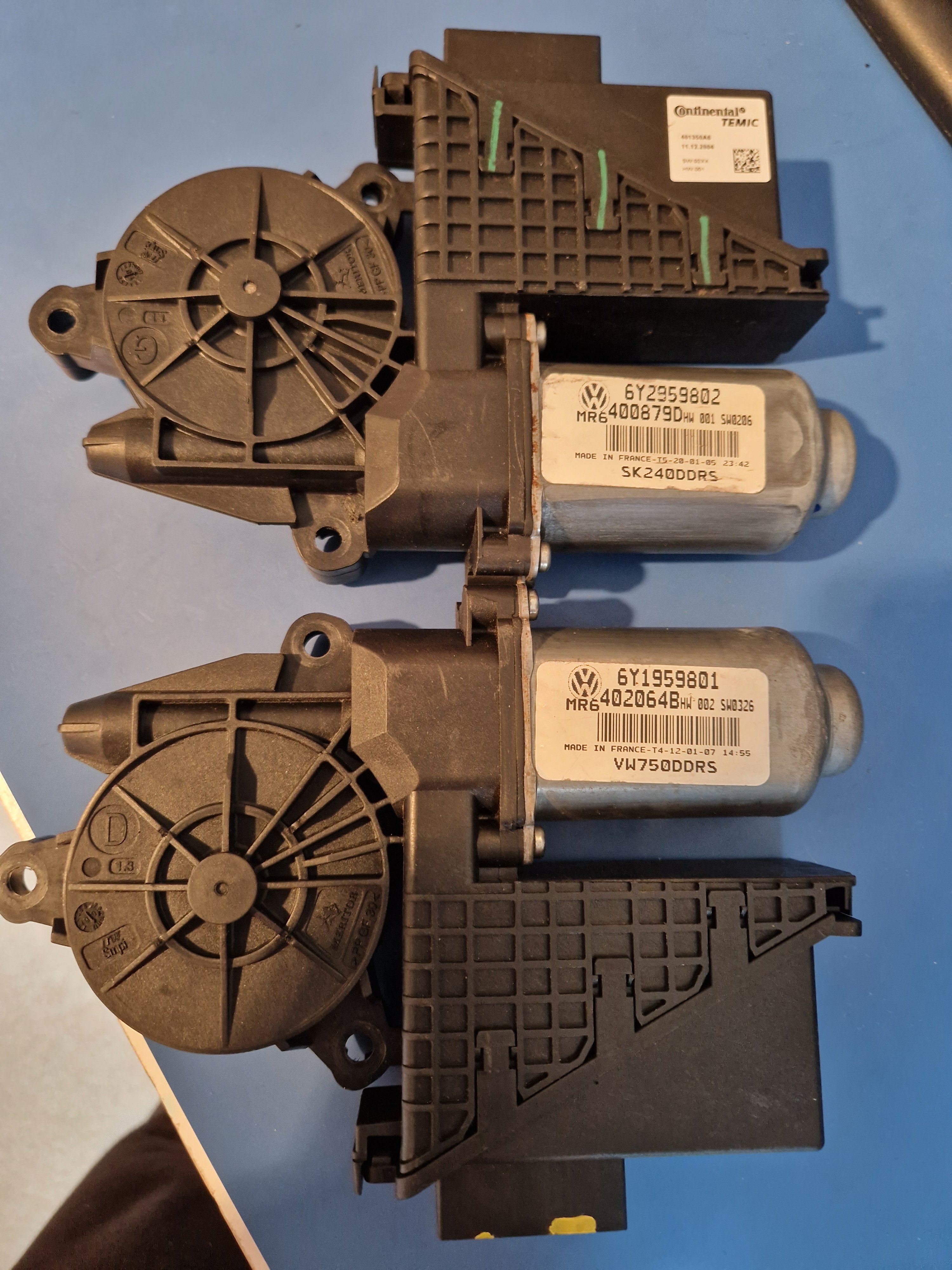

Can anybody confirm if the window motor module from a 4 door Ibiza/Polo (6Y1959801 i think?) with two front electric windows and two manual rear windows, will work on my Fabia with the same two front electric two rear manual windows. Part number for my Fabia is 6Y2959802
  • Sponsor
Hello @Gondard, no that won't fit, it's a mirror image of 6Y2959802,  look at online pics of the two.
You need an exact match to that part number, for it to fit and work correctly in mk1 Fabia. In addition, the bottom line of the part number label, SK240DDRS, needs to be matched for a RHD mk1.

Hi Breezy_Pete, thanks for the response.
Could installing it anyway not work? I'm sure that the wires will reach for the connectors to fit in.
I'm sure the rotation direction of the motor output sprocket will be the same for Fabia and polo too?
Would there be another reason why it would not work?
  • Sponsor
You won't be able to physically mount  6Y1959801 from a RHD car on a RHD mk1 Fabia.
Only thing you could try is to transplant the circuit board across into the 6Y2959802.
Not at all sure that rotation directions will be correct if you do though, but that can be changed by rotating the motor housing 180 relative to the brush-holder (circuitboard out first to avoid damage).

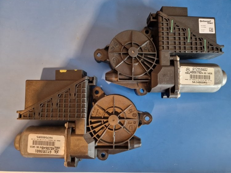

Pic of 6Y2959802 from mk1 Fabia above a 6Y1959801 from a T5. (Both RHD):
The mounting orientation is different between mk1 Fabia and all others, so the handedness is opposite.
This shot shows approx orientation when mounted on door in each:
