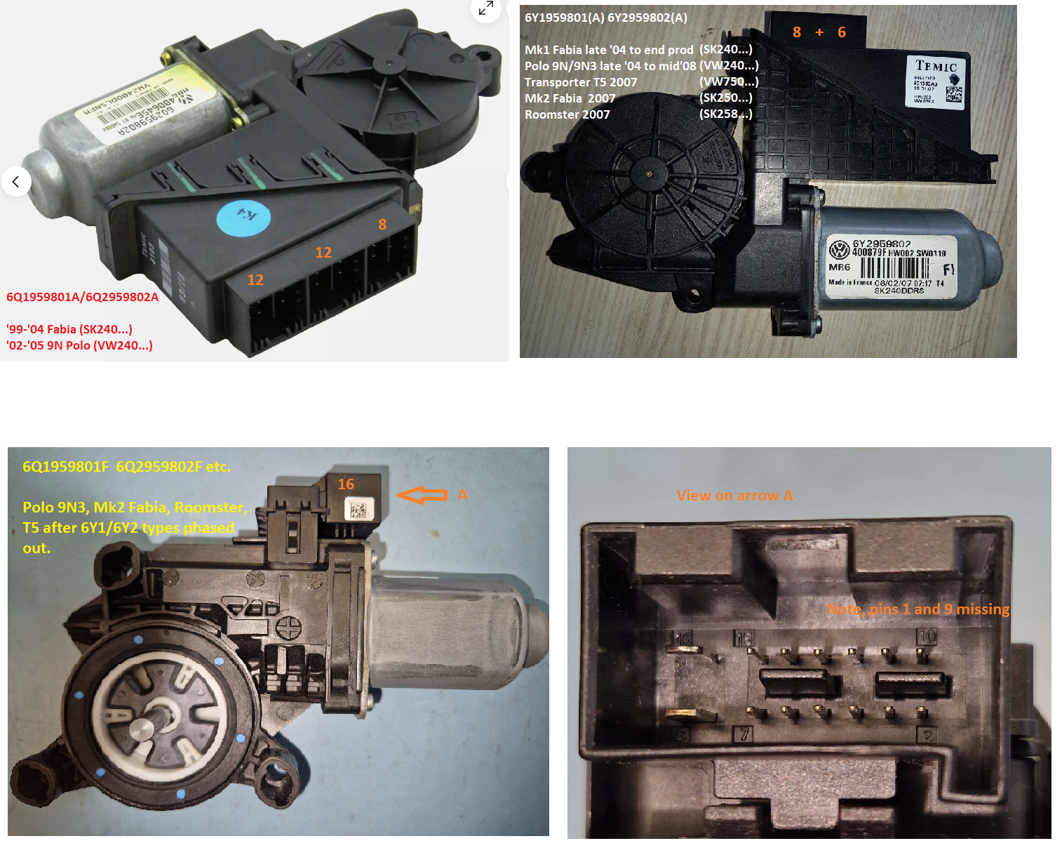

Hello @langhede , that's a good question, but the answer depends on which 6Q1959801 you mean.
The crucial information is contained in the letter after the core 9-character part number.
Older Mk1 Fabias (pre-facelift) used 6Q1959801A in LHD cars, 6Q2959802A in RHD.
Mk2 Fabias, from around 2008, went back to a 6Q... part number, but this time the end letter is F/G/H/J.
The 6Q1959801A and 6Q2959802A have three connectors, in contrast to the two on a 6Y... motor. They are involved in mirror control, the reason for the third connector. They also use two-wire CAN for communication connected to the convenience bus.
The 6Y...motors use LIN, single-wire comms with (only) their passenger side counterpart (and rear motors if fitted). No involvement in mirror control.
The later ones (2008> approx), 6Q....F, etc, use a single 16-way connector. Also LIN-connected only to other window motors. No involvement in mirror control.
I will try to add some photos later today, when I have some more time.
Edit: see below.
Note: the character sequences I've written in brackets relate the last line of the part number labels to the model that they are from/for. If you mismatch these, despite having matched the main VW group part number, correct function isn't guaranteed.
Numbers in orange are the number of ways in each loom connector, not all will have wires in.
I also have some advice on pitfalls to avoid if trying to purchase on the secondhand market, which I will do as a separate post later. Executive summary: beware of sellers who over-generalise applicability, and especially any that seem to have scratched out characters on the part number label.
Edited by Breezy_Pete

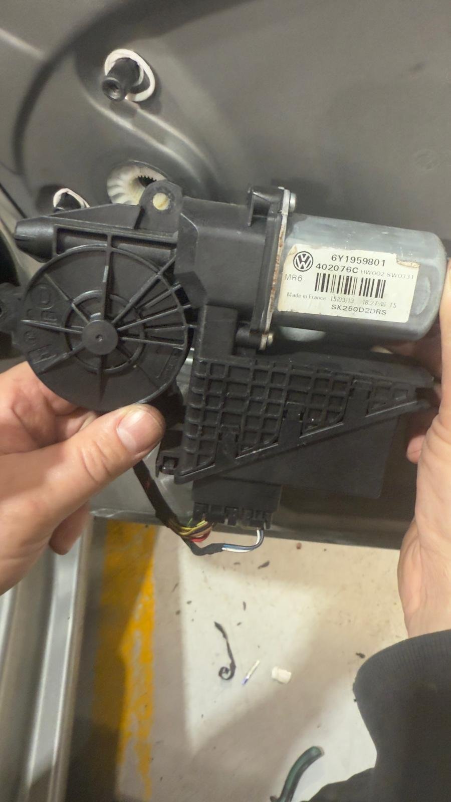

I'm looking for a replacement for my 6Y1959801, it's from a 2006 Fabia LHD.
Having a hard time figuring out which models i can use. It's hard to find a exact match... (That doesn't cost the cars worth)
Do you have any suggestions to a alternative replacement?
  • Sponsor
I will message you later, I think I can help. 🙂

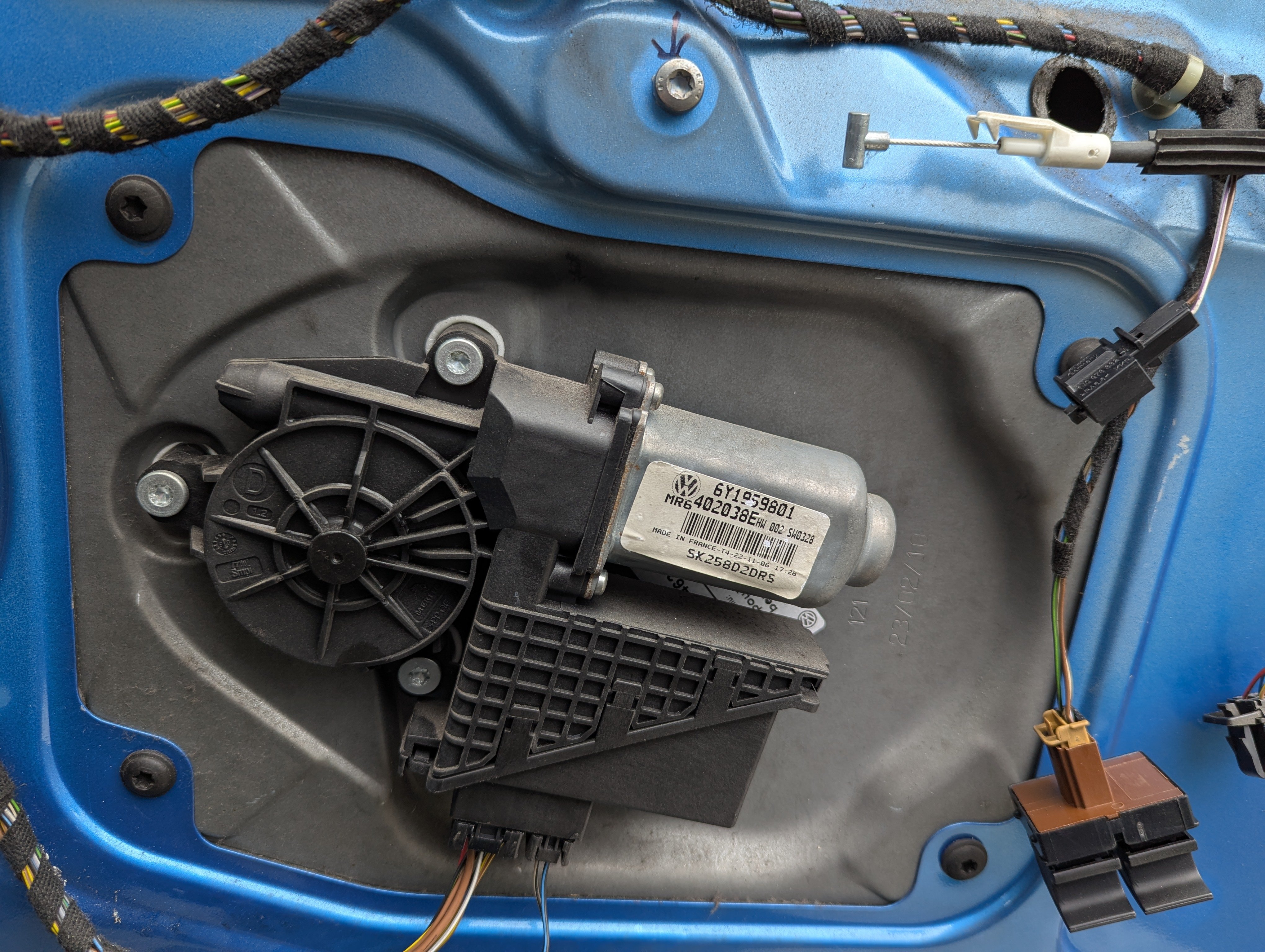

Here is a picture of the driver side winder motor:-
I wonder if you are able to fix this model.
Regards.
Bill.
  • Sponsor
Hi Bill, yes I can sort that for you. I'll send you a message with phone/whatsapp number in a sec. 👍

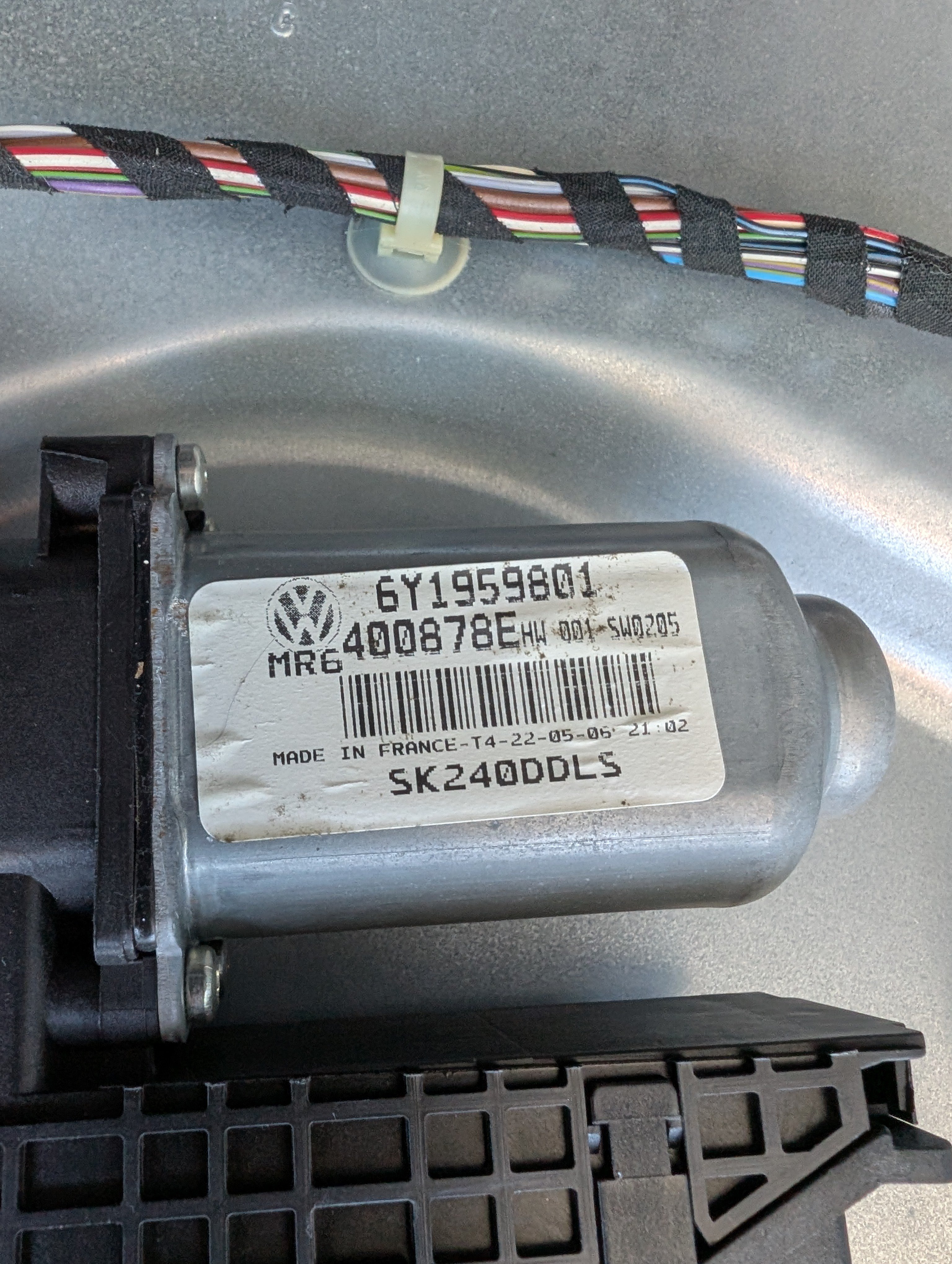

Any possibility you could fix this drivers window motor breezy Pete?
  • Sponsor
Yep; especially if you know someone north of the border to make return postage a bunch easier.
Will message you later.
