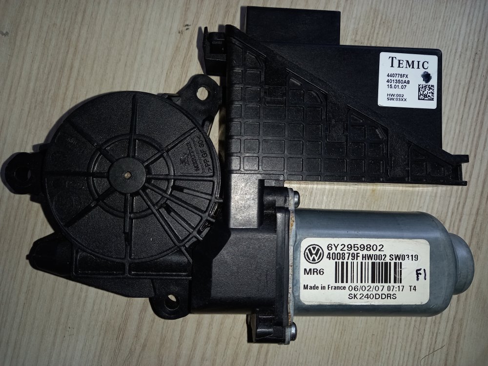

I have a Skoda Fabia mk1 6Y2 on a 56 plate which I have recently aquired. The previous owner had obviously had an issue with the passenger side window mechanism and long story short had removed the motor and regulator and propped the window up with a plank of wood. How I laughed........
The drivers side works fine as does all the other bits and bobs both sides. I am trying to source a replacement motor for the passenger side but have no part number to start from. I spoke to the main dealer who quoted 6Y2959801 SK1 (original) and SK4 (revised). He actually said K1 and K4 but added the S after a bit of discussion.
My drivers side motor is present and has a part number of 6Y2959802 SK240DDRS
I've searched the second hand market but there does not appear to be a visual way to see if a part is SK1/SK4 or otherwise. Is that a red herring or significant part of the part identification ? I have seen some suppliers stating that the chips inside are very model specific.
Once I have a part I'll have a starting point to work out what else reveals itself as not working !!
Any advice would be most welcome.

Hi Dave, thanks for posting.
Yes, that 6Y2959801 part number is what you need.
The SK1/SK4 is only ever visible in parts catalogue and on the box label of a brand new motor.
The key requirement for you is that the motor you buy should be from RHD mk1 Fabia.
This will be ensured by matching both the first and last line of the main PN label.
So 6Y2959801 first, and SK240PDRS last.
The actual software version (SK1 or 4) is not critical (and not easily determined AFAIK).

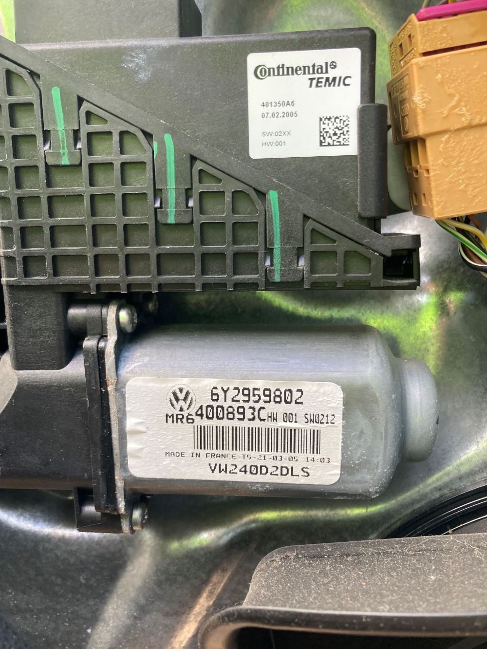

Hi,
I have a window lift module that is not working, something you can help me with, Vw Polo 2005 , 6Y2959802, central locking and window lift do not work on LF, I changed the module and tested it from RF in lift LF, then central locking and window lift VF work, but only for a while, if I lock the car with central locking in the door it works again for a while.
//Robert
  • Sponsor
I've just sent you a private message Robert. 👍

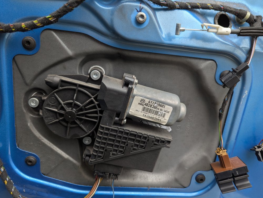

  • Sponsor
Hi @DazDude54, thanks for posting.
I'll be happy to help with this, and will send you a private message now with contact details.
Cheers,
Pete
