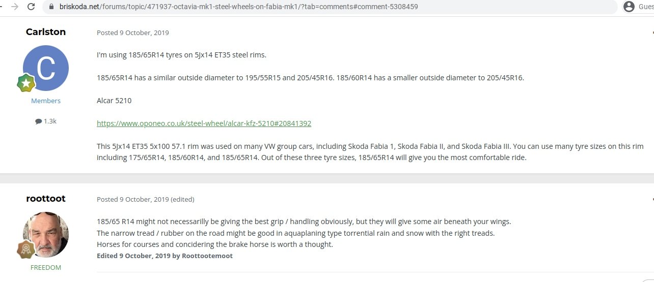

@Carlston
what you drive yourself is still a mystery, is it still the Mk1 Fabia estate on small steel wheels and narrow tyres?
For 3 years now my nose has bothered me as to what country you are in and what cars it is you personally drive.
You certainly know your way around the components and the scores on the doors but do you drive anything with wheels bigger than 15"?

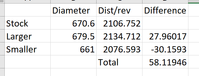

In a similar fashion I have another question about changing the diameter of your wheels/tyres.  Is there any issue with having a different diameter tyre on the front to the rears.  I have a Superb Sportline and looking at putting 20 inch rims with different widths/offsets on the fronts to the rears.  So to get tyres to match the differing rims I have to have different tyres front to rears and hence different outside diameters as follows:
- Stock = 235/40/R19 (DIameter 670.6mm)
- Fronts = 245/35/R20 (Diameter 679.5mm change of 1.31% = 9mm on diameter)
- Rears = 255/30/R20 (Diameter 661mm change of -1.45% = -10mm on diameter)
I know I could change the fronts to 240/35/R20 to reduce it to +5mm on diameter but I'd prefer the slightly wider tyres if I can.
Is this OK to run different tyres front and rear?  I assume the superb records the speed from the front wheels?  Any other issues with doing the above setup?

Just a thought, but could this cause issues for the ABS system?
If you change a tyre to a larger diameter than the ABS is set up for, then the distance travelled per one revolution of that wheel & tyre will be greater than the original.
For the numbers you've given, there will be a difference of about 58mm in the distance of travel for one full rotation of the front and rear tyres.
I'm not an ABS expert by any means, but I suspect that might be enough to confuse an ABS system.

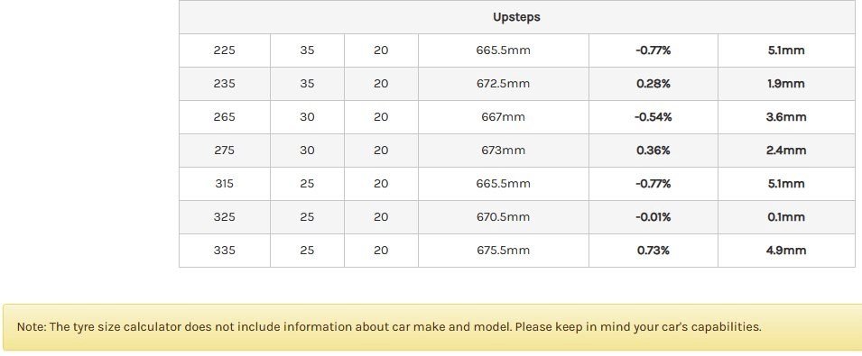

You need to allow for rolling circumference.  See here for details. - https://alloywheels.com/tyreCalculatorResults2

I have little interest in the absolute precision of the calculation, I just bunged the numbers provided into Excel and posted the results.
I accept that actual rolling distance may be different for the pure calculation of the circumference, that's a very good point, but I'm assuming (perhaps incorrectly) the difference between the rolling distance and the circumference between the two tyre sizes won't be much different to the approx 6cm calculated circumference difference.
If you're telling me there isn't about 6cm in rolling distance between the two tyre sizes, please explain why, as AFAIK my circumference calculation is sound, and based on Pi x D.

The tyre calculator I linked to seems good enough to me and saves opening Excel, note I'm biased as I can't stand Excel and my wife uses it a lot and her brother is literally an expert in Excel, so really I'm just jealous, but I did once know how to use Access 97.
