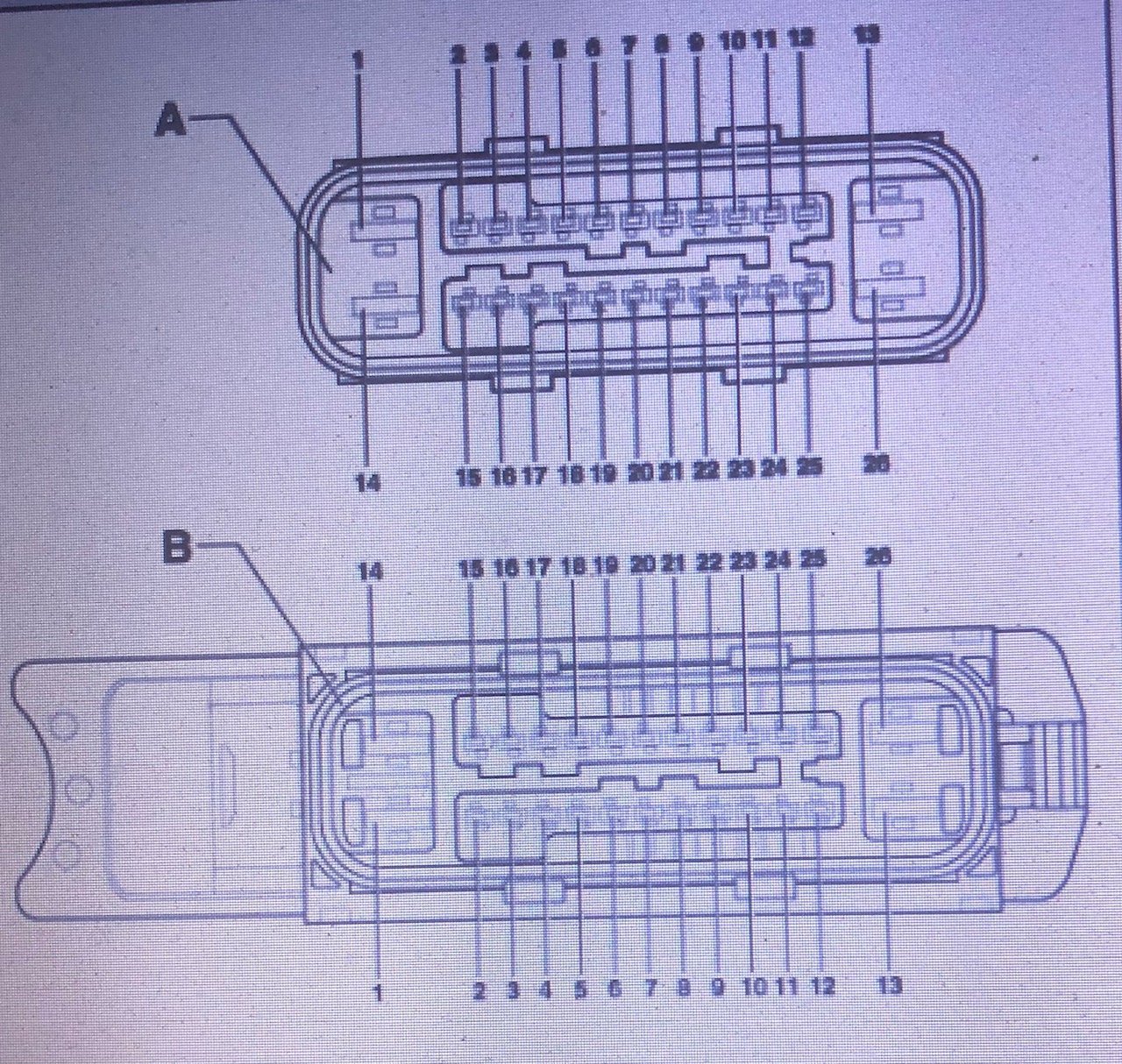

I know that feeling, you could try from the ABS unit connector, left front pins 8 & 9, right front pins 5 & 6, left rear pins 3 & 2, right rear pins 11 & 12
"B" is looking into the connector
Arh, this looks interesting, just where will I find this connector, under the bonnet or what?
Under the bonnet on passenger side on the rear bulkhead
