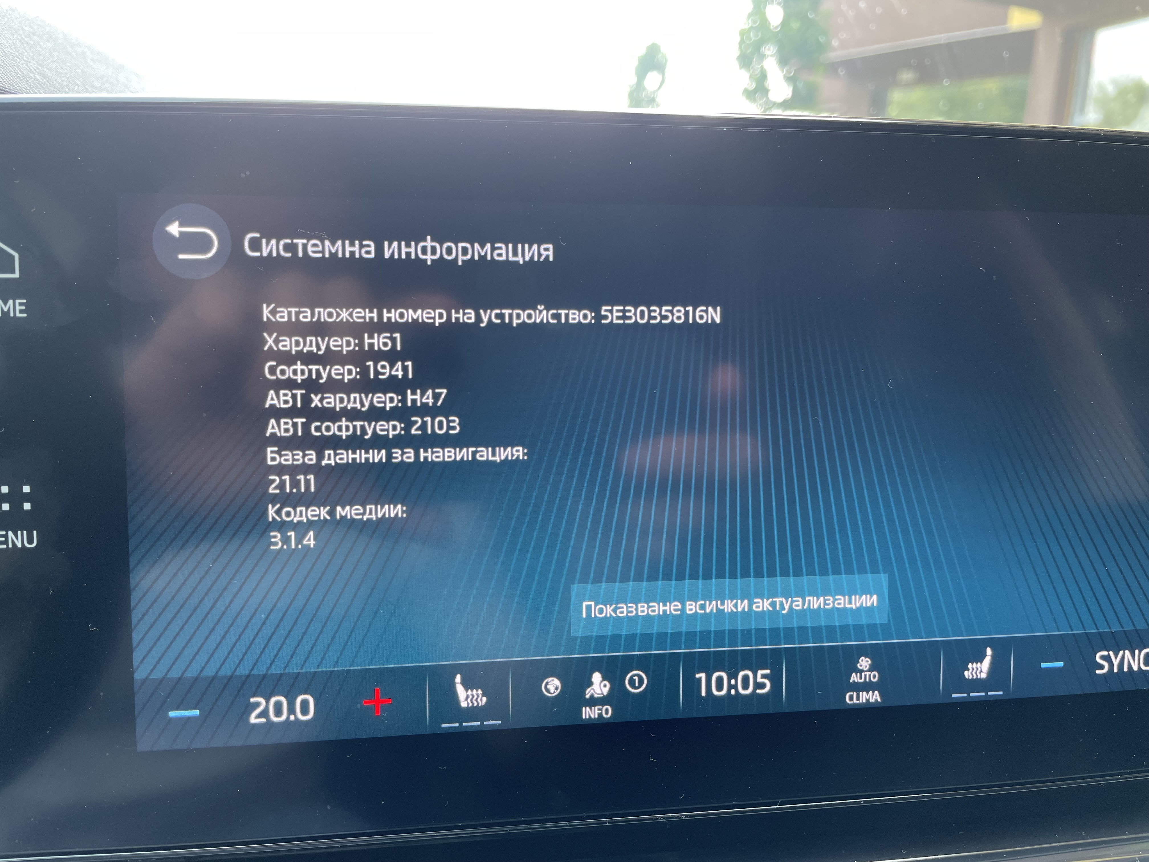

Hey guys I am from Bulgaria and I have my Octavia since 6th April 2023 and the problems started from day two - all the things that are mentioned before from most of you - monouver brake, SOS module, no sound, restarting every minute, parking assistance. After 5000km and 5 times in the service I saw in the forum about the latest update 1941 that most of you already have. I thought that is going to be the pill that will heal the system. Yesterday I took the car from shte dealer with the latest update 1941 and everything was fine since tomorrow morning... All the same ****. I am ****ed off and I want to smash this ****ty infotainment. I really don't know what to do anymore... I am sorry that the language of the car is in bulgarian but the numbers talks about themselves...

@Popovski Sorry to hear that you are getting bad experience with the 1941 version, but without a scan of the car, it is hard to say what is causing you trouble.
I presume there is a factory reset option for the MIB3, so have you done this yet?
@Rimac1970 Similar words to yourself, with the added news that there are IIRC some TPI documents that talk about battery drain, and maybe your dealers have not bothered to apply this fix.  I believe you have a 12V battery that does not always get charged when it should be, so will cause many troubles you describe.
