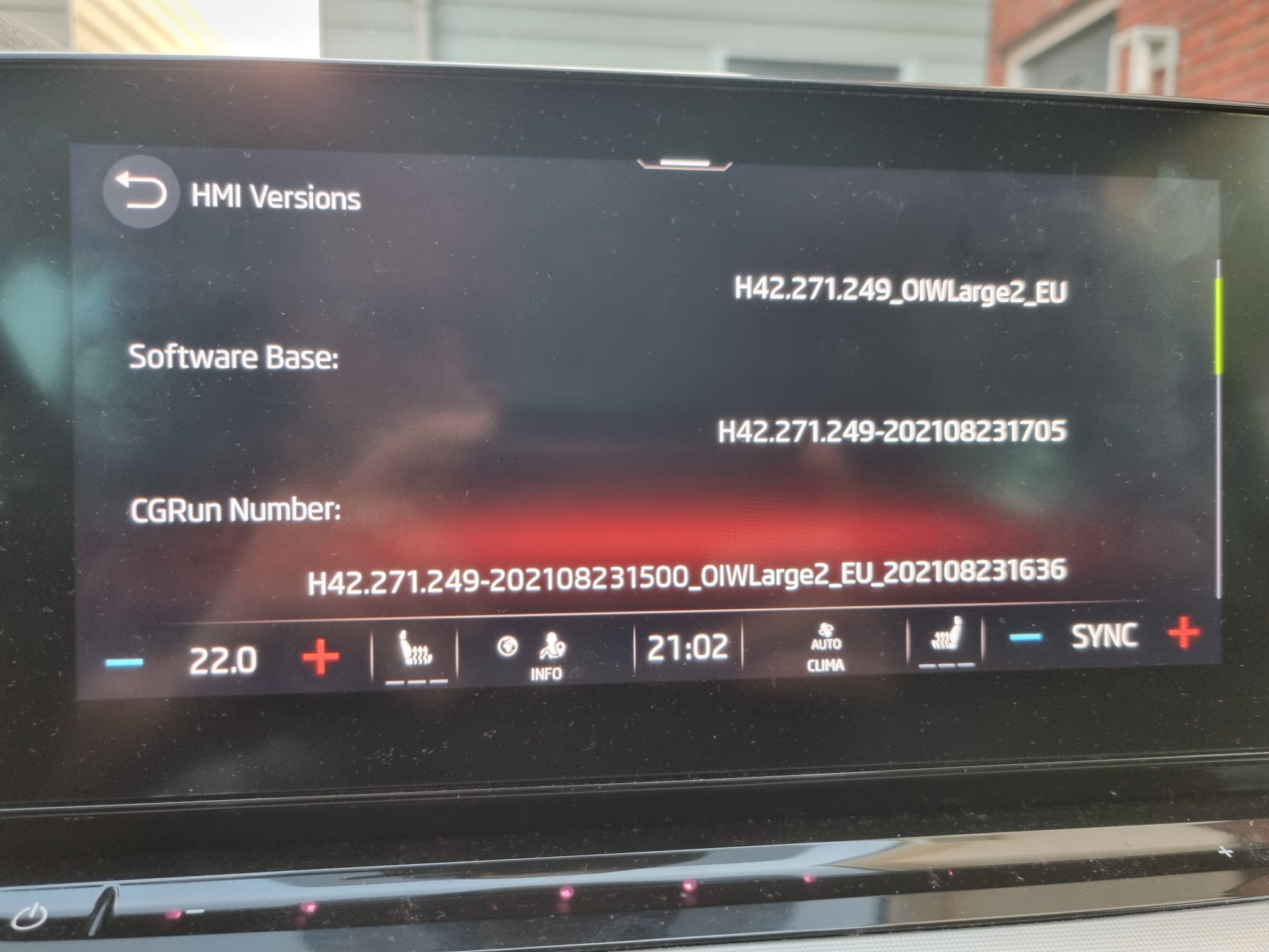

Hello all 🙂  I'm new to this forum, only have been leeching thus far but the time has come to participate, I was thinking that I would get OTA updates and my issues will resolve automatically but now half a year with these issues.
I am having the same exact issues with a First Edition since latest OTA small updates and together with the hot weather (it seems) continues reboots while driving, starting from 2 minutes from cold start. It is driving me crazy. My car is already out of warranty. I would like to give 1941 a try on this Skoda. @varooomwould you be so kind to send me the details? I'll report back if my issues are resolved.
I don't understand why Skoda (or VW) keeps these issues lingering for so long, many peeps now saying they will never buy a VAG machine because of these software issues, that's a shame..
@BloembolI will send this along now, do you know your current installed Software Train?

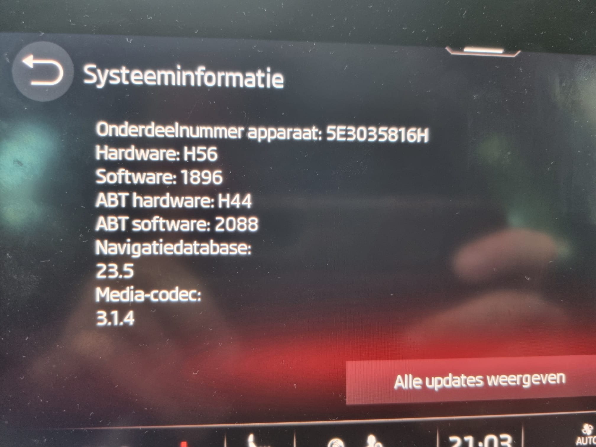

Wow you are fast with your reply 🙂 thanks. I currently have 1896 installed at the dealer in january this year. The exact details including HW versions i'll share later (currently don't have the car). Since it's a First Edition hardware numbers might be lower ;0)
It was more about the SW base level really.
Seems you are going to be ok to load this, so good luck.

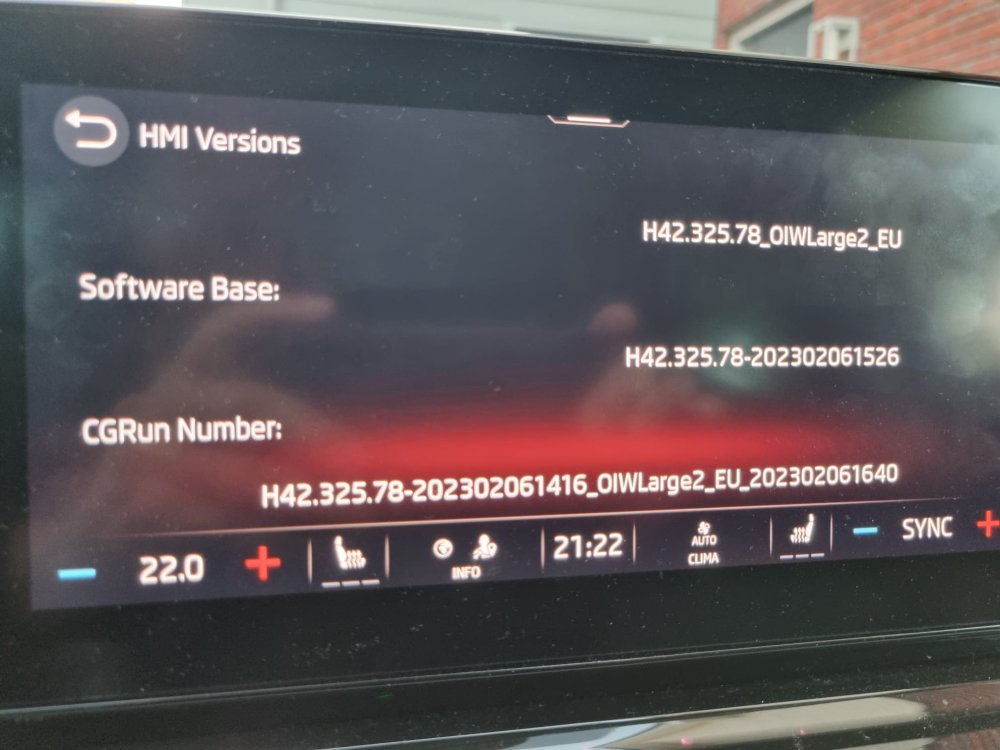

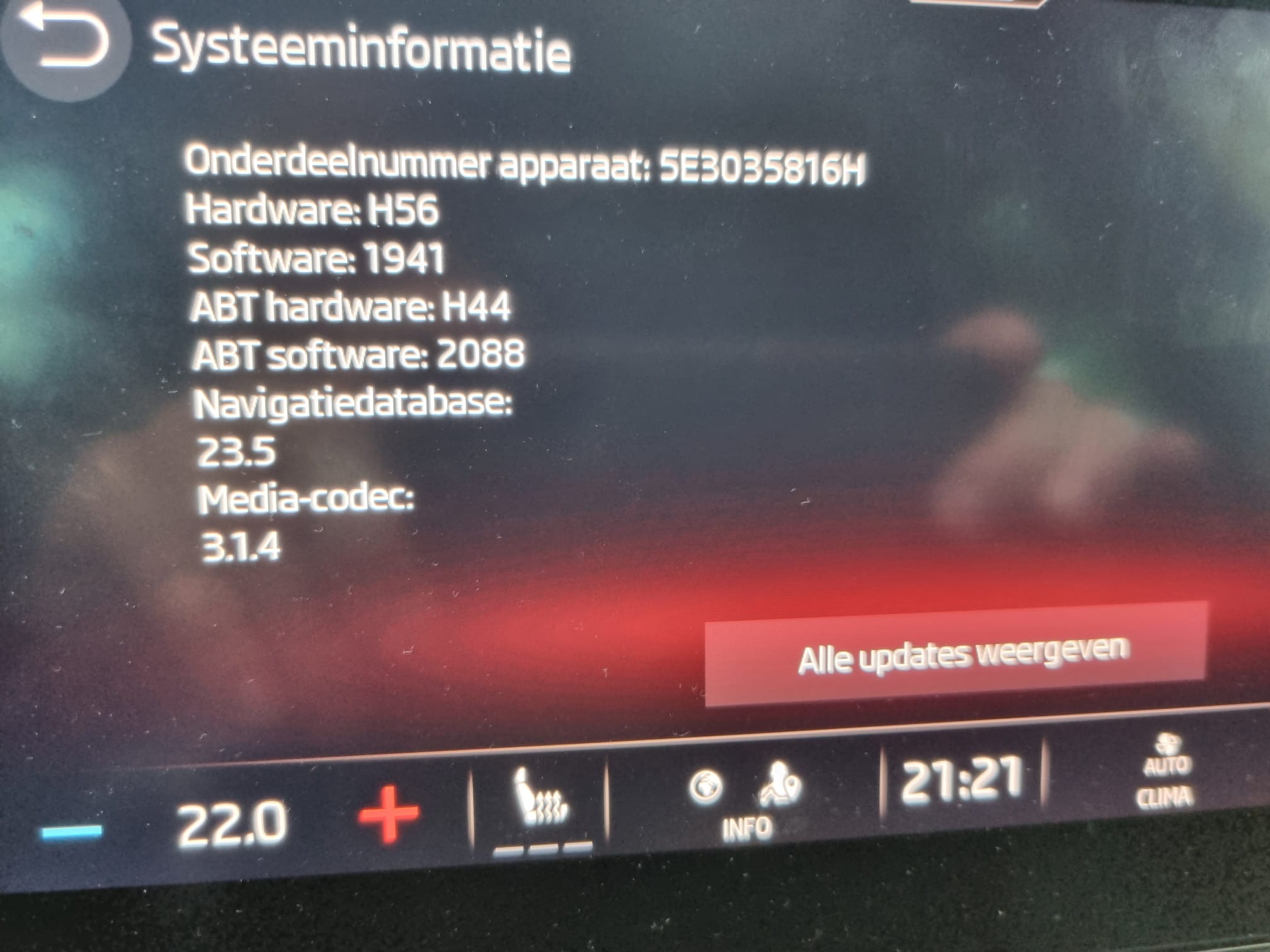

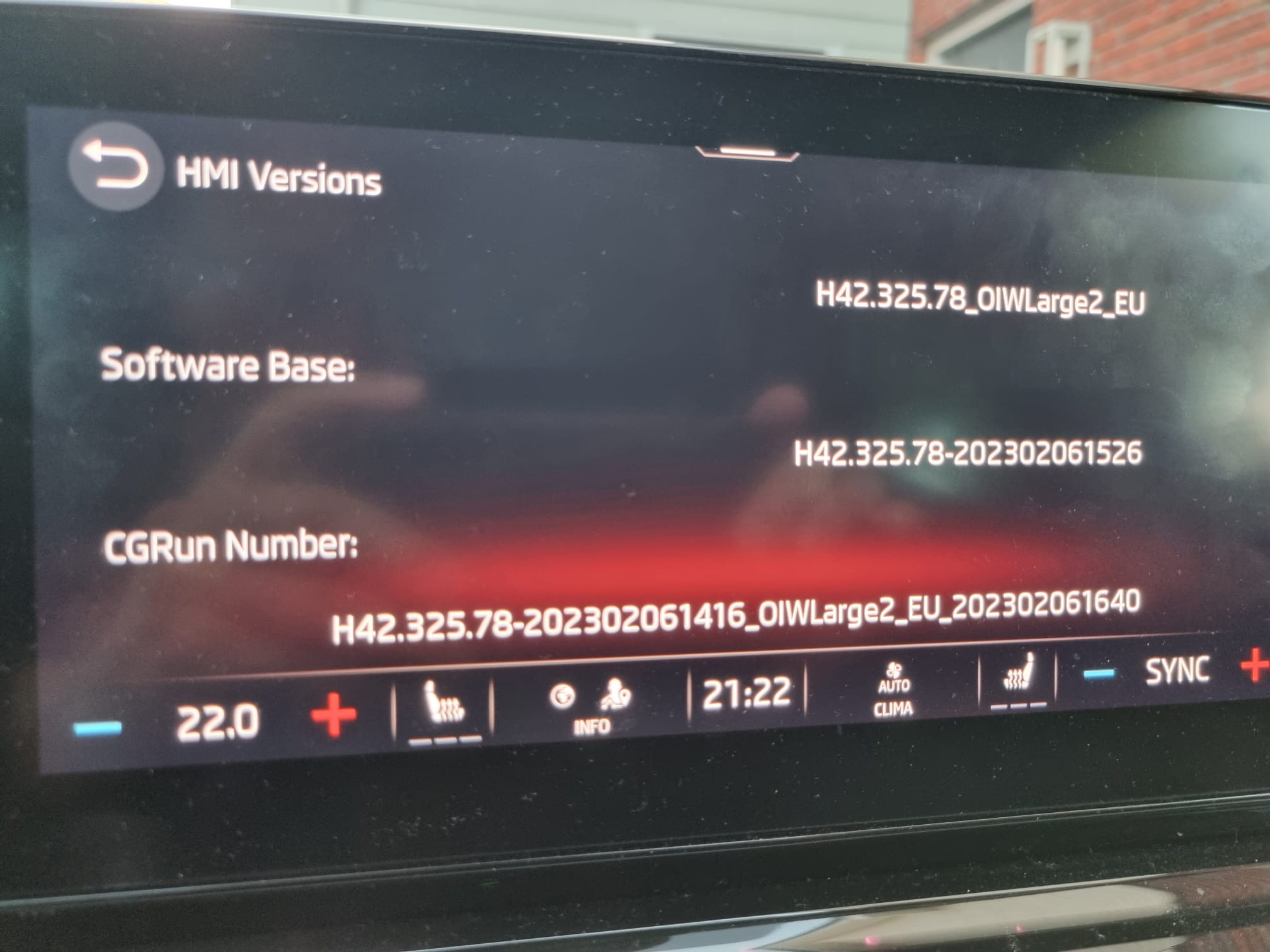

I just did the update to 1941 from 1896 hopeful to fix the random reboots that somehow came back. The process from start to finish took 15min.
I did notice that i was able to install an update which didn't install because backend services were not started, also the shop seems to have lost it's purpose because of that. Stuff I didn't care about. I bought all packages starting this year but didn't do anything with them, I was somehow hopeful that it would fix all the issues I had earlier. (update services OTA but 1896 is pretty old i think).
I'll report back with the result about the restarts, I really hope and believe at least they are gone, *fingers crossed*

No issues yet besides the shop not working due to some service that's not started. I can live with that if the rest of the car functions normally.
I'll make screenshot/clip next time i'm in the car and get these messages for reference here in this thread.
I noticed tough that startup and menu operation is a bit quicker, more responsive. I'll be honest, this might just be a placebo if having something new and shiny 🙂
It's a bit too early to say that it is a 100% success but so far no Infotainment crash.
