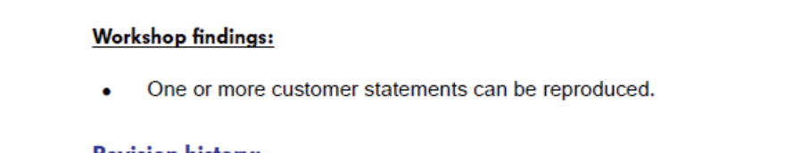

1 hour ago, vran22 said:
I have also all documented with videos for them.
That is useful for the dealer as the TPI text includes...

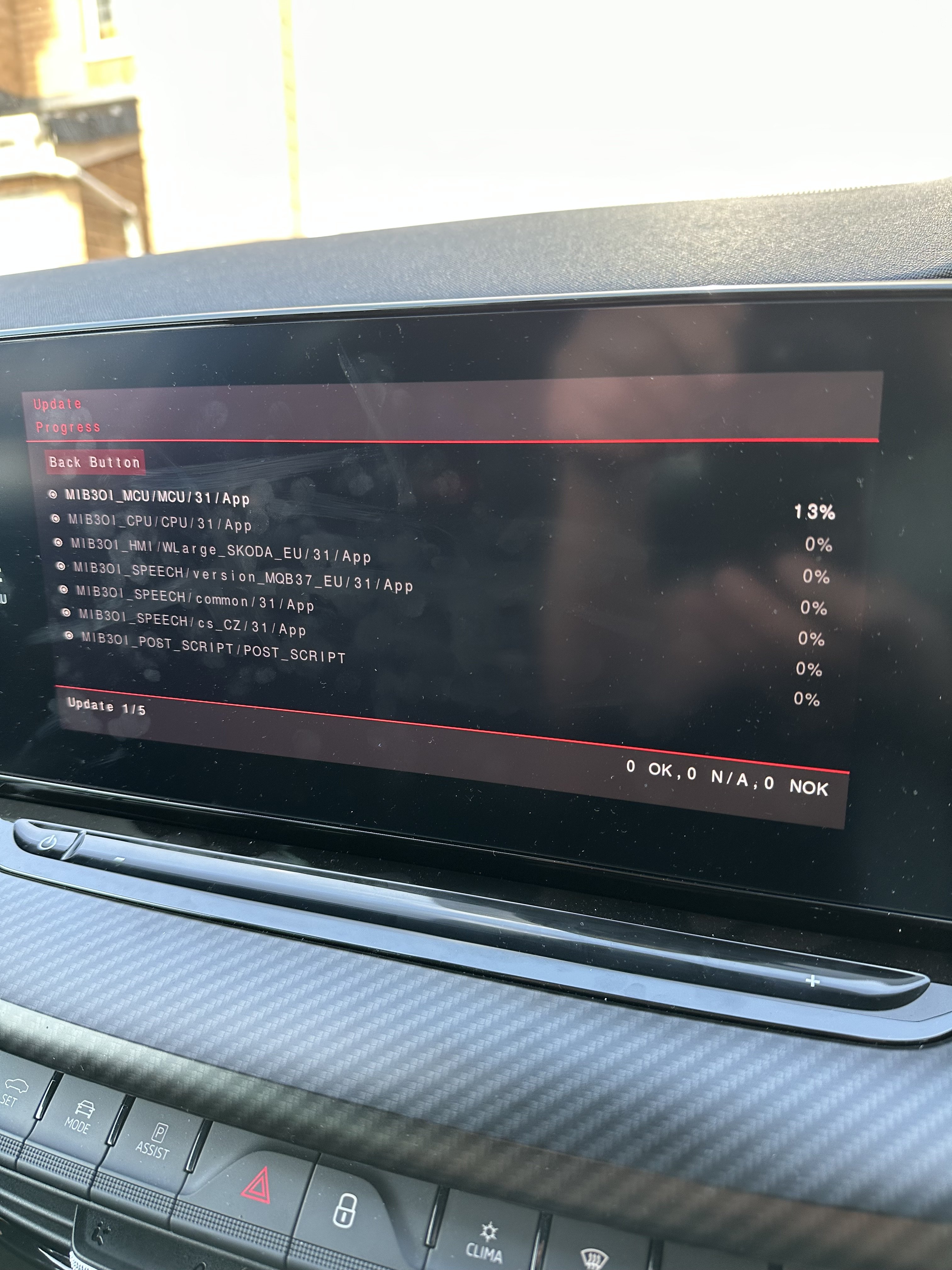

Updating as I type this
All done thanks varooom
Anyone in the uk
I bought a Scandisk 64gb USB C for £12 from Argos
took around 15min to update
Edited by Andy585
