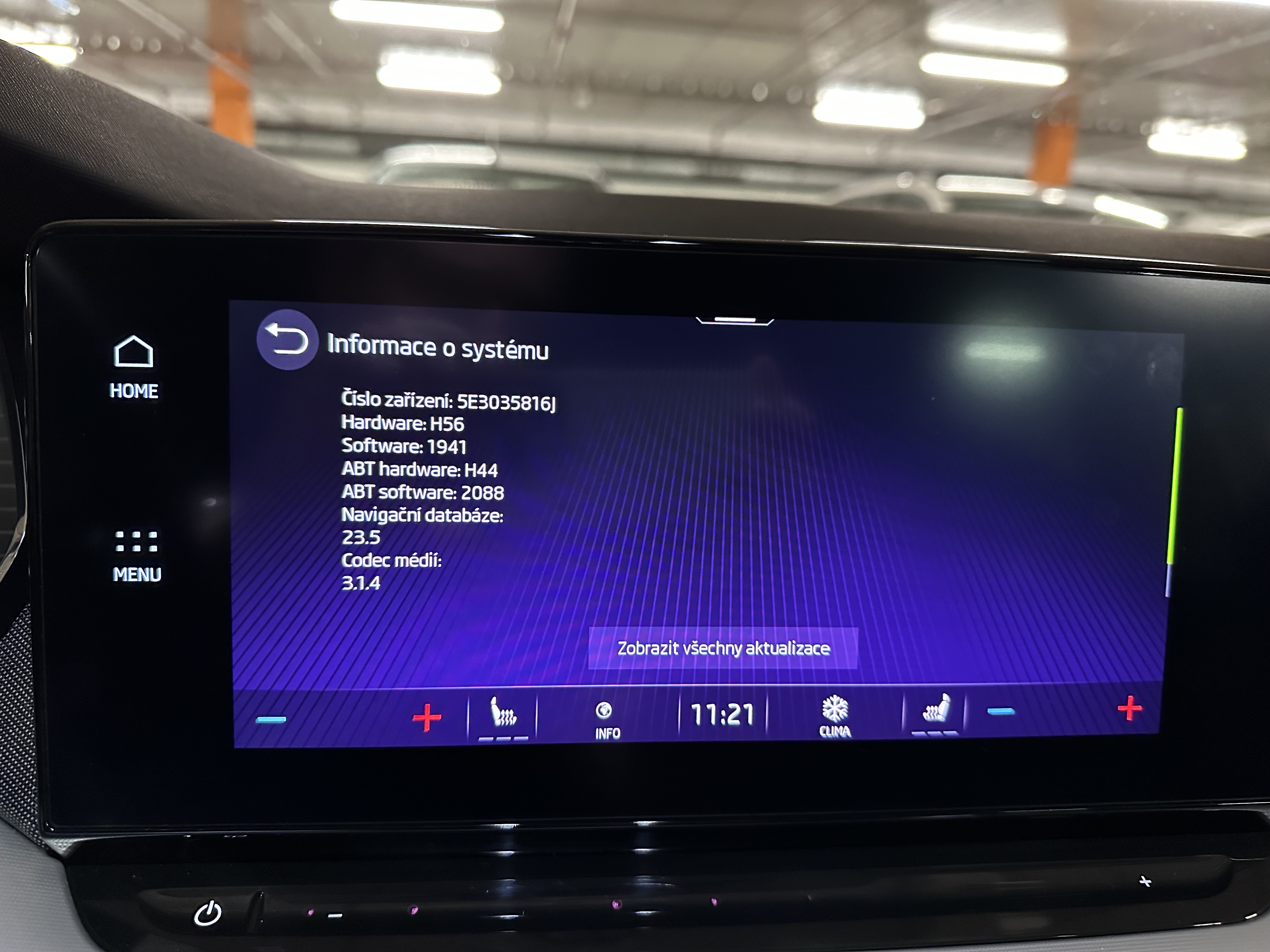

I could also ask you for a link.
Now I have 1896 and H56 hardware
see photo-
2 hours ago, Patiiik said:
Hello,
see photo-
You have a Private Message, best of luck

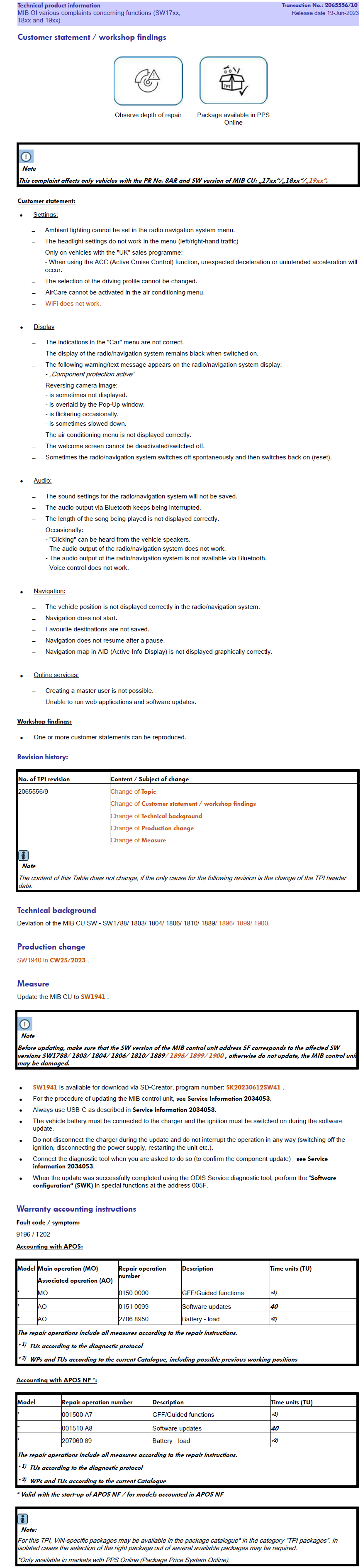

Hello everyone, new forum member here.
My car's infotainment was also rebooting all the time since late april after update to 1896 on february 27th. Usually once or twice at the start of the ride but the most was 5 times in a row.
I contacted a dealer yesterday and got the answer today that there was already released TPI 2065556/10. So 2065556/9 mentioned on previous page isn't even the latest one anymore. The /10 is also about update to SW1941 on the infotainment.
Anyway got my car scheduled for update to SW1941 on July 5th.
@TheWanderer Did you notice lately anyone getting an major update over the air? I think Skoda stopped doing that since it was too many issues with the last one sometime in 2022.
No I didn't, I've only had this car since February. Quite a few updates but they've all been done in a short time and the last one screwed up my infotainment system.
Yes these are revision versions, and could change tomorrow, or in a week!
99% of the detail will probably be the same, but could also be something else like make sure TPI xxxxxxx is already applied etc, or a new process to perform after to make sure things are working as intended.

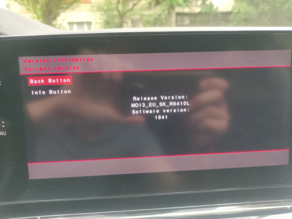

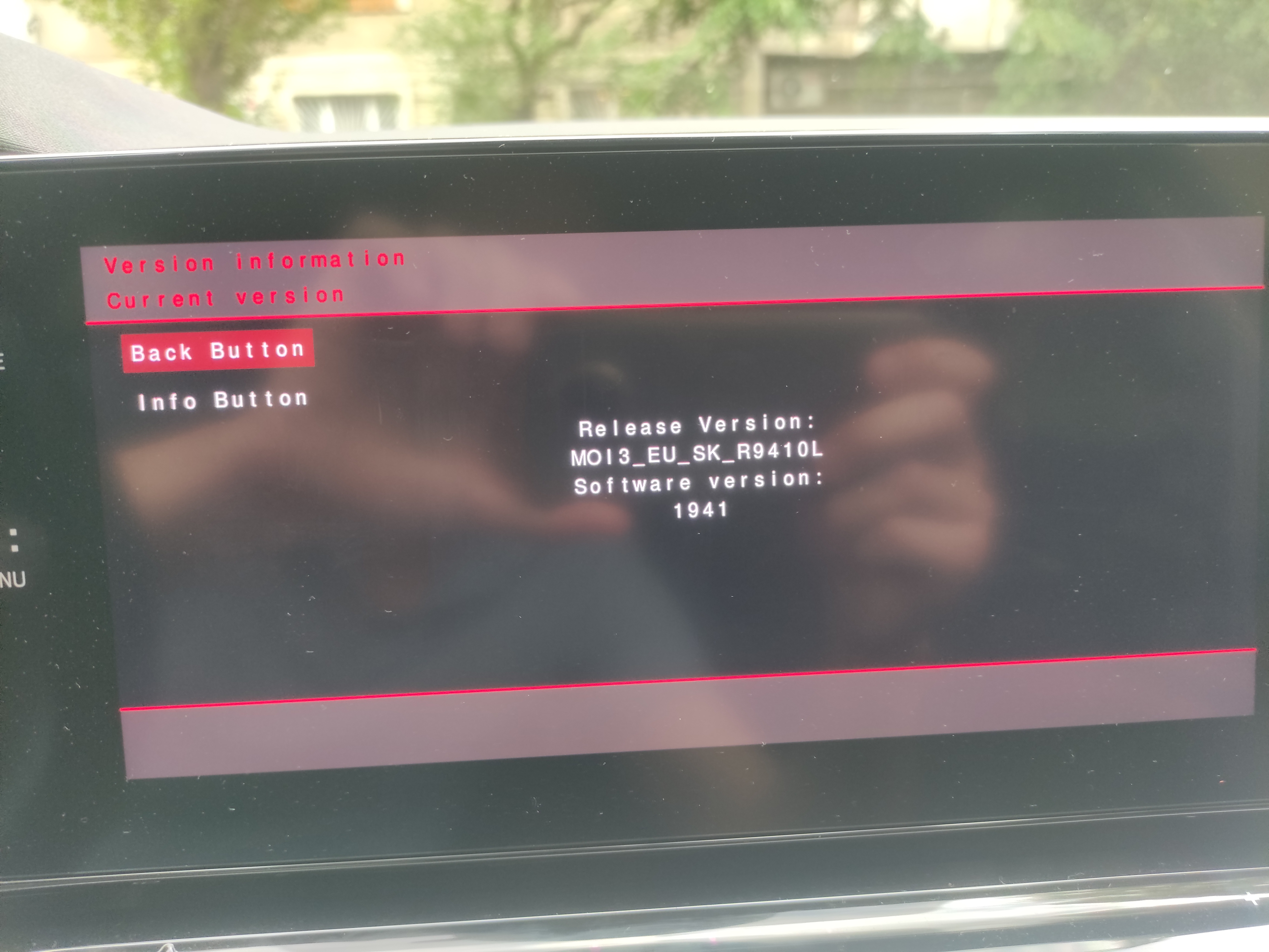

I've just installed the 1941 firmware by my dealer (from which I both the car) a couple of hours ago. The guy that picked up my car seems to be aware of this problem (nothing surprising for him), funny thing the MIB restarted(twice) in from his eyes when he was filling the service form.  Even so, he asked me about some evidence(videos/pictures) for the SK to show them. 🙃
The whole process took 3h.
No reboots in the short trip(~20km) back home, but tests and statistics are still on-going. I'll update this thread after more(short and long) trips.

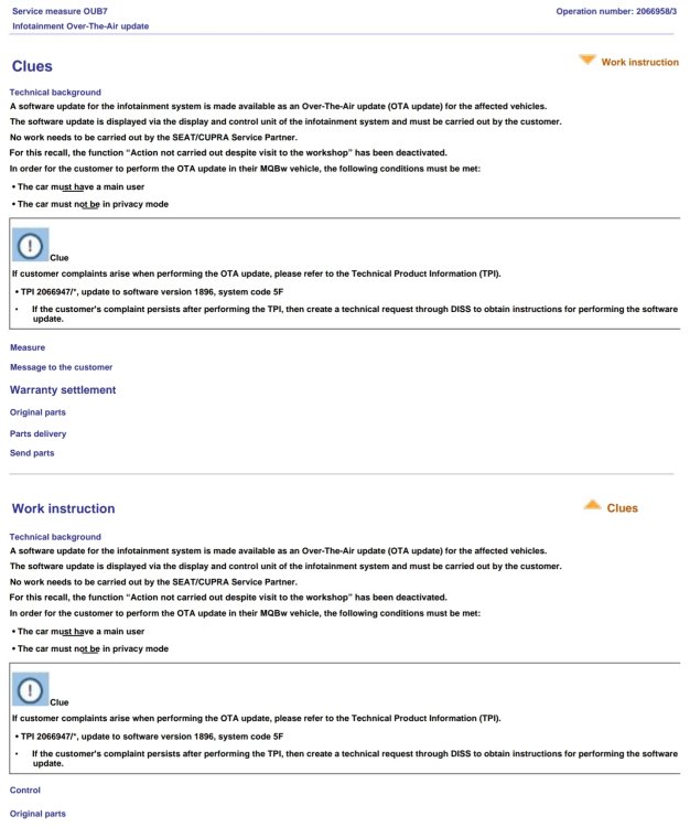

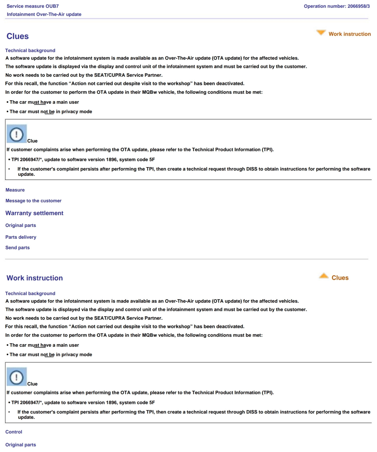

Here's 2065556/10. Changes from revision 9 in amber.
I’m sorry, but how does this relate to the latest software version? Please explain.
