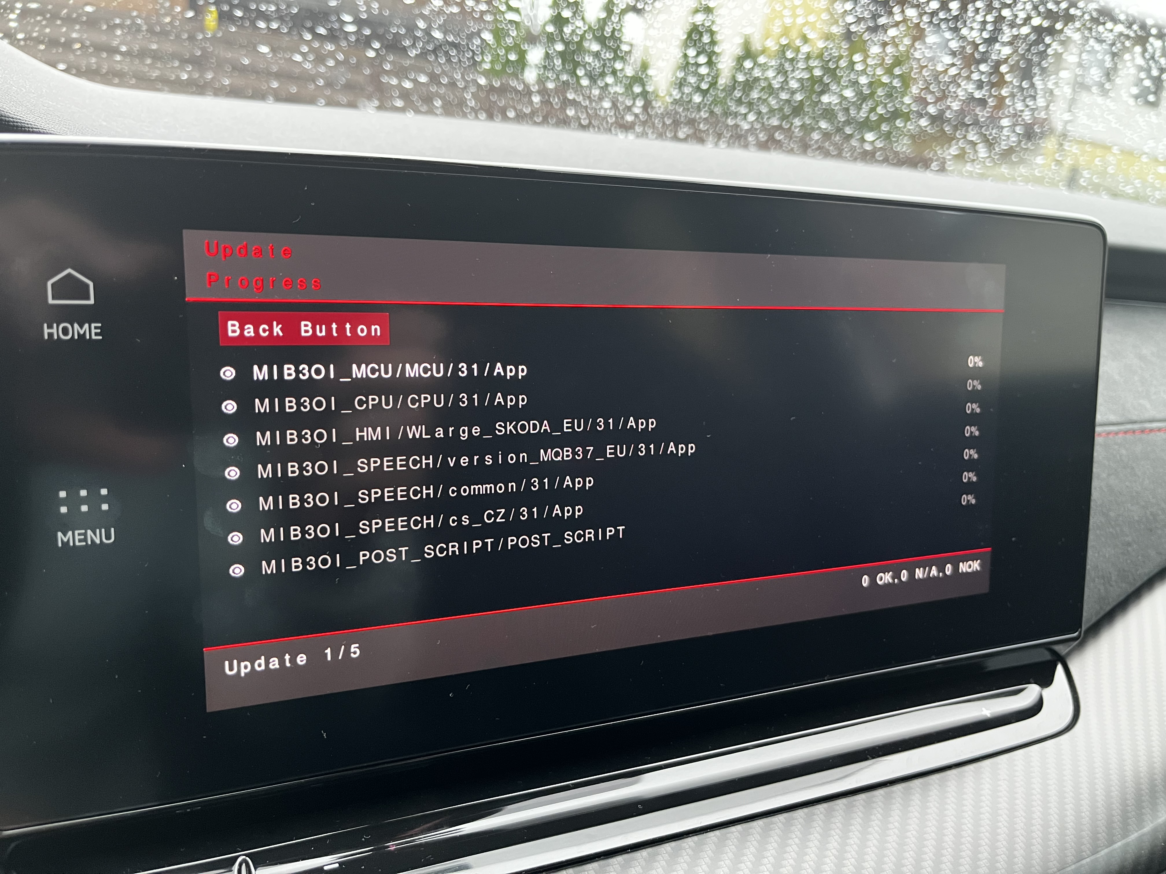

Ok ... just installed without any issue with the USB adapter but it took time, around 35 minutes, consider the use of a battery charger while the update is running.
My feedback: all good! Driven the car a few times since the update and all seems fine. Update took me about 20 mins. Many thanks @varooom👍🏻

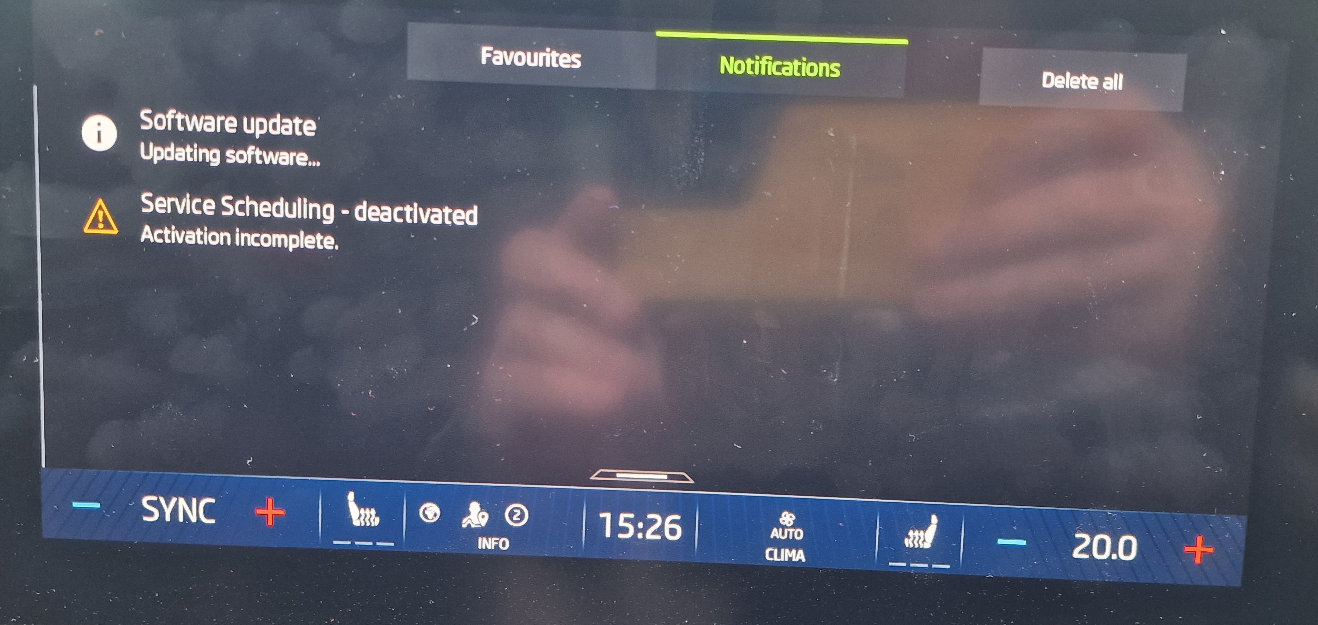

Not with the increasing number of faults that were flagging up, all went smoothly, all of the items flagged up as OK.
Waited a while tapped resume and after about 60s all came back online, just got one error which I hope is temporary 🤞
That's regarding servicing see pic. 20230627_152600.thumb.jpg.24e42a177928581c1b94dc21c2f0a0cd.jpg

Thanks again @varooomfor the file. Gonna do update tonight. One last question for you guys that did it - engine on or just the ignition on? Or nothing on? Cuz some of you worried about battery dying.
I just left the ignition on, turned the headlights off, but forgot to turn the air con fan off, so was praying 🙏 .
Got a good battery so it's fine, just waiting to see what the software update that it started immediately afterwards is going to do. 😬
Got a servicing error and manuals are missing, hopefully they will get an update and clear themselves. But everything else seems to be working fine, haven't tested with my phone & AA yet though.
@TheWanderer I suspect after the car has gone into a deep sleep mode, that these final items will be fixed and updated.

My two cents:
My MK4 MY22 (December 2022) Octavia only had the random reboots of infotainment and no other issues (1898 Software, H58 Hardware versions)
Soi decided to proceed with the update on my own and I successfully installed it just few mins ago in).
The whole process took 5mins for MCU, 5mins for CPU and around 3-4mins for the rest. I turned off start/stop, turned on ignition and waited till it finished. I used a usb-c to usb-a hub since i did not have a type-c memory stick.
Tomorrow i will test drive it and post my results :)
Thanks everyone for tips and tricks and especially @varoom for sharing the update.
