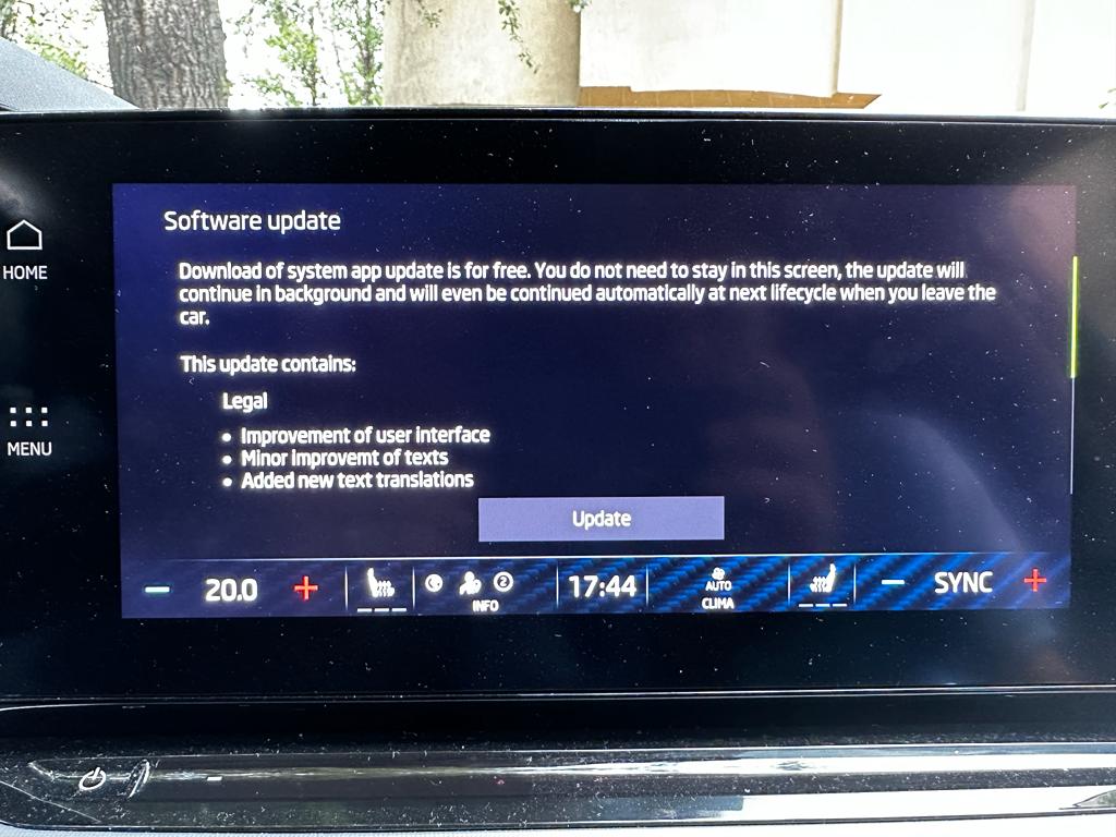

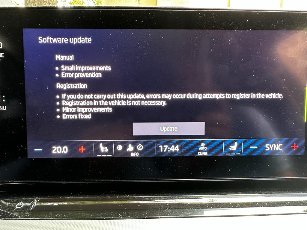

I've just installed 1941 on a friend's car, who is very busy and he didn't have time to waist it with the dealers. We(Briskoda Community)  manage to bring his smile and to still love his car after this upgrade. Before this, he was very grumpy with all those sort of reboots.
I do have one question:
Has anybody else that installed this firmware by itself, received the following OTA update?
I'm asking because I didn't receive it on my car, and I'm wondering if my dealer has disabled some on-line services!
Other then above, no more reboots or any kind of issues after this weekend journeys.
Keep up the good work!

I also got that update immediately after upgrading to 1941 by myself.
Thanks @varooom! The update was successful and the reboots should be gone now. Now there's only one small annoyance with an update of the manuals failing. I can remember having the same problem before and the manual was then successfully installed a couple days later, I hope that's the case now as well. Looking at @djmartzian's post above, there's a fix for the manual, so maybe it just needs a full deep sleep cycle.

I also received this OTA update after updating to 1941. It installed right away and has been working flawlessly.
I’d just say a massive thank you to @varooom you seemed to have saved me the headache of the reboots!!
I also received an OTA update after installing 1941.

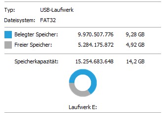

I downloaded and unzipped the files directly to the main directory of the USB. Before i did formatet it to FAT32.
But in the menu to choose wich USB-Port to use, the car doesnt recognise it.
I had to an USB-C to A adapter.
Any ideas whats the issue?
Thanks

If it's an adapter which has more than one lead or port, it won't be. I've tried to use one, the way the system is programmed doesn't allow hubs to be used, which is rather pathetic IMO.
I bought a 16gb usb c drive for £10 or £12, just for this purpose.
thanks for the info. Actually its just an direct adapter from c to a. no hub. Maybe ill buy one usb-c stick today anyway as i might need it for other purposes too.
