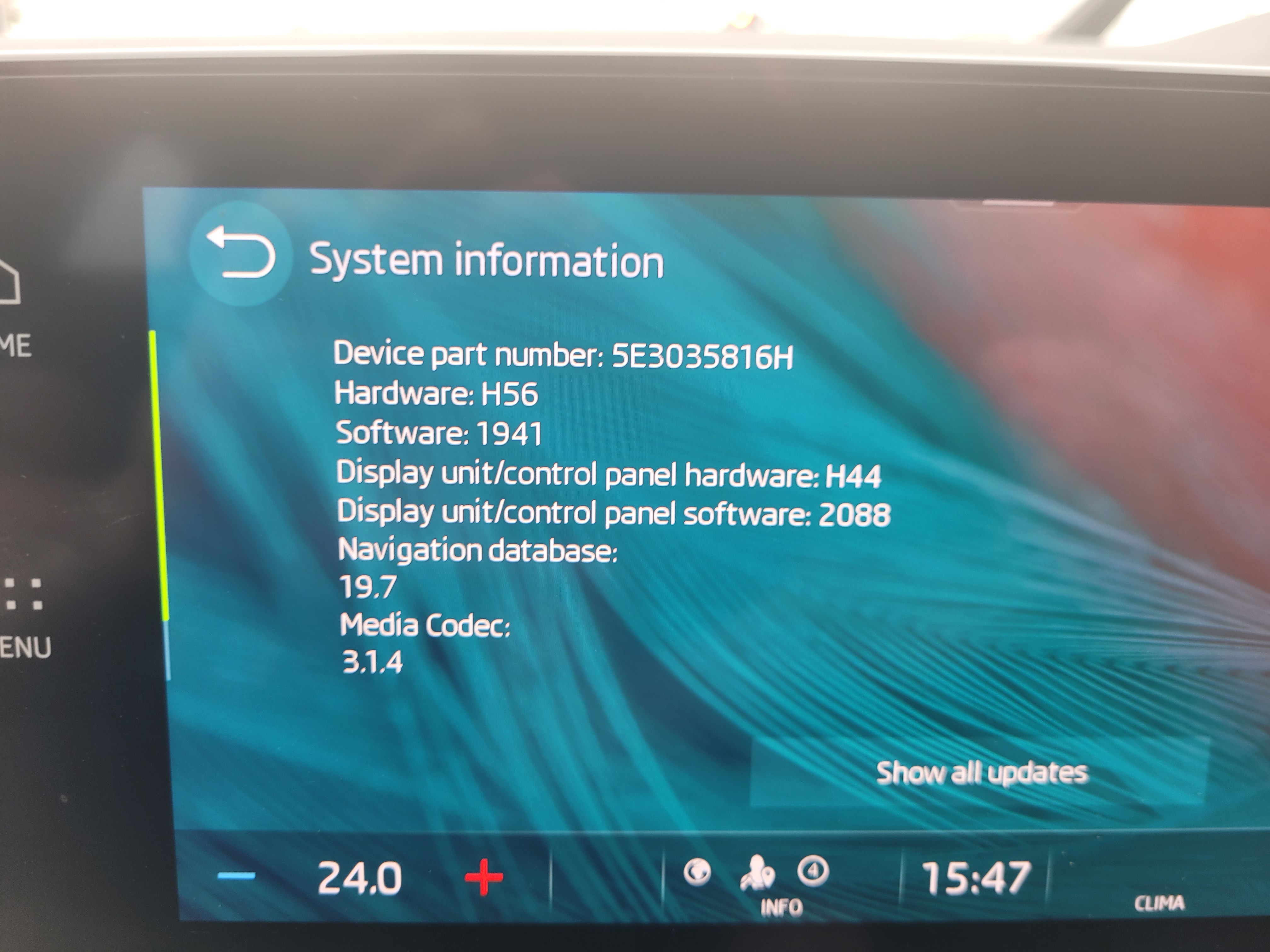

thanks to @varooom, updated to 1941, now testing.. so far, no more reboot

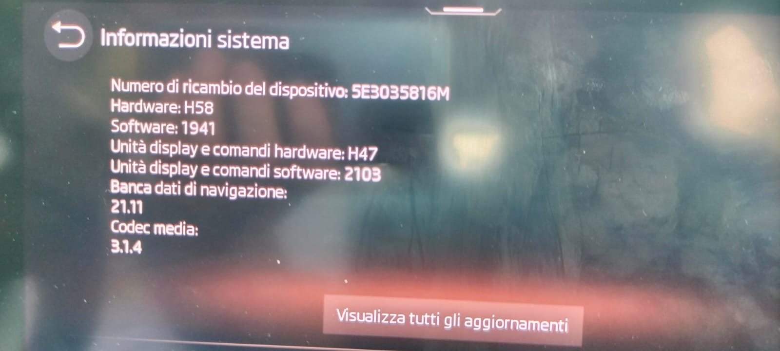

Hi @varooom, I have and Italian Octavia 4 with a lot of reboot.
can you share me the update?
tnx

Yes, let's fix your rebooting
