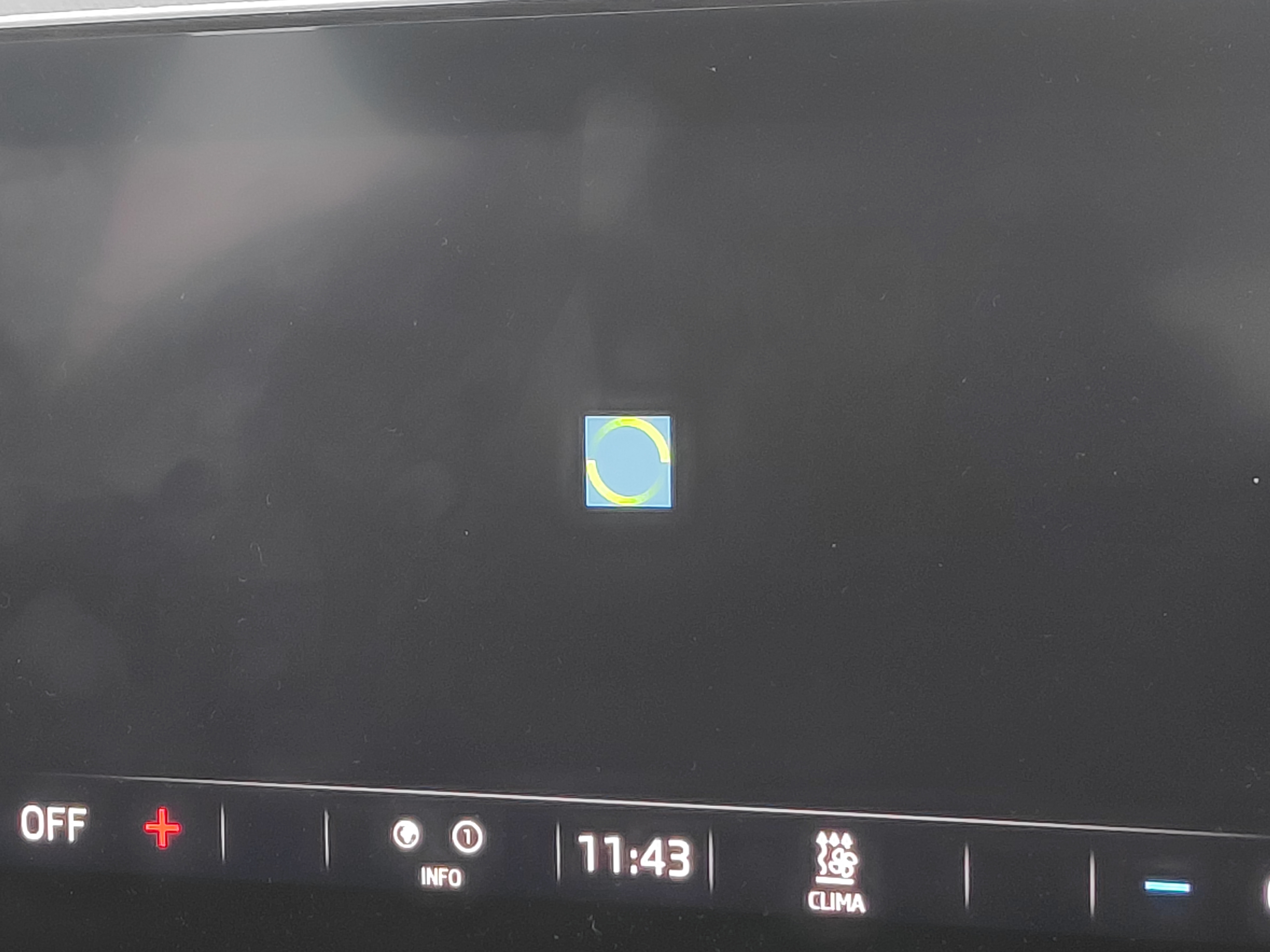

Does this mean it's updating? Can I switch off the ignition?
Yes on both counts. When the number in the ‘info’ window disappears then its done. Can take a couple of cycles to complete.

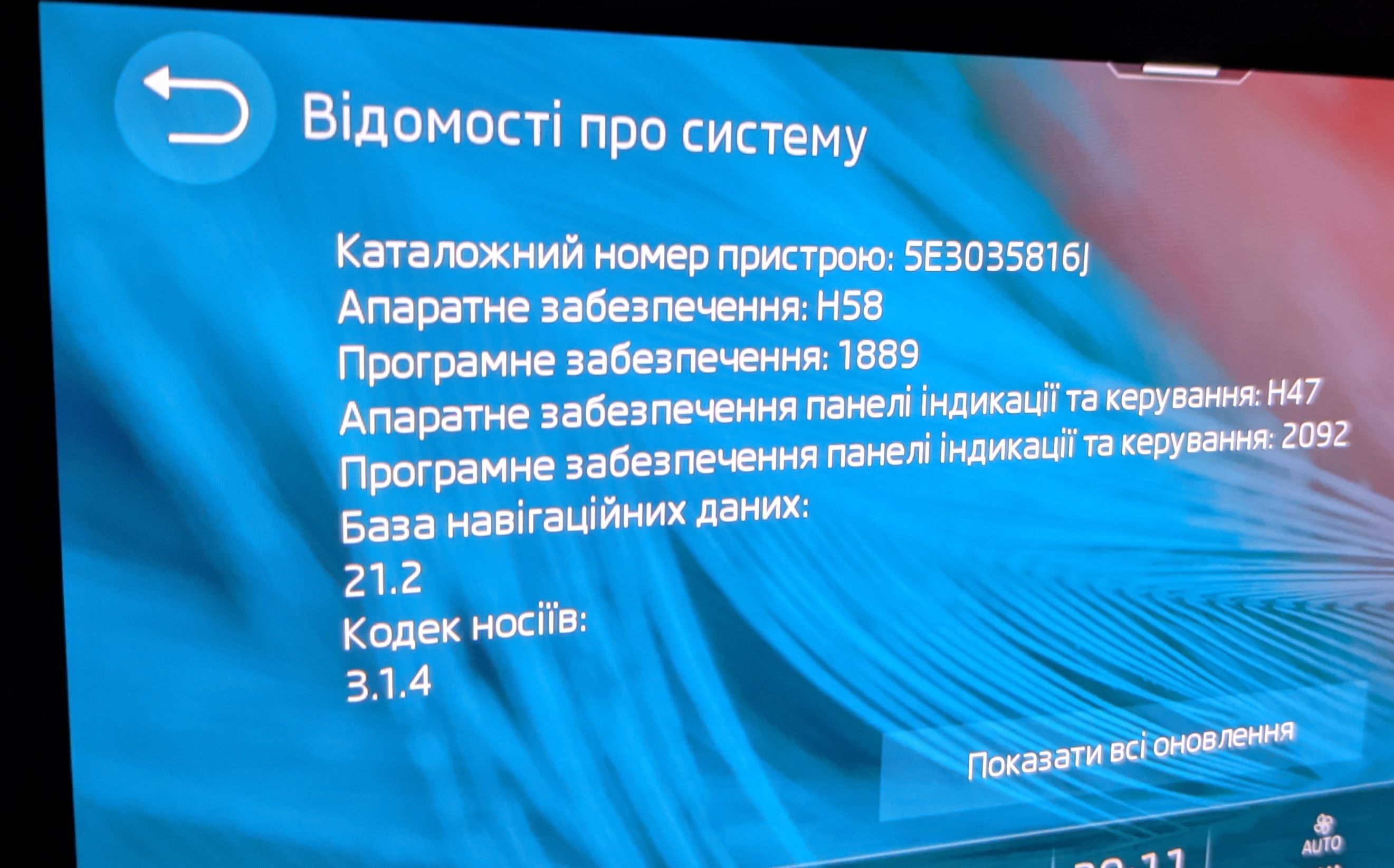

Hello fellows!
Will I be abl to safely flash 1941 while I have currently 1889?
Yes, no problem to upgrade from 1889 to 1941, you should be good to go. Just follow the steps indicated on this topic and it should be ok.
You can also update the Navigation database, I see that your maps are since February.2021
Use the Skoda Update portal below, enter your VIN, download the Maps and follow the instructions on that web-page:
https://updateportal.skoda-auto.com/en-US/Updates/
Thanks, appreciate your quick response 🙏. Will be back with a result and see what's change afterwards as I also have continuous reboots that keeps annoying and local dealers apparently useless telling they have no solution for this.
Most of those who experienced random reboots before SW v.1941, had no more such problems after the update. So your infotainment should perform better afterwards.

On 08/12/2023 at 09:15, olehb said:
Hello fellows!
Small update on this, I really did an update of the infotainment the day I asked but decided to see how much better it is for some time. And I must admit it really worth to update to 1941! The overall response of touches is very fast and system loads much quicker than before. Also I didn't notice any reboot since the day I applied update. Thanks everyone on this forum for their input 🙌
