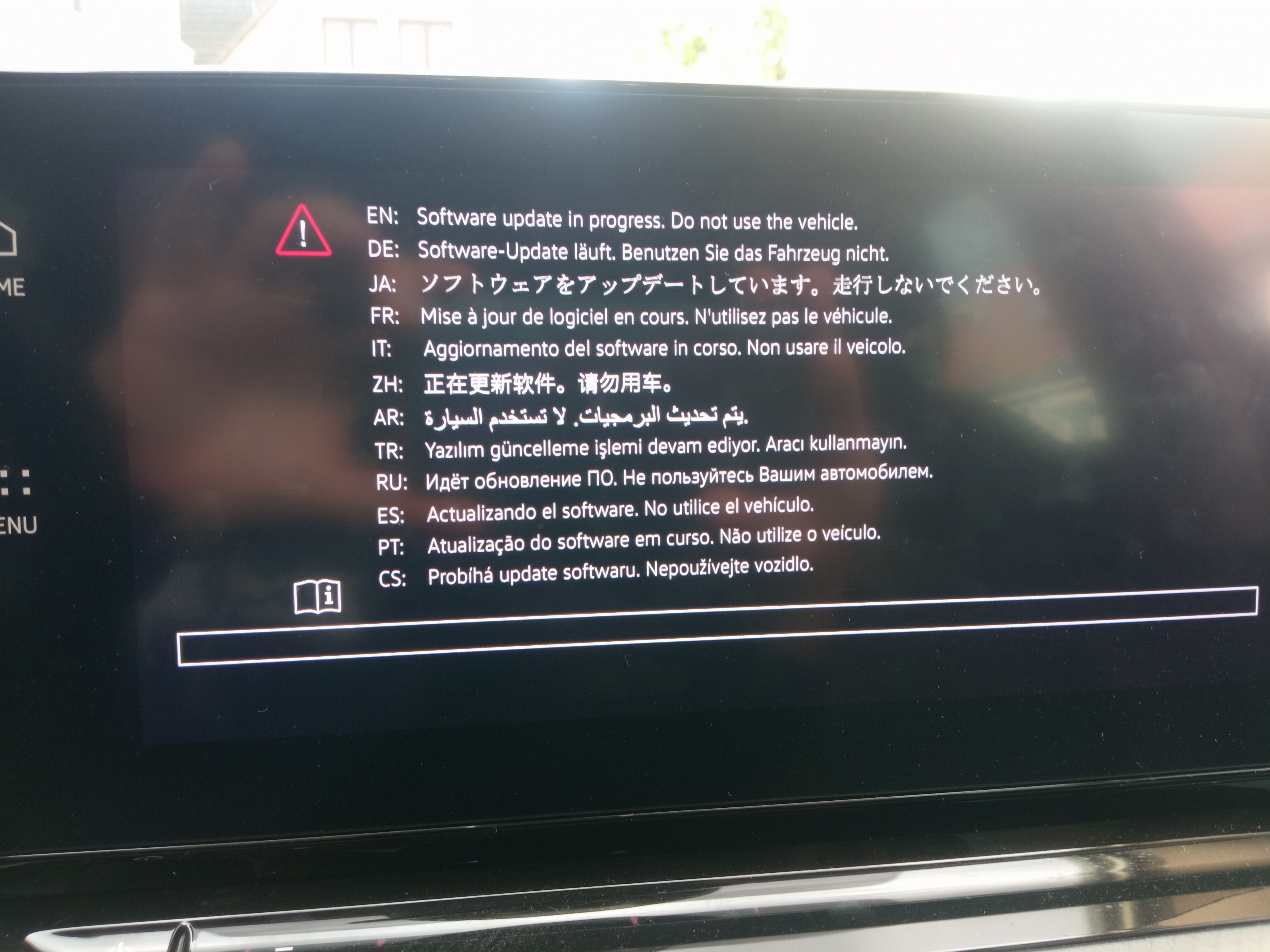

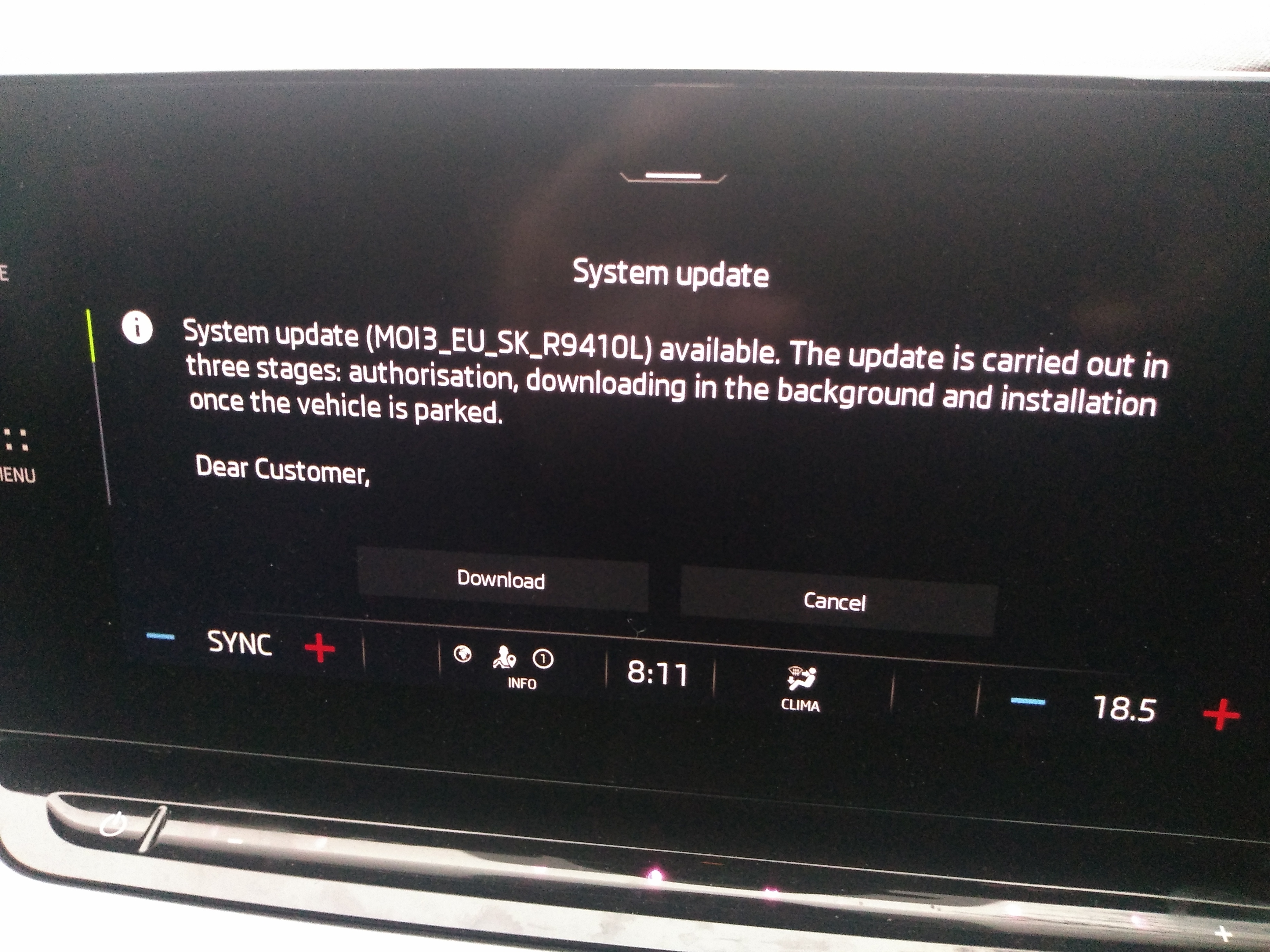

Got mine, it's update this morning it's. just installing 1941 now, waiting for it to download.
UK.  Old version was  1898 👍😁

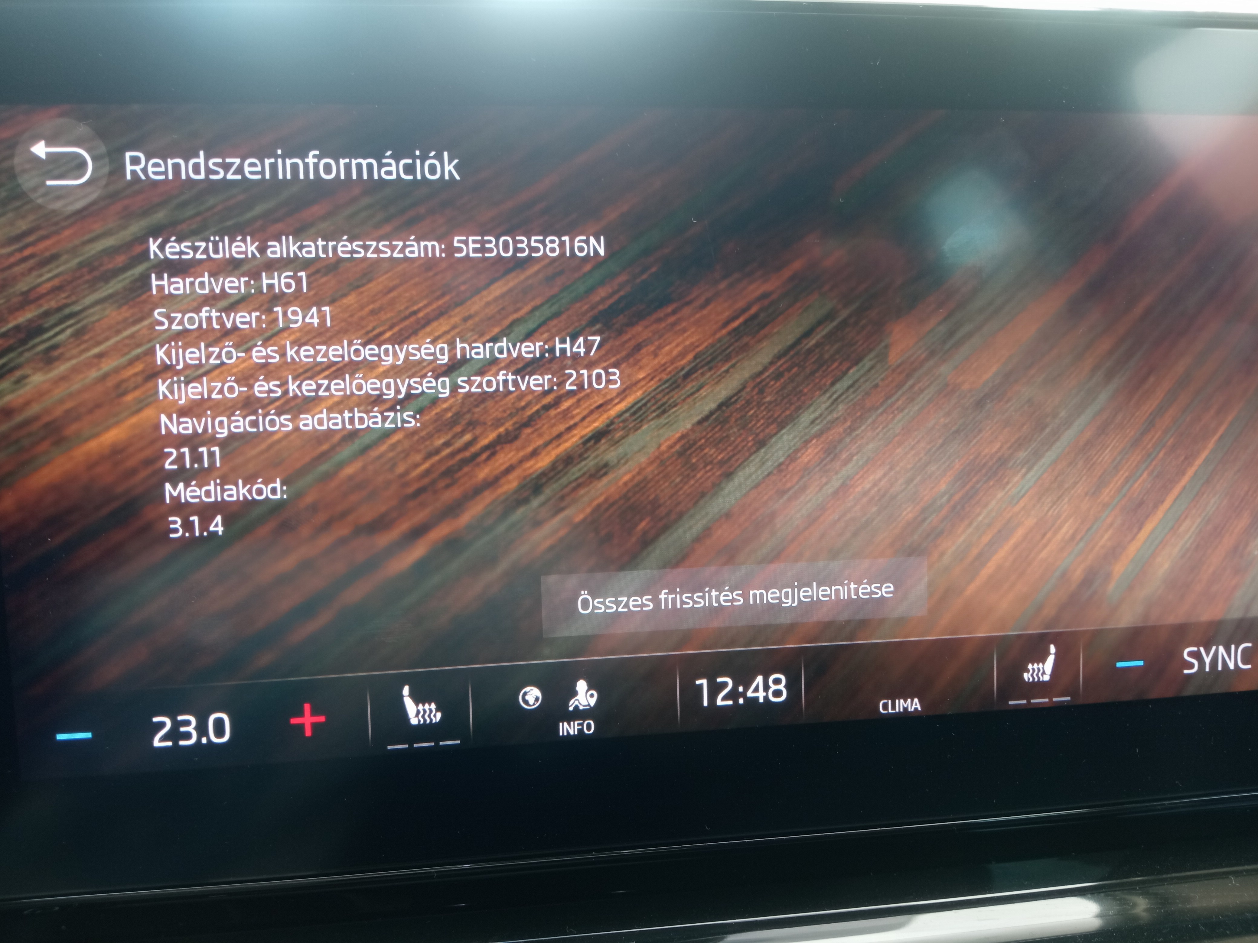

So after week of driving no more reboots!!! The 1941 update worked for me thx all!

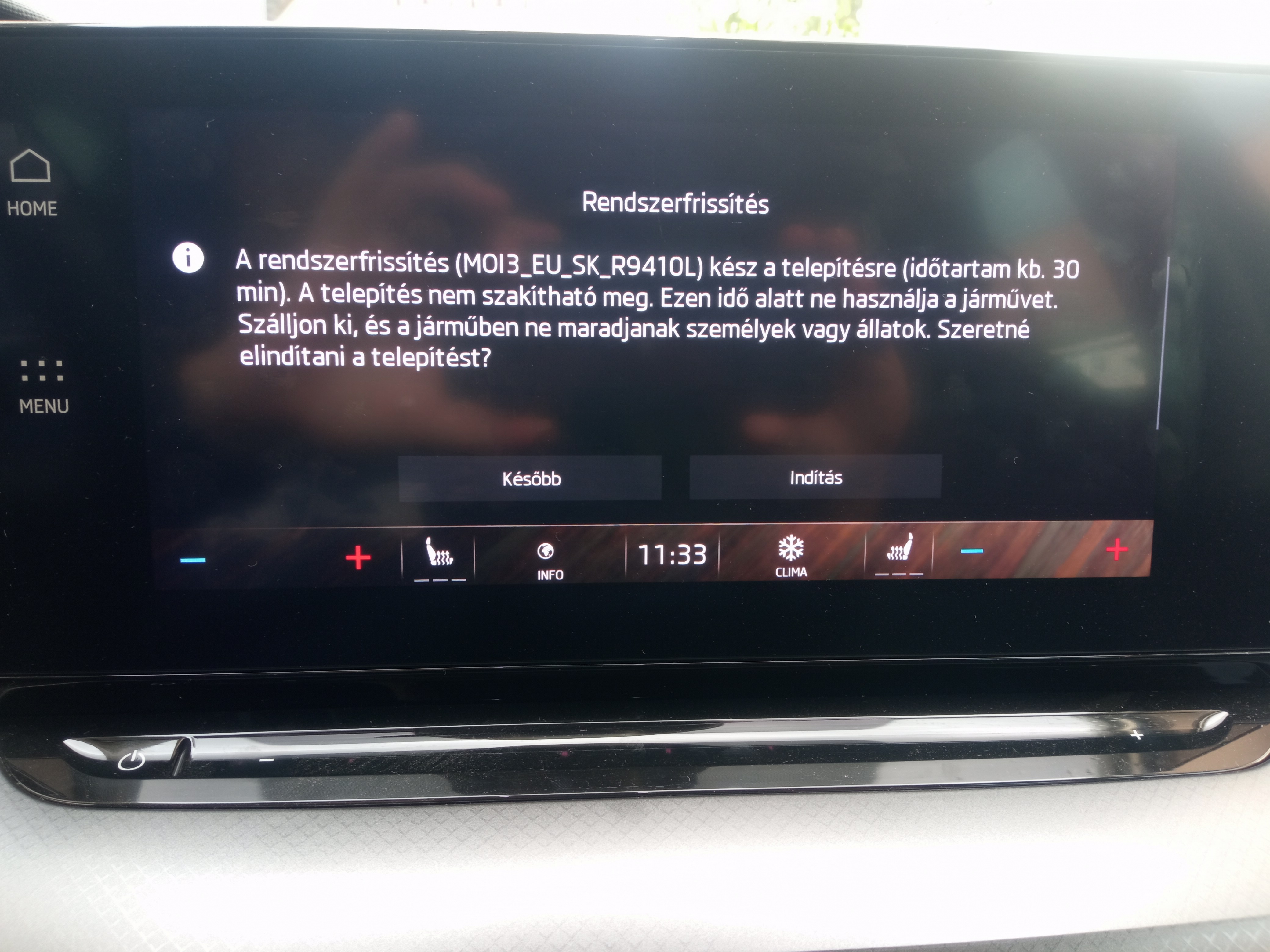

Hello!  I have an appointment for the update on November 7th!  Downloaded it by itself today and installed it in 15 minutes!  Haven't tried it yet, but I'll give it a try!
Good, you can cancel the dealer appointment now then and save some money 💰
