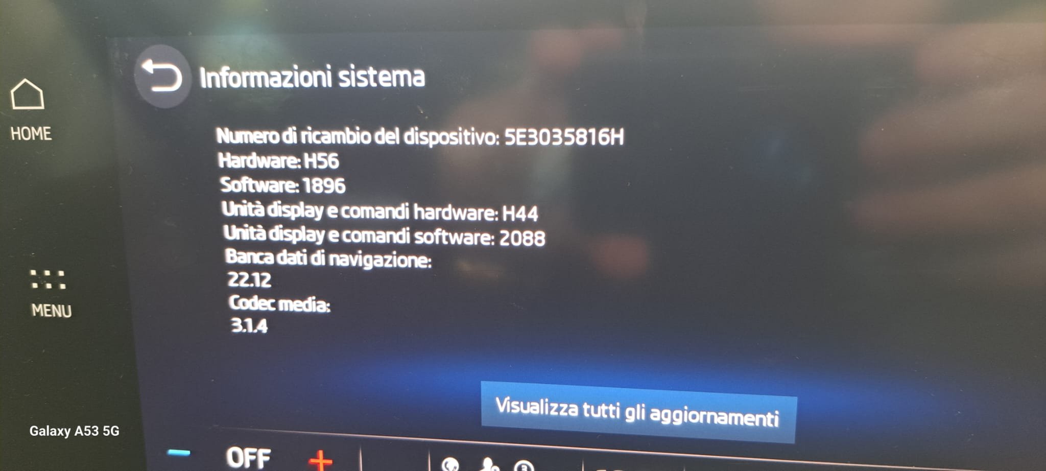

Good evening everyone, I'm a new member. I apologize for the English. I have the reboot problem. May I have the link to download 1941 and the procedure to upload it. Thank you

Thank you. I found the link on the forum. But there are 2 files with the number 1941. The first only 1941, the second file has an extension SK20230615S. Which one should I use? What's the difference?
The file with 1941 without extension is corrupted. I tried to download it three times, but I always got an error.
The file with 1941 extension SK20230615S was downloaded successfully
The file with 1941 with extension SK20230615S is suitable for updating. The software data is that of the photo

I see you have the same software as I do 1896 & 2008. Skoda UK told me yesterday that I have the latest software. PoloPaul says 1941 is required. My car goes into the workshop tomorrow. I will see what they say.
Skoda Italia told me that I have to have the update via OTA to the 1941. It appears as a recall but that they don't carry it out in the workshop. It's been 4 months but I've only had small updates
