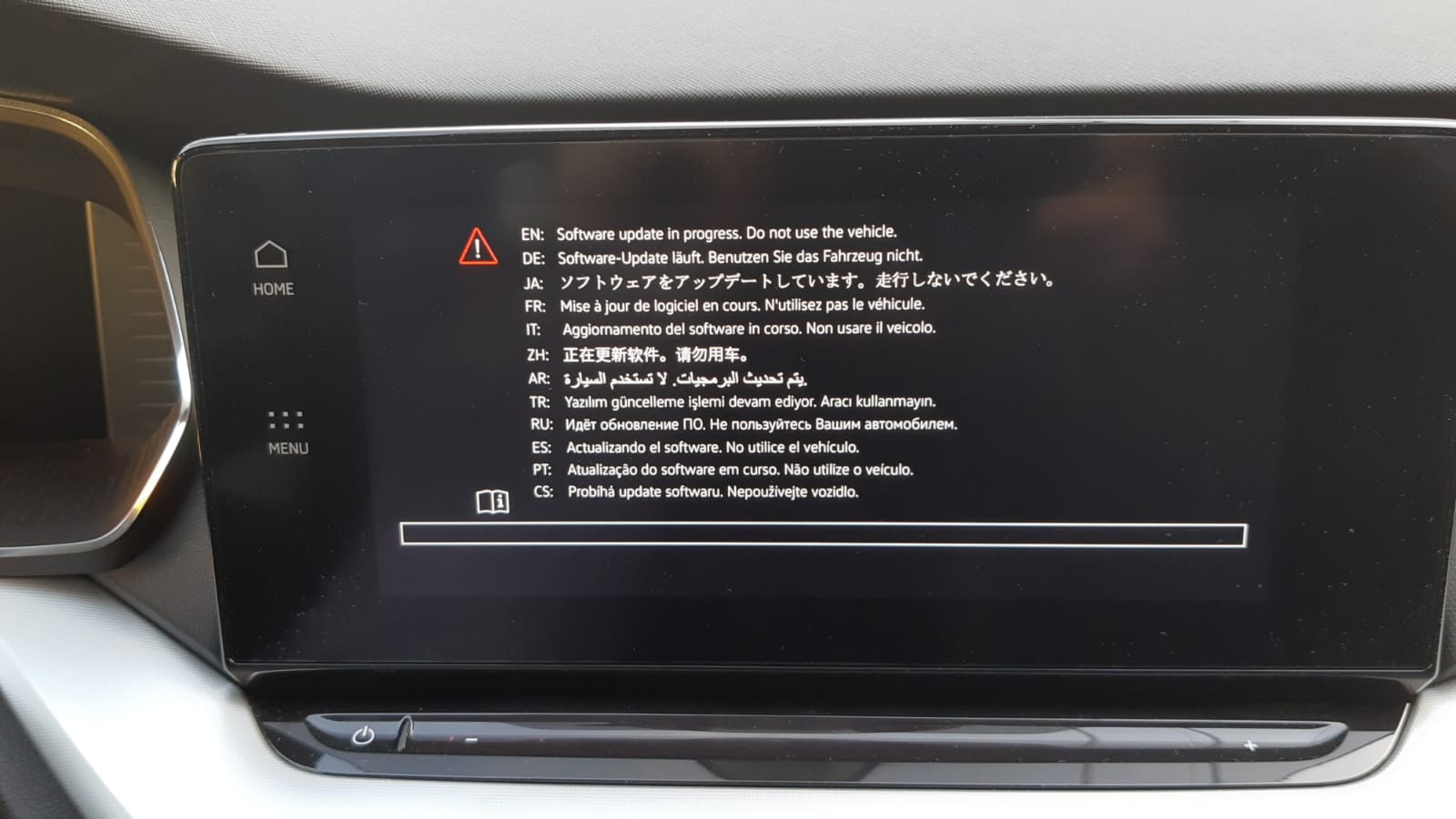

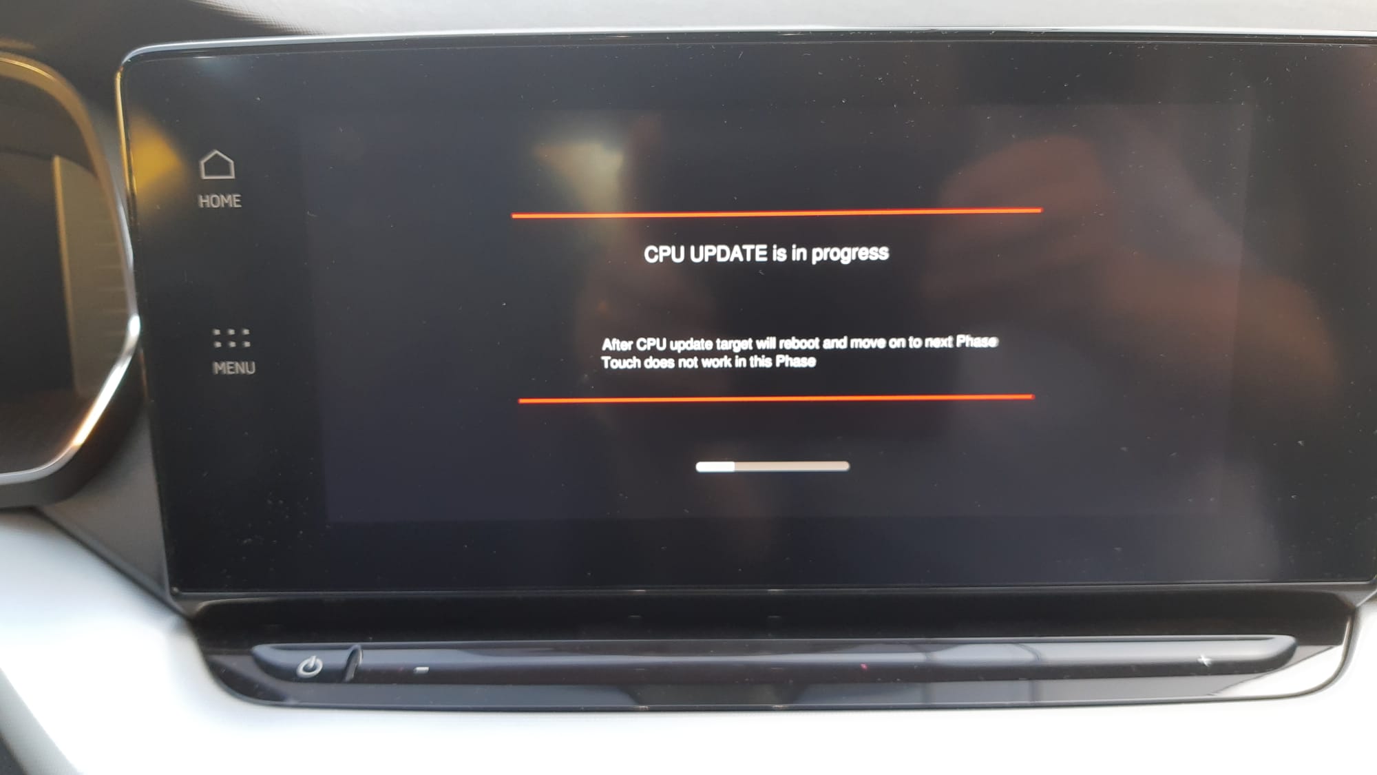

  • I had so many spontaneous reboots this week with even 4 occurring on the same day that the infotainment system was practically unusable. That’s why I decided to go ahead and install 1941 yesterday.

If you're careful and follow the instructions to the letter then you'll be fine.

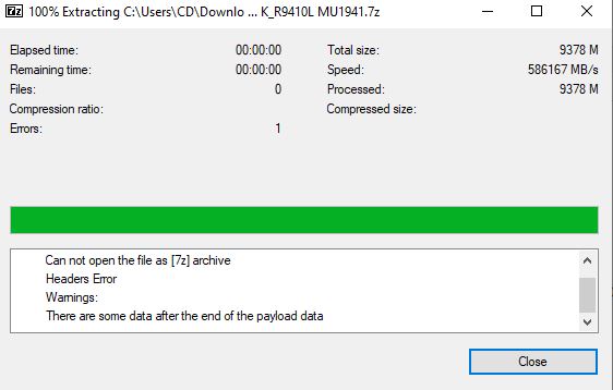

So i  got the webpages with the software. Much thx for that.
Download is taking very long and often interrupted.
Finally got the file only when i decompres the file i got header errors. Anyone a idea what is wrong or do i do wrong.  Trying other download but came with the same error.
Please make sure you download the file named MOI3_EU_SK_R9410L MU1941_SK20230615S.7z.
Got the car today - 1941 installed. Will report in a few days if it fixed the glitch.
Thanks all for the help. Today did the update 1941 installed also i report back after few days.
Same here got the 1941 installed , so far so good . It is a very good car when the system is working !

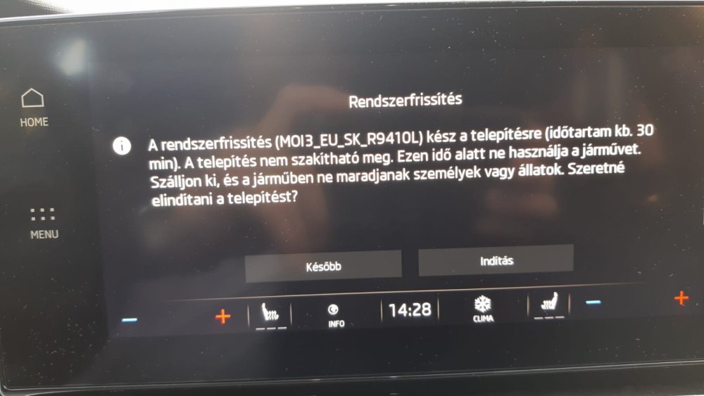

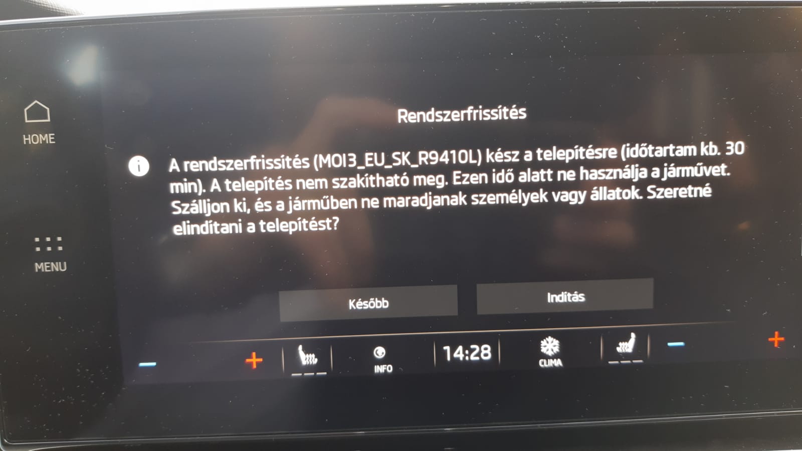

on 18th October 2023 I officially received the 1941 update via OTA (previous version 1900).
Dring the next few days 3 more small App and Manal update were performed.
Best regards, WiZi

Based on the information that I've found on the German forum, only those cars with MIB 3, Hardware Version H61, Software Version 1900 will receive OTA update to v1941.

Szia ! Egy olyan kérdésem lenne, hogy bejelentetted a szervizben a hibát és úgy küldték rá a frissítést vagy automatikusan jött?
Szia, minden automatikusan történt minden bejelentés nélkül, csak sokat kellet várni rá 🙂. Az autót 05/2023-ban gyártották.
