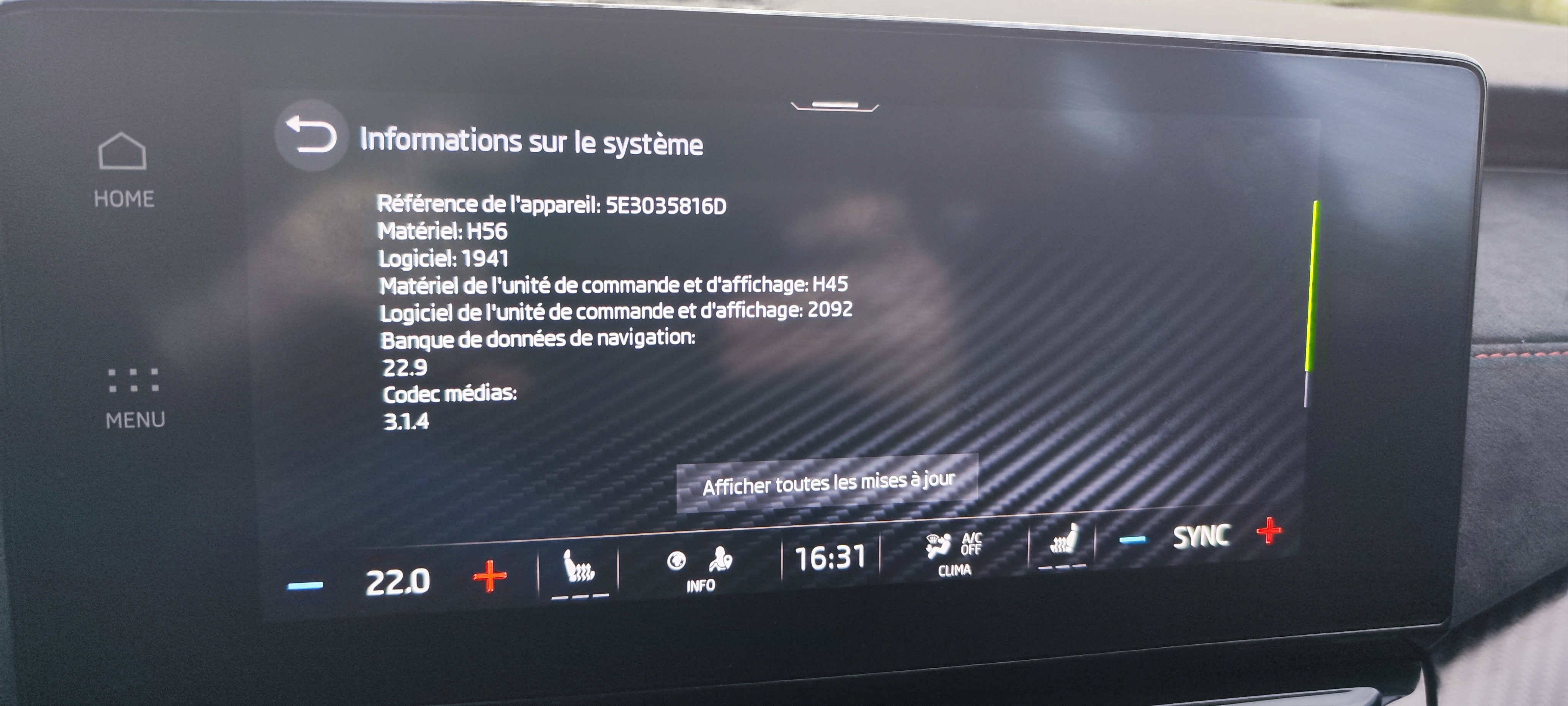

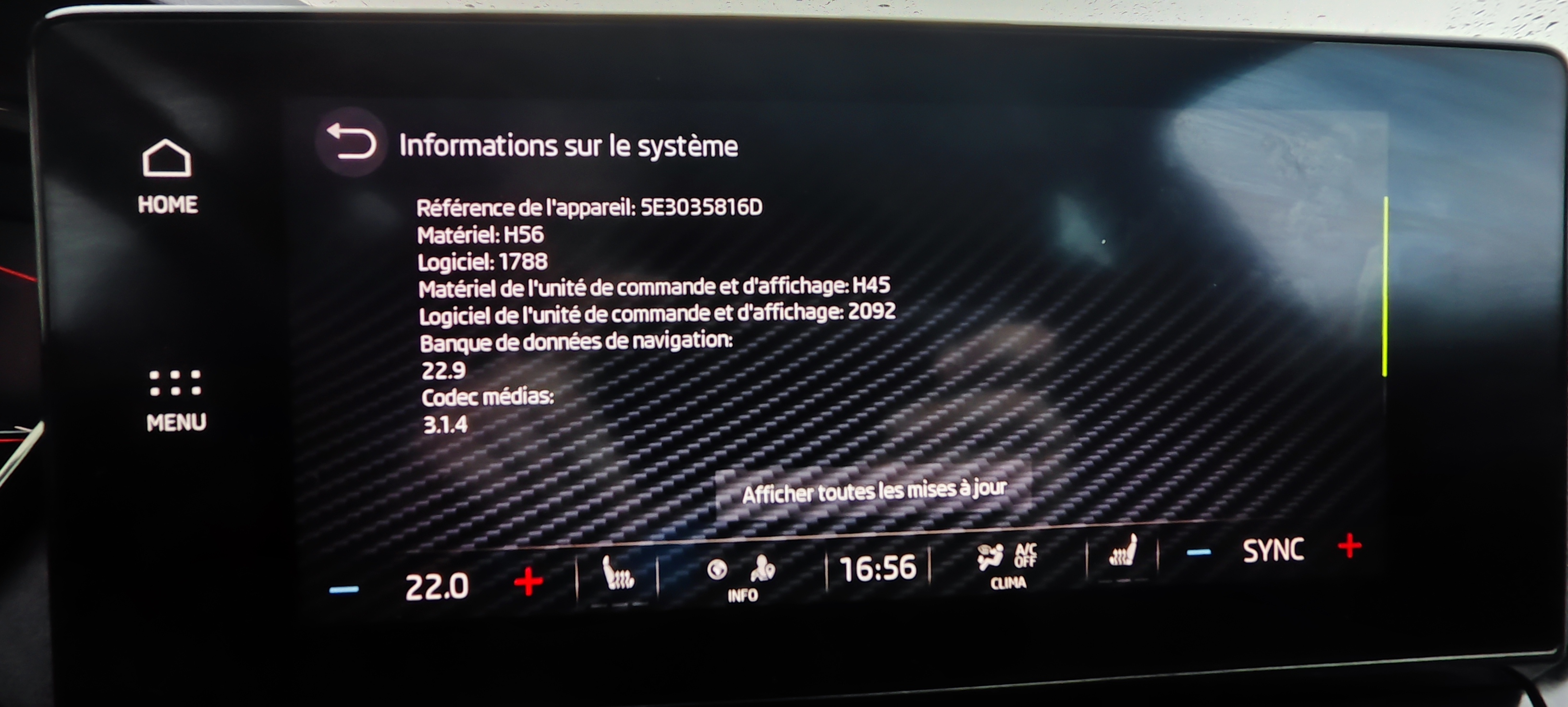

Thanks is it the MOI3_EU_SK_R9410L MU1941_SK20230615S? Because i update 1788 to 1941

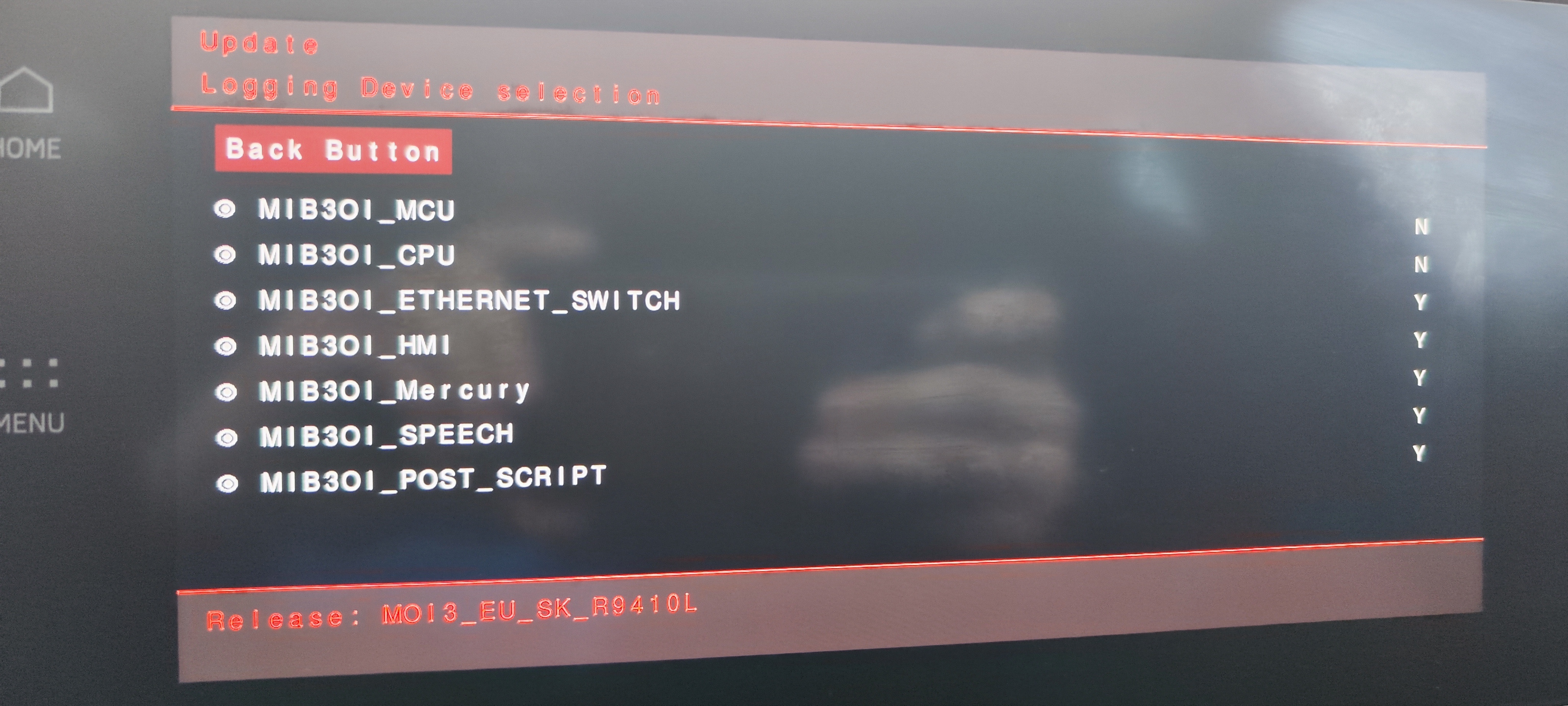

really thanks for help but this N at CPU and CPU is good? have you the same?
after this interrogation i have this before and this after
That's probably OK because the first modules are already up to date so the updater will skip them.
