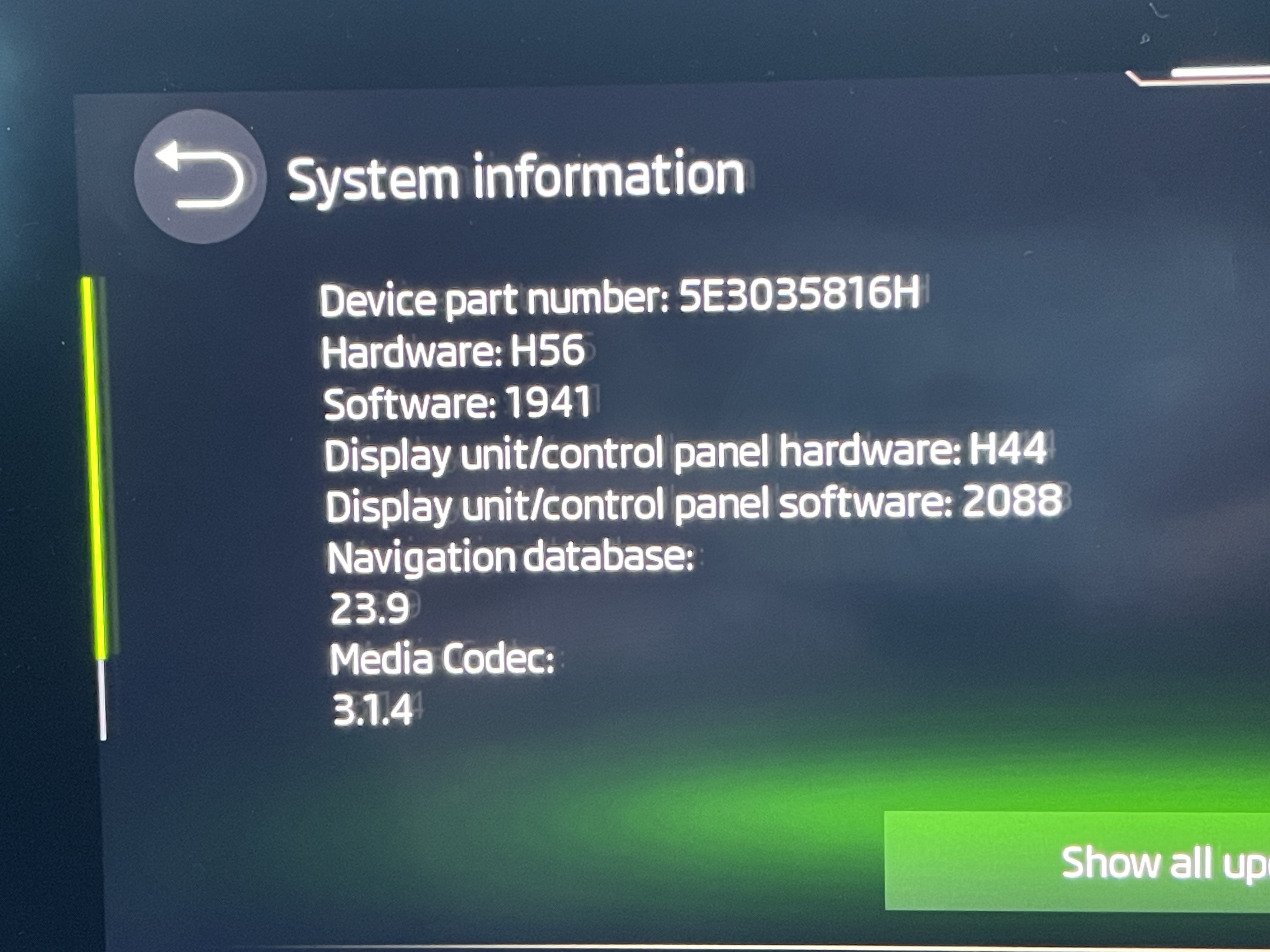

  • I had so many spontaneous reboots this week with even 4 occurring on the same day that the infotainment system was practically unusable. That’s why I decided to go ahead and install 1941 yesterday.

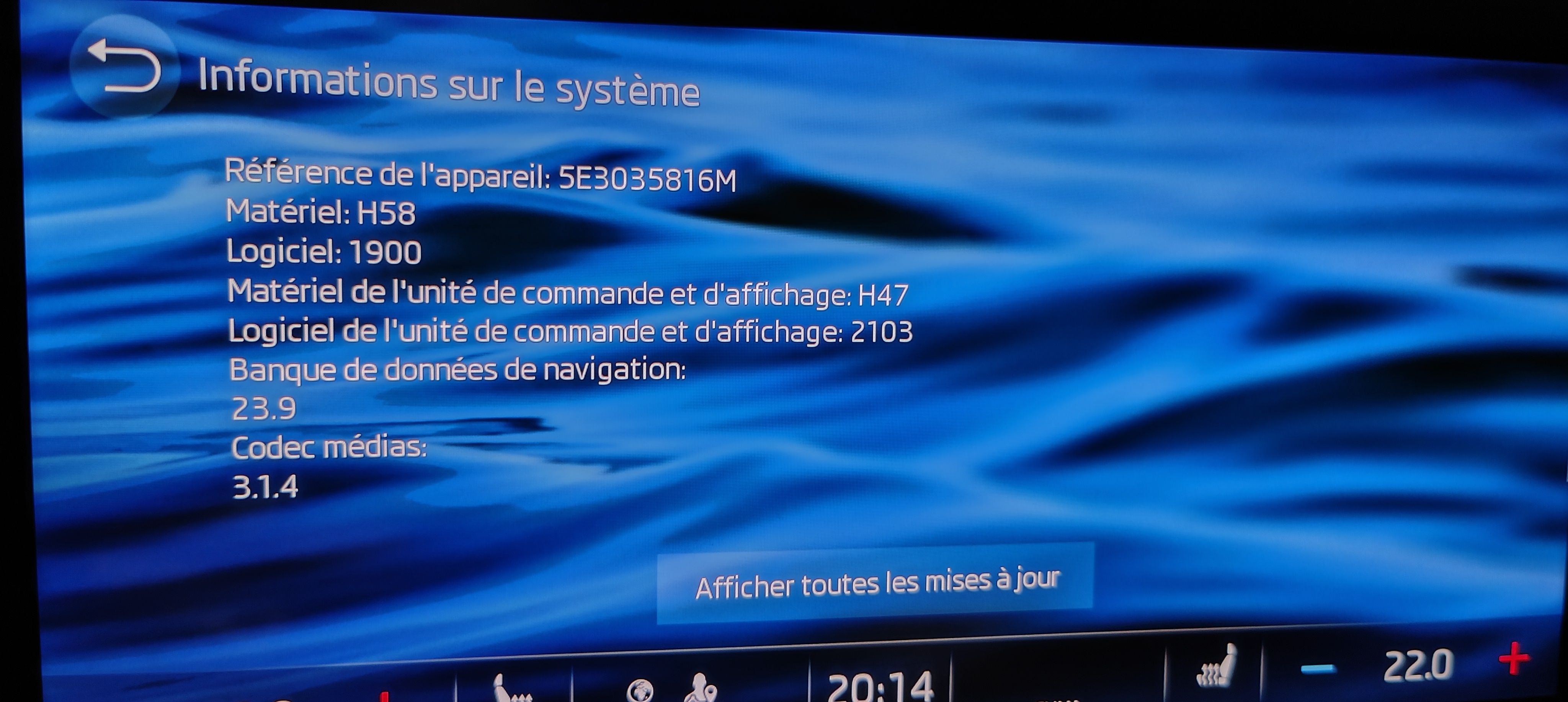

Hi all, I am french and i have few problem with infotainment
is it possible to upgrade from 1900 to 1941 ?
Thanks all
Oui, vous pouvez. Suivez exactement le guide que j'ai fait à la page 26 de ce fil (Traduction via Google)

On 24/09/2023 at 13:35, Jorgeminator said:

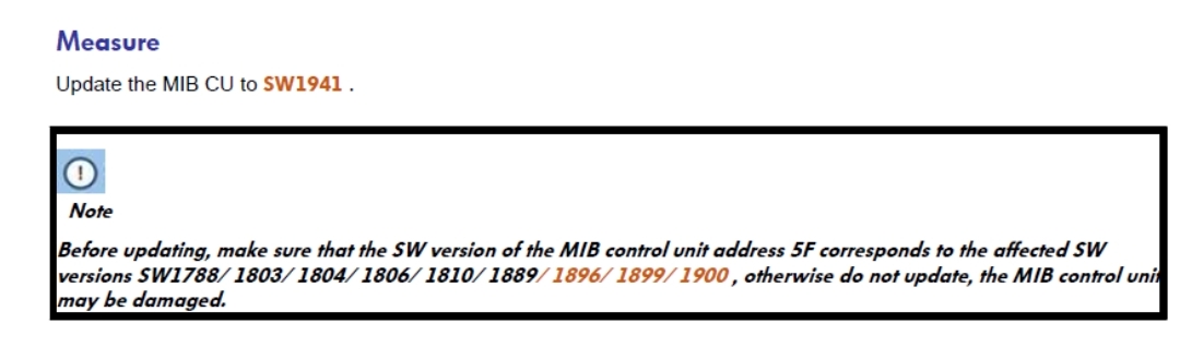

Should be direct upgrade.
Screenshot_2023-09-24-15-33-49-947_com.android.chrome-edit.thumb.jpg.4355eb879bea78efe6dbf07c93947230.jpg
I am SW1898, is it safe to upgrade to SW1941
Thank you Sir

Well, after carrying out the latest OTA software update I’ve found that the infotainment system is rebooting more and more often and now Apple CarPlay isn’t working properly.
I’m on software 1900 and whilst I could update to 1941 myself as per this thread I’ve booked it into the dealer to do it as a) I don’t trust myself not to **** it up, b) it’s a company car and I don’t trust myself not **** it up, and c) the car is two months old and Skoda can ****ing fix it for me I feel. Also they can look into the fact the ****ing boot keeps opening itself.

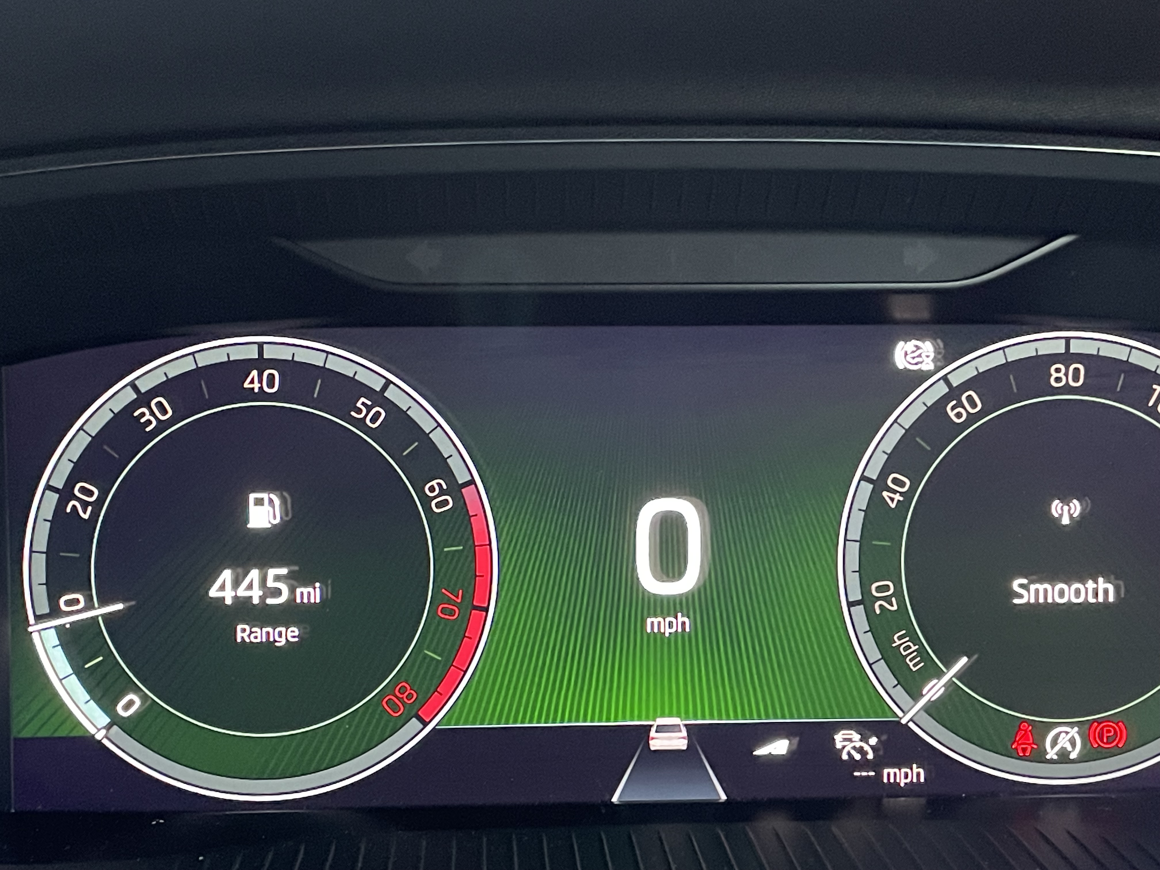

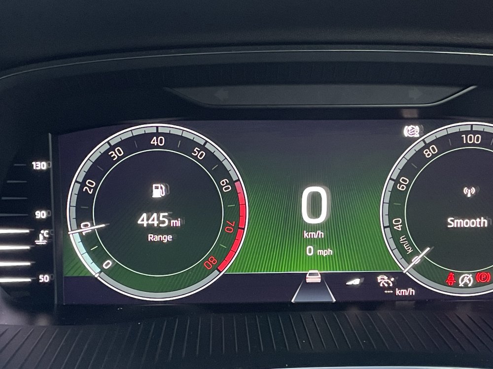

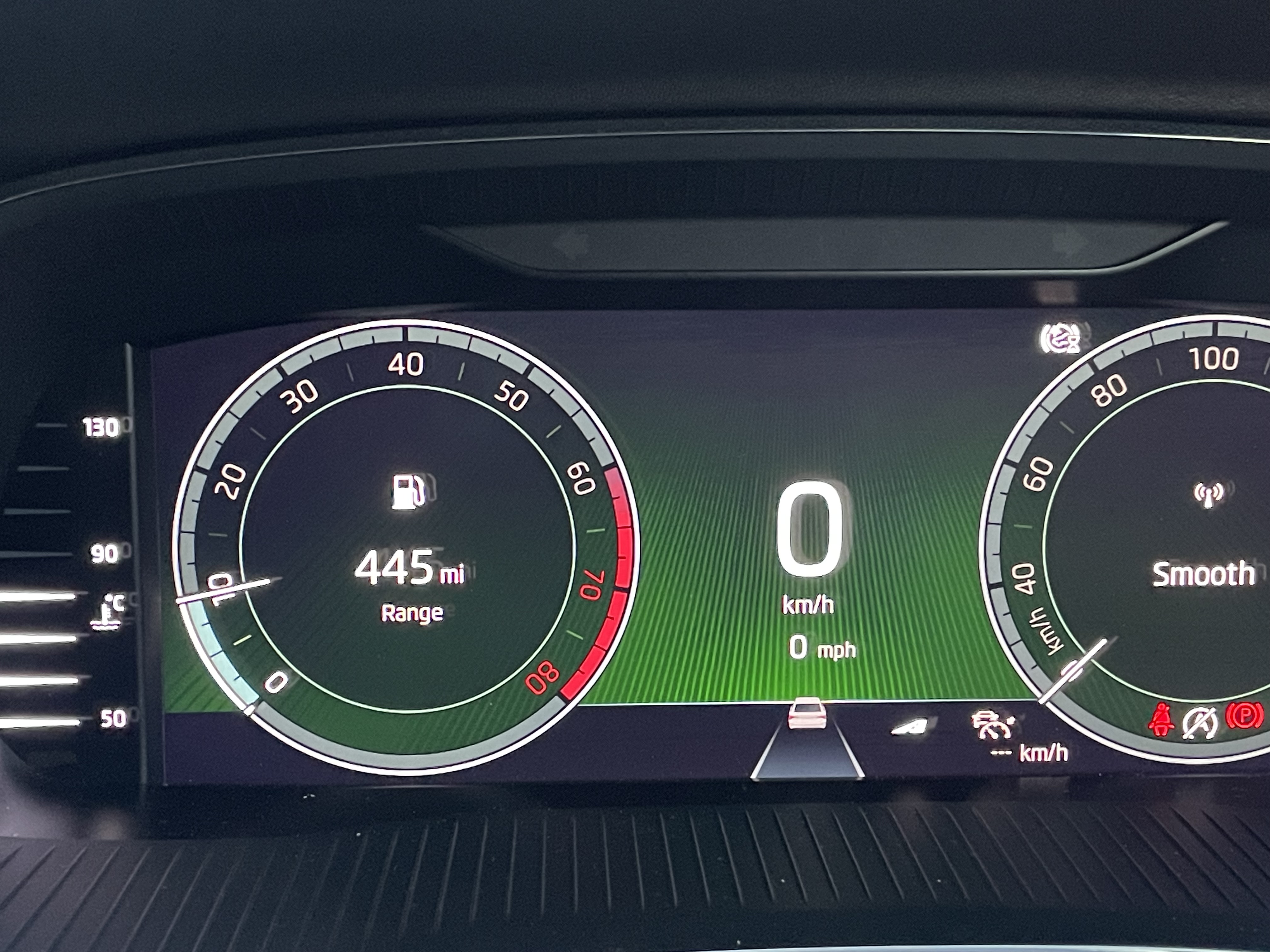

I’ve just had a new MIB fitted on 2020 First Edition, it was supplied with old 1668 software installed, the dealer has today done all the updates required and I now have 1941 installed. I mentioned to the dealer that the kmh/ mph issue has never been resolved. Upon completion of installing 1941 they have installed a further update and I now have a fully working car. Sat nav is now in miles and yards and I can now display kmh and mph on the virtual cockpit. So for anyone who never had the new digital cockpit fitted on the early cars,there is now a software fix. Hopefully this  will be a game changer now and all works ok.
Can you share this picture of new digital cockpit?
IMG_4893.thumb.jpeg.2d9b14e8314ba9620c9a7d8ee46f5b5b.jpegIMG_4894.thumb.jpeg.e5fd0e48552fdcdcab690d668bc350ed.jpeg
