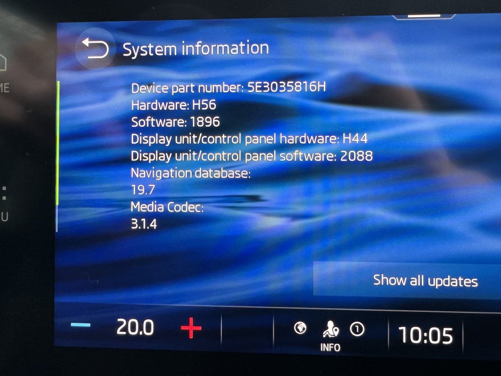

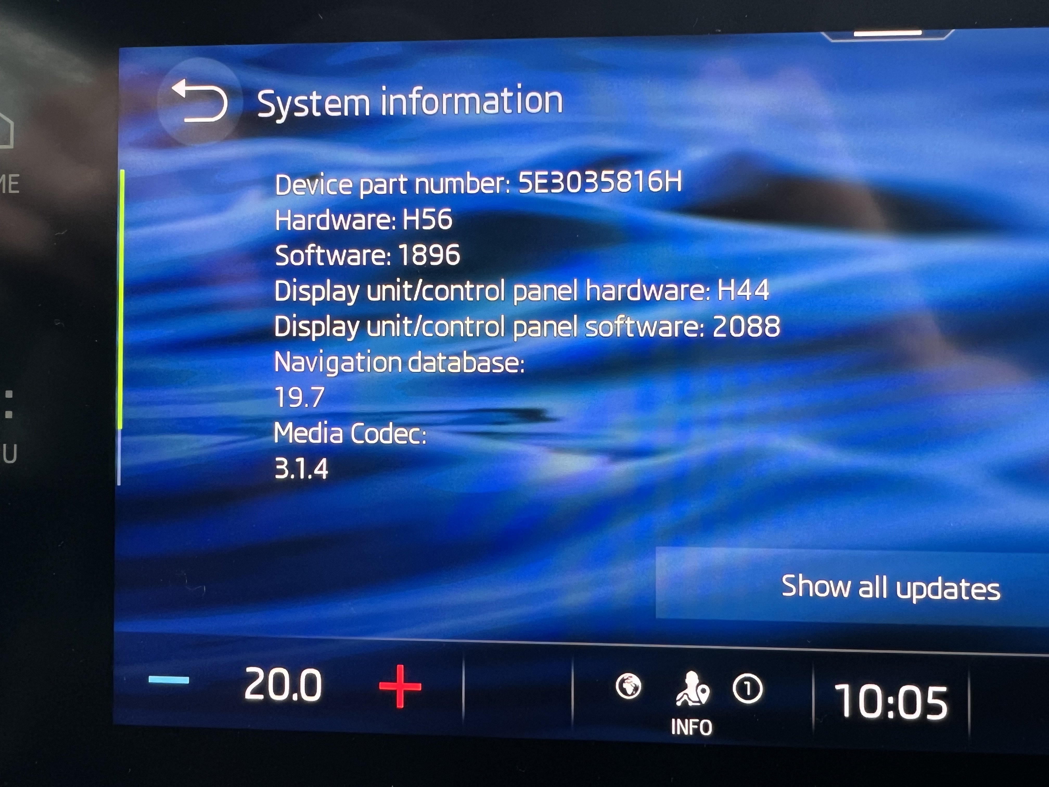

I'm still waiting and nothing is showing:
I’m currently on H56 and 1896 with H44 and 2088 for the display unit software.
Nothing in the notifications tab at the top of the screen?
I got the message again today about the 1941 update. It never happened and nothing in notifications about it.
