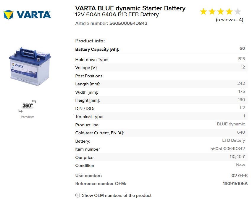

You have the 027EFB Size as seen here
You can see at the bottom of the image, that it matches your OEM number 1S0 915 105A
Tanya is one of the cheapest and fastest suppliers in the UK, and they pack those batteries very well.
Varta is a common OEM supplied from factory, and Bosch are made in the same factory.
https://www.tayna.co.uk/car-batteries/types/027-efb/
You can input your Reg to filter if you like, and be sure to measure up existing fitted battery to make sure my work is accurate before you purchase.
