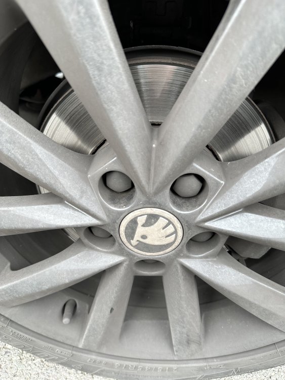

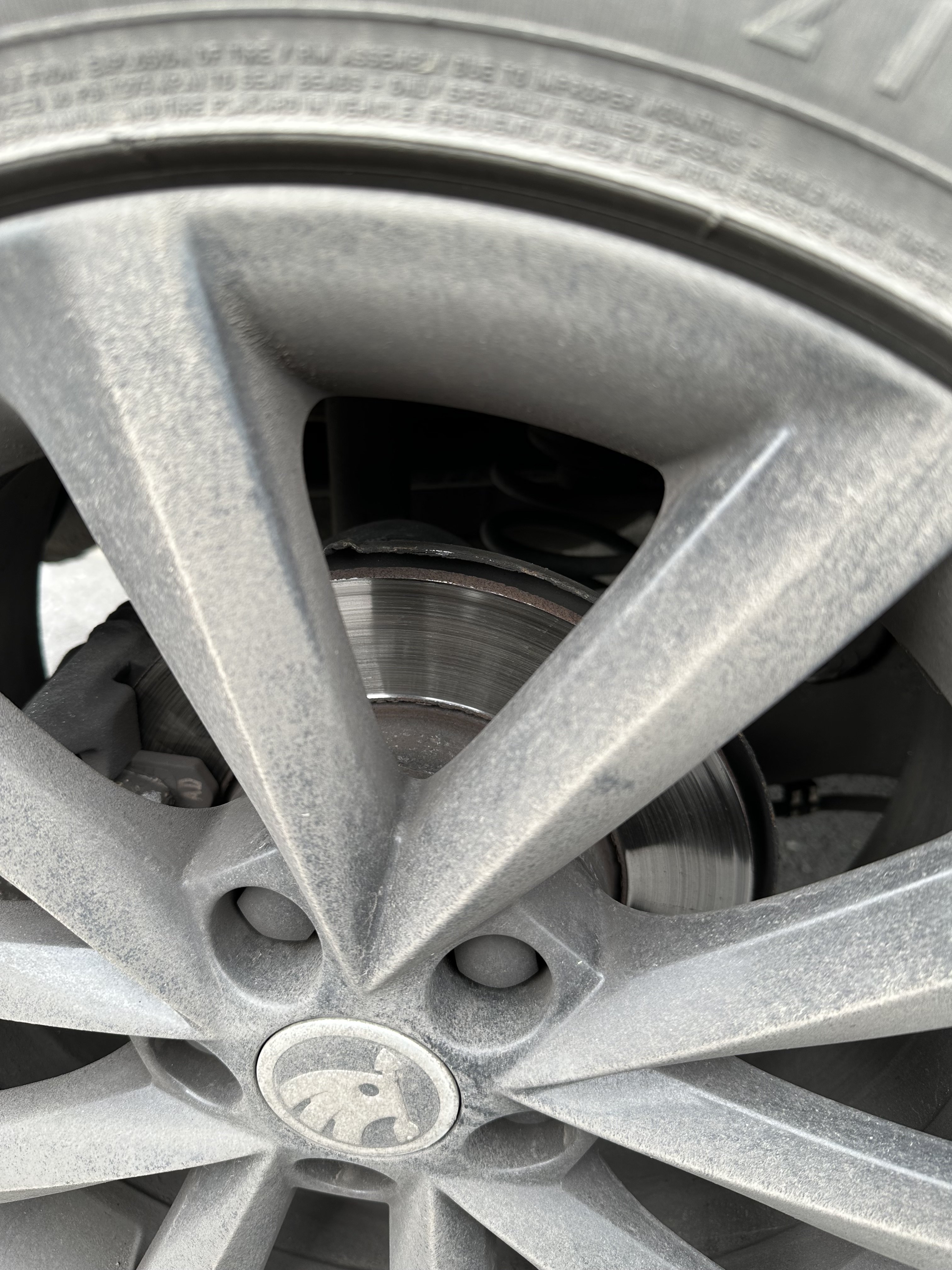

Couldn't find anything relating to this so thought I'd ask..... Our 2019 Colour Edition had it's first MOT and got an advisory for brake pads wearing low all round. The car has currently done 26,000 miles.... Anyway I asked for a quote and he gave me a price for pads AND discs all round when I quickly asked about whether it needed discs too he said they recommend replacing them with pads. It's not something I've done on such a low mileage car previously and have only had discs and pads done together on a vehicle I've owned when they have been much higher mileage and the discs had done more miles so my question is whether this sounds right or if I should really be looking at just the pads this time around? This is from my usual VAG specialist who I've never had reason to question before but this seemed strange to me on a car with this many miles?
I've attached a couple of pics of the front and rear discs in case they provide any extra benefit in responses.

Hi, the usual stealer BS I'm afraid. Provided the discs are not excessively lipped or have too much run-out, they are ok to reuse.
I mean, no pads dont always need to be replaced with discs.
But, there are a huge amount of factors that determine if 1. the discs need replacing now, 2. will the discs last for the next set of pads or near enough.
Many factors come into it including thickness, lips, grooves, heat marks, corrosion, contamination, damage.
All of these need to come into account.
The first picture its hard to tell but looks like the surface is grooved in lots of places, the second looks like it has a bit of wear on the thickness but cant tell without measuring.
You need to ask whoever is doing the work to prove the discs are required by measuring and comparing to the specification and also a qualified visual inspection.

I wouldn't be replacing those discs based on your photos.

If I had to pay the dealer to change the discs and pads it might make me think twice but I have tried skimping out before only for corrosion to set in soon after or have problems with uneven wear or juddering, especially where the front is concerned, needless to say I replace discs with pads every time to save myself potential problems.
I'm sure you could just put pads on and you will probably be fine but I don't like the look of the first photo, looks like the disc has worn unevenly across the surface.

 The rings of colour around the disc, a mint disc will look uniform like it just came out of the box.
obviously it’s a photo and I can’t feel the disc so it might just look worse than it is.

How much meat is left on the pads as the shadow on the photo doesn’t suggest they’re worn in the second picture (but you can’t tell from a picture so they might be worn)?

So many people here giving their opinion based on a photo of the outside face of a disc.
You cant see thickness, the inside face, any leaks in the caliper contaminating the disc/pad, cracks/splits.
Saying to someone a safety critical component is okay from a single picture is not the best thing to do in my opinion when you cant physically see it and inspect it.
And in all fairness it makes you no better than the person on the service desk in a main dealer who says yes that needs changing without all the facts or information in front of them.
The chances of any of the above being wrong are slim, but I still wouldnt be saying yes they are okay from a photo.
Correct. Not that you can see that anyway unless you remove the discs because disc shields in both photos.
