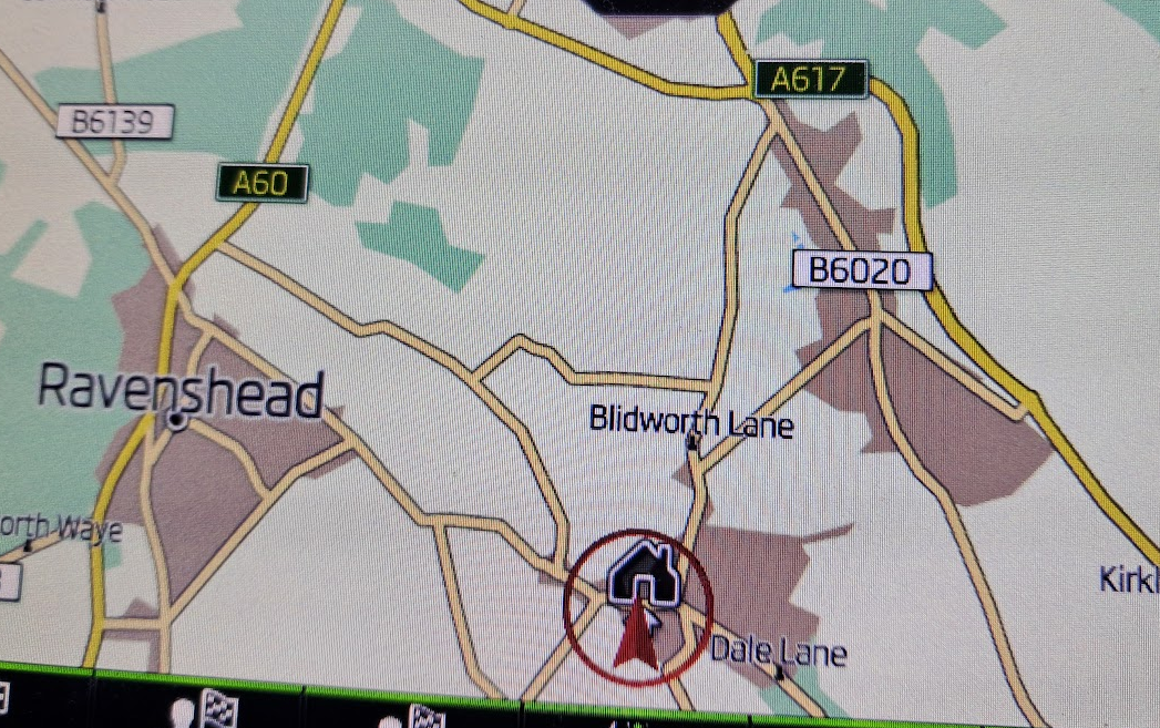

I've just loaded installed  STD2_2110_EU1_202345 into my 2015 Octavia Scout - it seems to work OK, but many of the village names are still disappearing  - is this a problem others are having,
The last time I updated was in 2020, and I had the same problem to reverted to the 2017 maps which worked.
Any help would be appreciated?
I have come across people moaning about location names on the maps. It remained unresolved. I put them onto the TomTom reporting site and they didn't resolve anything. Reckon the TomTom map screens can change names of roads but not district names if you see what I mean. So they drew a blank.
You register for an account, but as I said the validation team get stuck with that type of thing. It's called TomTom Mapshare for feedback.
https://www.google.com/url?sa=t&source=web&rct=j&opi=89978449&url=https://www.tomtom.com/mapshare/tools/new/mapshare/&ved=2ahUKEwj_8YGWjpiFAxXnQEEAHe45AvoQFnoECAcQAQ&usg=AOvVaw0qu-5giOB7e63In0V6ug7e
Suspect 2017 maps are Here Maps origin and these are definitely TomTom, so it's the cartography and how it's set up.
So does everyone now just live with SatNavs  with no village names?

All I was really asking was - is there any way I can get my Amundsen satnav to display village names on the latest maps by some sort of software upgrade - knowing the way Skoda operate - I suspect the answer is no?

I am still unsure if other people are having this issue, can people see Blidworth, Notts named on their maps - the village is there?

The map version number looks different to what I have, which I assume is ECE 1 2024:
I downloaded this from:
And this is the mapping I am getting, as you can see, a name for Ravenshead, but  no village names for the two villages on the right (Blidworth and Rainworth), the villages are not labelled at any level of zoom
Is  ECE AS 2024 something different?

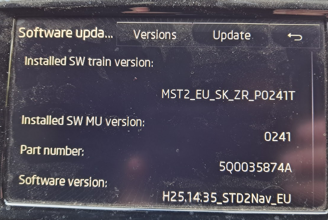

And these are the overall system settings.

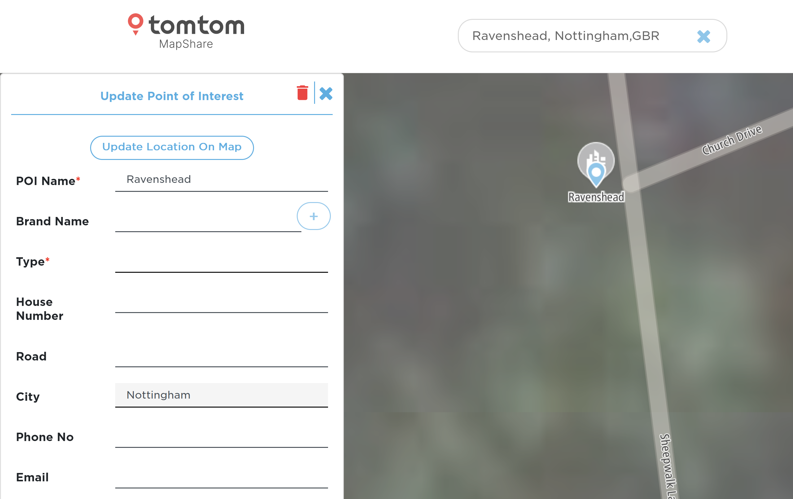

I thinks it's because the those villages aren't marked up as POIs. In TomTom Mapshare you find Ravenshead but not the villages so I'd say it's driven by that. Reckon it's needs a POI name and the City as the big city it is associated with. I was trying out some villages around Milton Keynes, and they are put as the City of Milton Keynes although not in it, but the POI name is the village and the postal address is MK. Everything else has to be blank. Trying out my local village which isn't in MK that is how it works.  Users of TomTom may have submitted them in the past or it was some POI file they got their hands on which was incomplete.
On the postal address
It goes
STREET
VILLAGE
CITY
VILLAGE is the POI name
CITY is the city name in the TomTom system.
If you put those in, in Mapshare, check they get accepted and wait for the files to be processed, about a year, you'd get them. Feel free to check out the rest. It's the same issue that came up before. Think we have got down to the bottom of it, this.
I will have a look at tomtom for interest, however the real reason I wanted village names is for when we are going on long trips - so not much use if I have know where I am going and have to add the names a year in advance😀
However that does not explain why Warrior193 is able to see them on Ver. 5L00051236DH - ECE AS 2024, which I think is the all Europe map:

An idea for you.
On your image. The actual serial map release is 2110 as MartiniB pointed out there is a newer one now. The code above that V... is the part number for the brand. It's all the same release for 2110, just when put it in the unit it will show the brand part number. Skoda, Seat, VW - that's that line. Traditionally we would define the map by that ECE code but a few years back they slipped a year or six months variation so the mib2 standard and mib2 high ones didn't tally. The ECEX, X being 1 in that map dates back to when they split out the maps by zone so they fitted a 16gb card. You can buy the 32gb to get all of Europe on.
Hand in hand with that map release is the V version code not shown but printed on the original card / box. 2110 is version 18. The main quotes for mib2 standard which is the 4 character code and the version code. Eyeballing the 2210 means it's not the most recent. Some people prefer to talk V codes rather than the seriel release xxxx.
Those village names appear to be driven by those POIs which give the location although the company that generates the files for Vag may be using a different file outside of TomTom for that.
