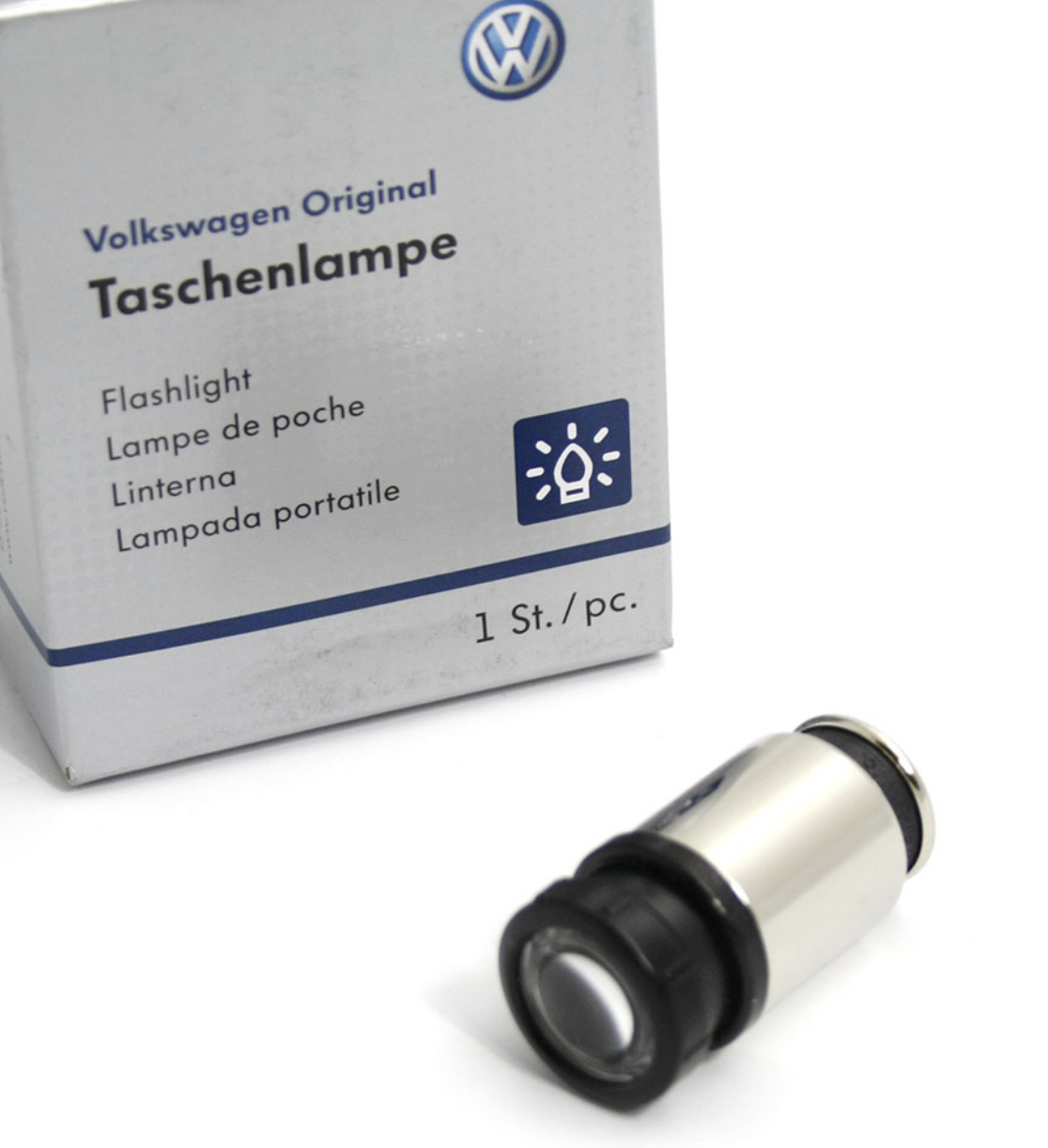

The reason I ask I have a small VW rechargeable torch permanently plugged into the socket and I obviously don’t want to damage anything or cause any electrical issues, so does anyone know for sure? Not much useful information in the handbook that I can find.

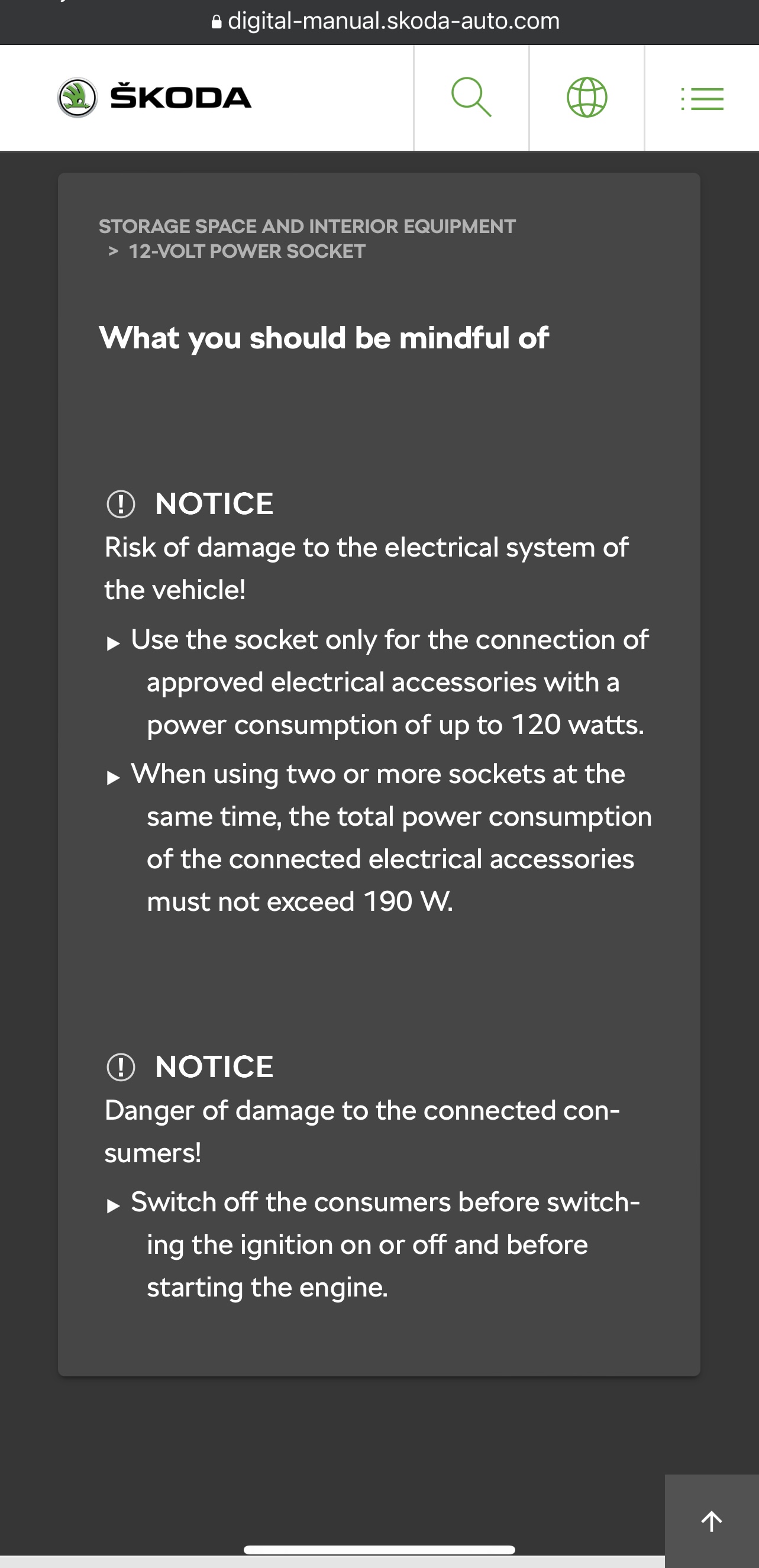

Thanks again for the replies, I must admit I like the idea of the socket being permanently live, I just wish that was made clear by Škoda either in the handbook or at the socket itself like some Jeep models do.
