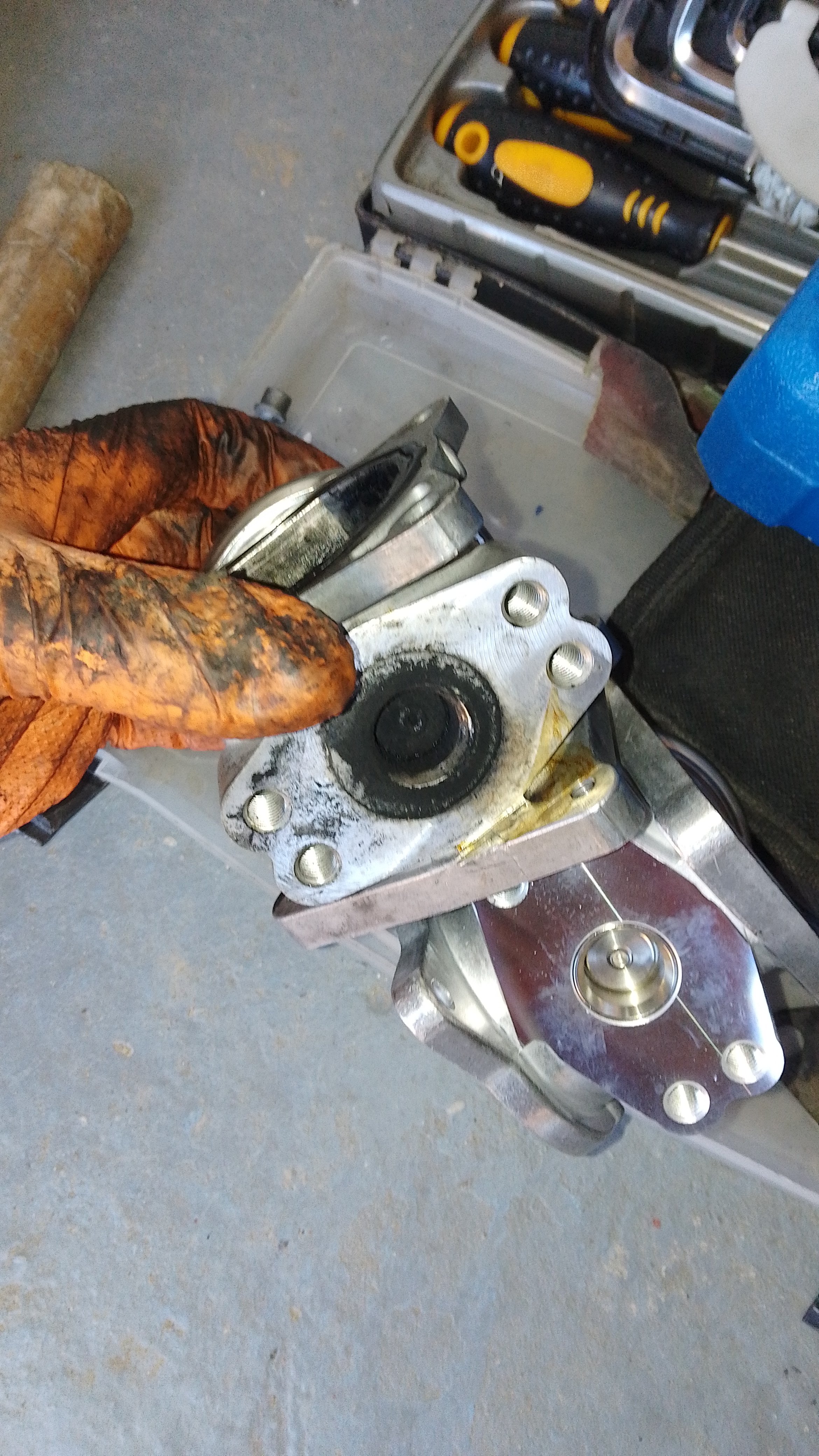

New EGR valve - sucking the vacuum hose hole on top pulls the valve up.
Old EGR off car - valve would not budge.
I couldn't move valve up from below with my finger, even with new EGR valve.
Old EGR valve, despite being clean, the valve sleeve is probably coked up and not possible to get in there to clean.
The Borg Warner EGR came with a gasket between the ASV and EGR I haven't had previously. I have the rubber o ring both sides of the EGR. The gasket is in addition to the o ring. Not there from new or in last EGR kit.
No leaks.
Photo shows coking under EGR valve that connects to metal Flexi that carries exhaust gas up into EGR Vs new EGR aside it.
