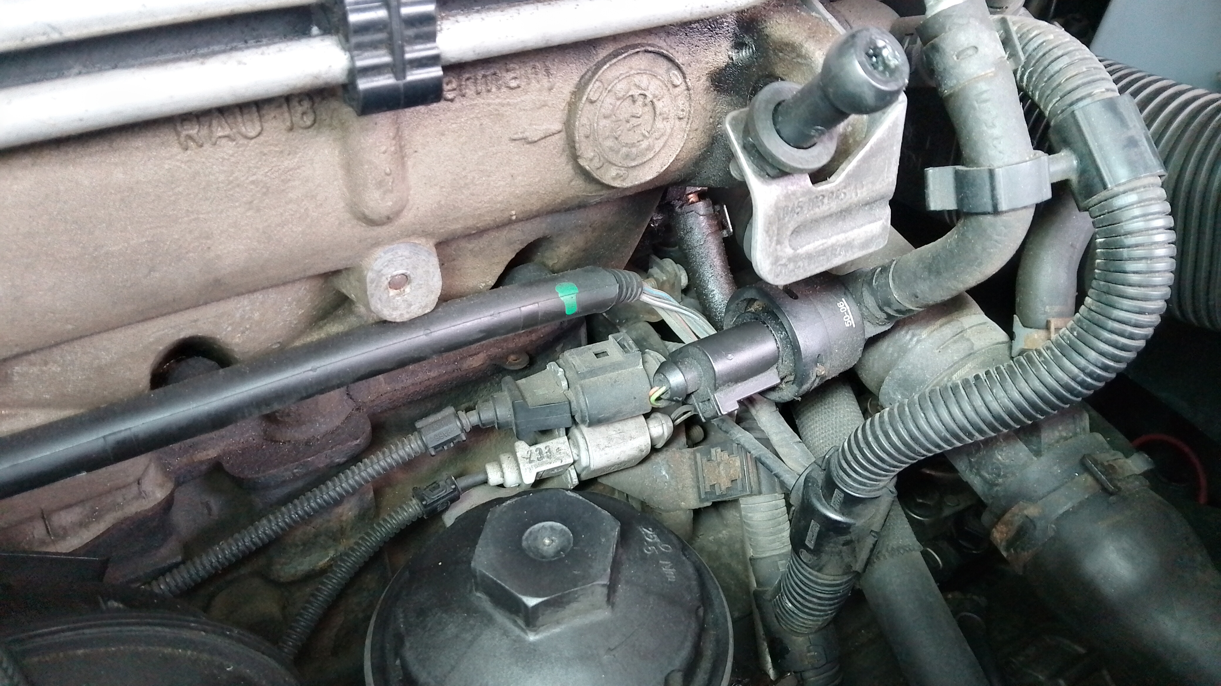

The fuel temperature sensor area , nearby there is what looks like a fuel pipe (metal aluminium tube) connected to rubber hose - looks damp, but could be oil from a previous change - between engine block and air box, or diesel? The sponge under engine cover has powdered (probably age and heat) so it got removed last night. Some of this stuck to said oil or diesel.

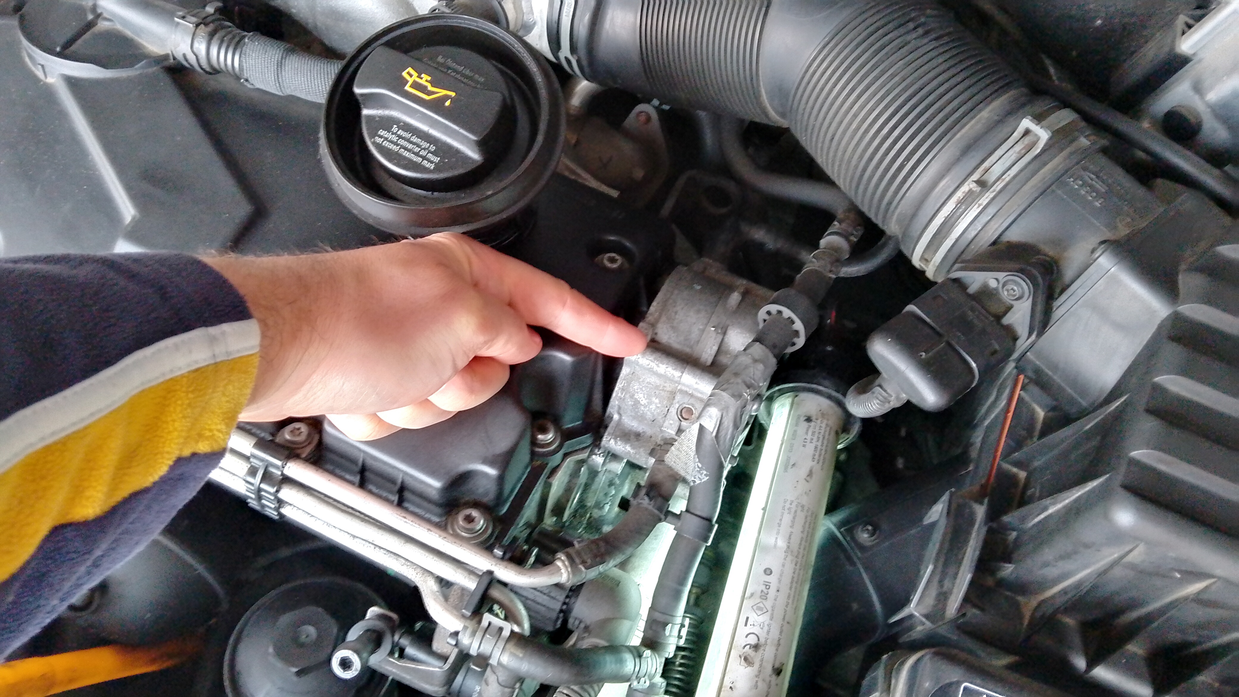

Is the aluminium block the fuel pump? My finger pointing to it.IMG_20230510_184510_HDR.thumb.jpg.7007f9dacee9aa2f4675f4e001b863cc.jpg

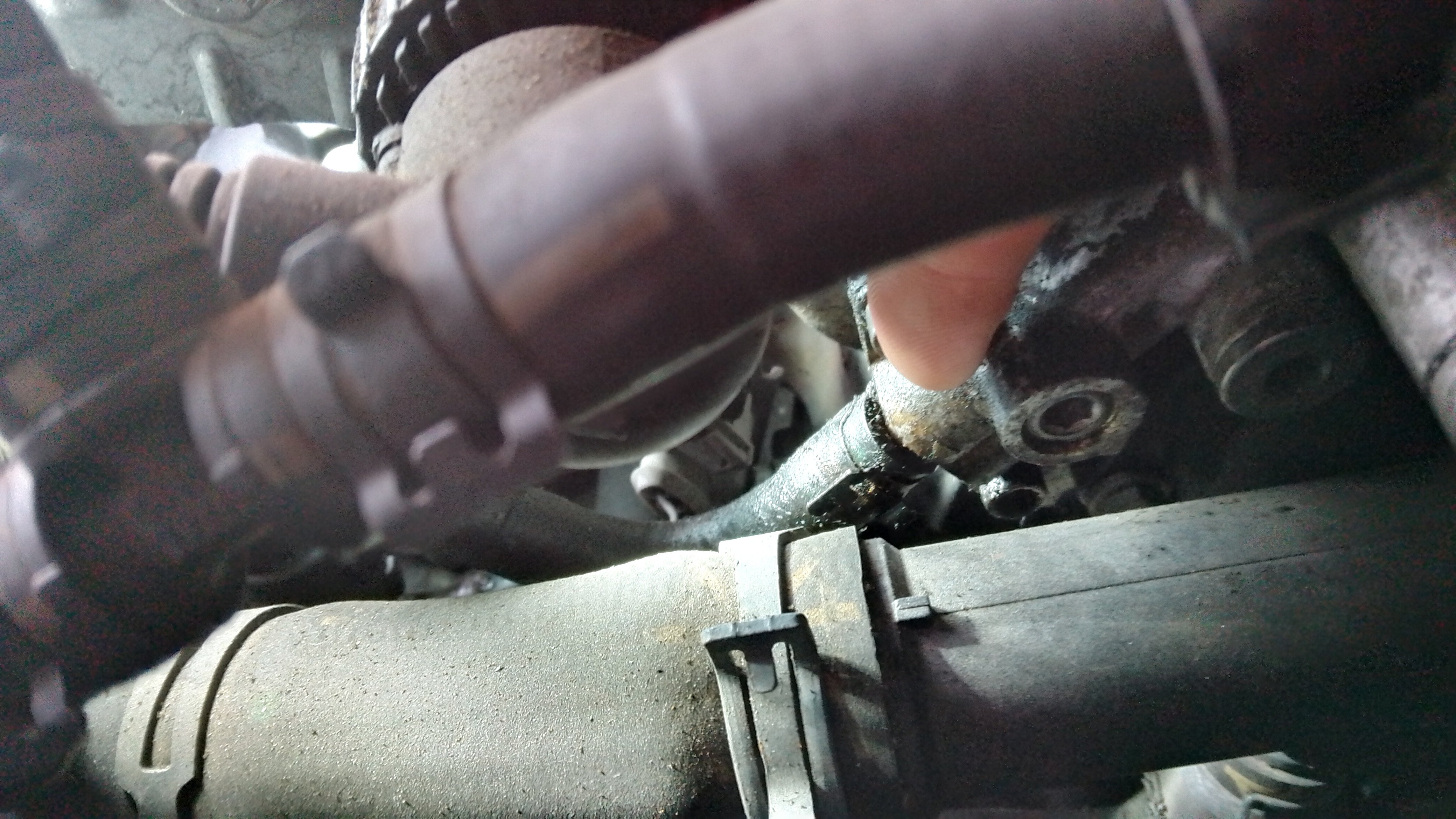

This is the leak, nothing to write home about though.
Is this the FTS? Centre right of photo?
  • Sponsor
Combined fuel pump and vacuum pump 'tandem pump' I think.
Yes, that's the fuel temp sensor, I reckon.

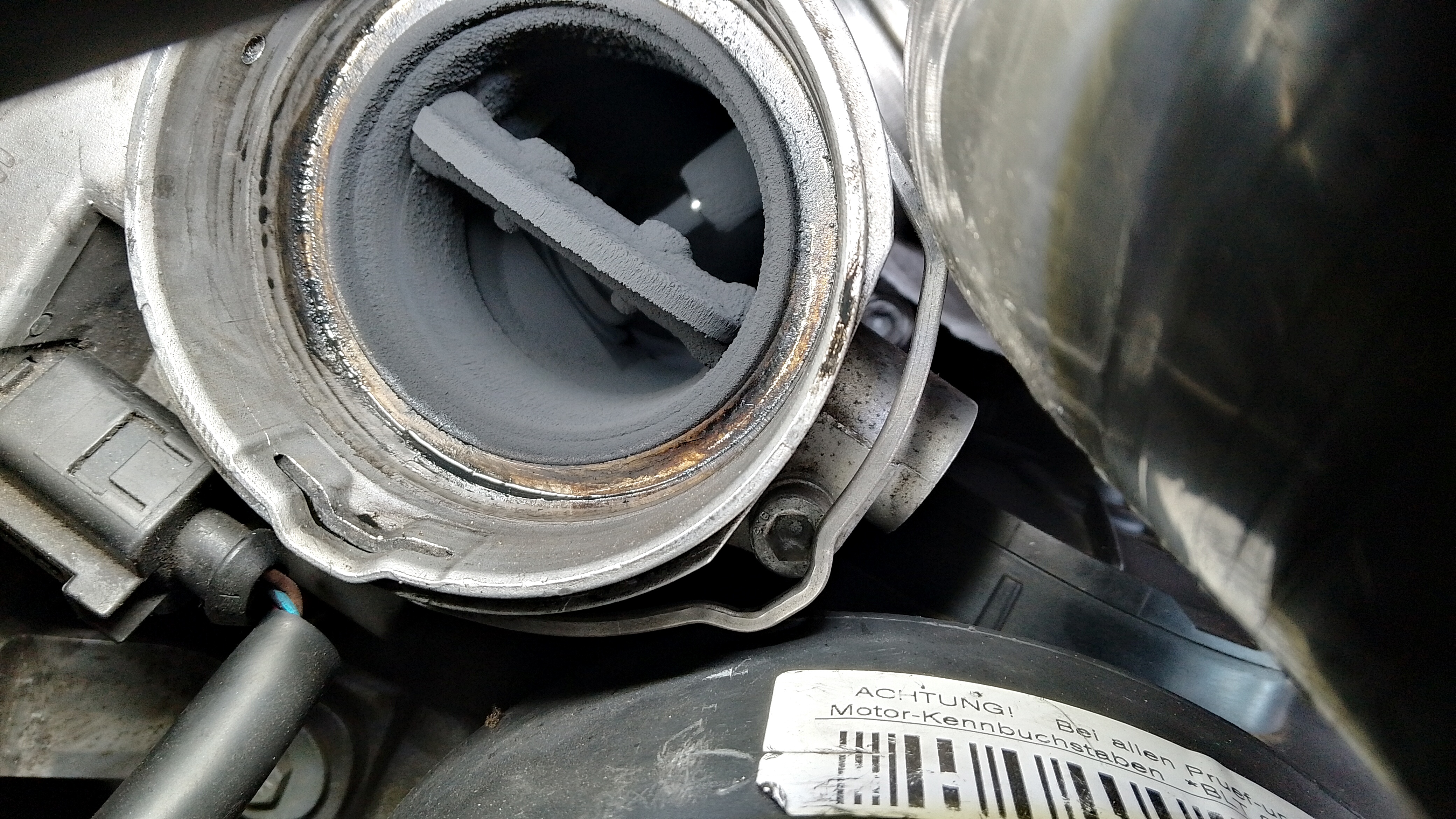

EGR looks ok, but coated in very dry soot, never seen it like that before. Usually, it is oily. Matches what is coming out my exhaust, a puff of black soot on acceleration. Dry soot left on tailpipe.
Turbo you think? I'm going to take to garage but wanted as much info as possible to save them time and reduce bills.
