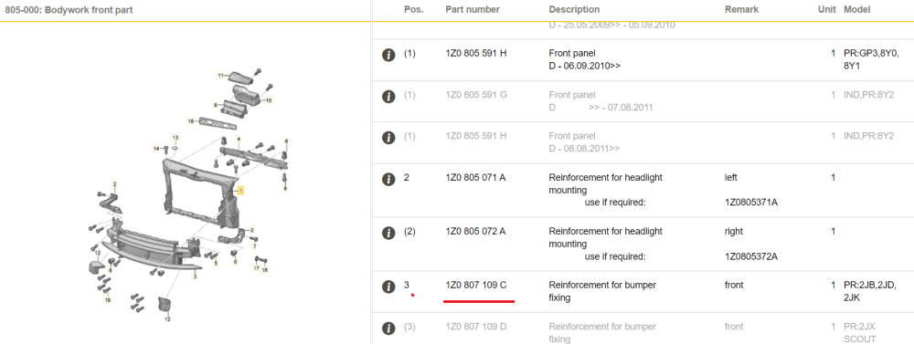

The first one, suffix C suits standard and sports bumpers, whatever they are.
Suffix D one suits 'comfort bumpers', whatever they are!
If you're lucky, you may see one of the PR codes 2JB, 2JD, 2JK or 2JX on the build options sticker in the boot. Only the last of those requires the suffix D part.
I've been hunting for the right part at the right price @Breezy_Pete and I turned up one with the suffix C, brand new for £47.44 + delivery of £8 and customs duties and taxes and collection fees from Germany bringing the total to £117.51 which seems quite a lot. Then I found this one which Autodoc said was just £8 delivery and didn't mention anything about duties and taxes. I couldn't see any of the PR codes you listed. I noticed that this large piece of metal is all quite wavy and inprecise looking. Is that normal? The breakers are a bit hit and miss when I ask questions about a part. They generally don't know very much other than its metal.

Message me with your VIN and I can give you a definite part number for the car.

The bumper differentiations are in the plastics and lighting.  The underlying metalwork is common to almost all mk2 Octys with only minor variations as per the parts catalogue.
You can see the bumper plastics variants below.  Note that there are minor variations by model year and PR codes so do check:

Hi Pete,
Thanks! My VIN is TMBEH21Z4B2123010.

Morning,
As expected your VIN gives the suffix C part as correct for your car; feel free to ask if there's any further bits you need to research:
On 06/07/2023 at 10:42, Breezy_Pete said:
Morning,
Thanks very much Breezy.
