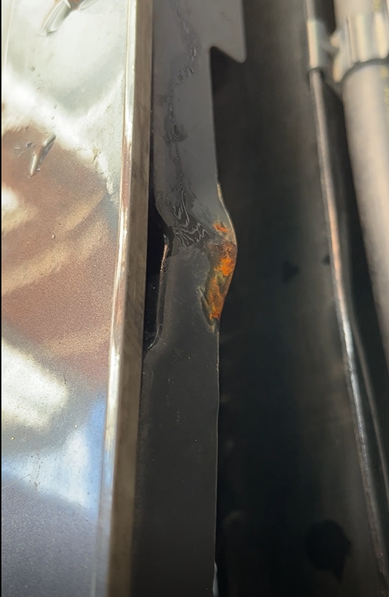

This basically defines what I wish to do. Some idiot did a recovery on my car and put a hook around the bumper rail to tow it and pull the bumper rail out of shape and unable to fit the front bumper properly.
Does any member have access to drawings that show the structure underneath the front bumper. A garage did a good job of making it worse, seemingly unable to ensure the bumper is secure and the shut lines are right.

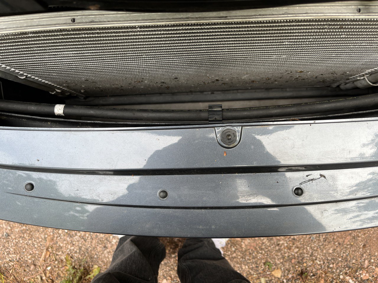

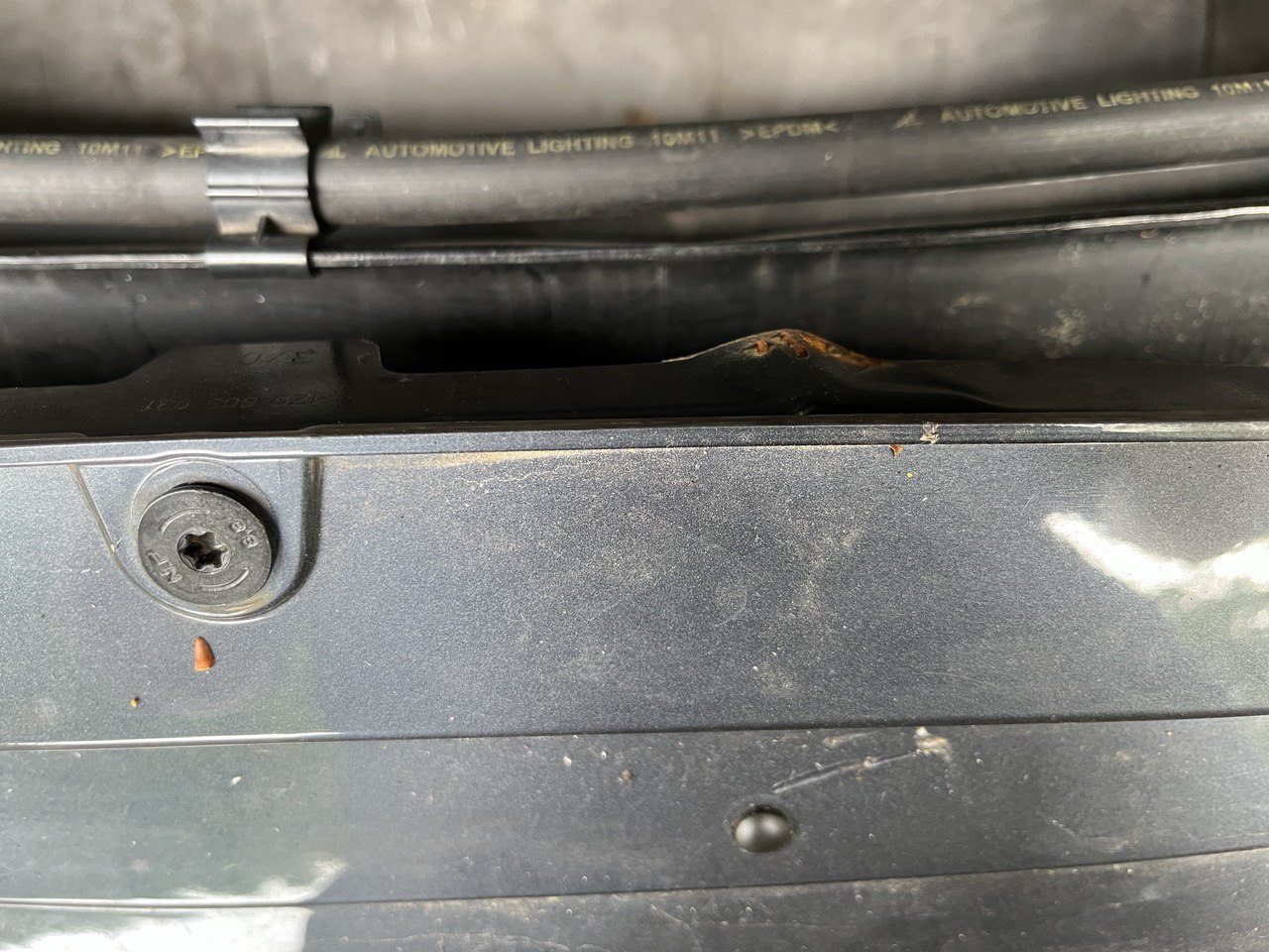

What angle is that photograph taken from and what is it showing please?
I'm really not sure what I am looking at, is it the headlight above and the crash beam below with the bumper removed.
The rust there suggests that the damage was done long ago, knowing how tightly the pieces fit together I am surprised he was able to attach to it, was your towing eye perhaps missing from the boot? Without that he would have been between a rock and a hard place, using a hook (is what it looks like) on the crash beam that contains the threaded boss for the towing eye was probably the least worst choice.
That photo is taken from above, facing the front of the car, looking over the plastic top edge of the front bumper and back to see the metalwork beneath. That is what the person tried to hook onto.
As for the rust, it starts off bright when its new, so I know the damage was recent. I know the damage was recent because I am always over my car and this would be so obvious, as it was when I noticed it, shortly after my car was returned.
As rust gets older it goes darker. Fresh rust is never dark. This is the same no matter what surface it is on except aluminium in which case it is oxidation that gets whiter. Towing hook always in the inbuilt tool box in the polystyrene container, however, many Octavias do not have a toolkit at all, just a bottle of tyre inflator and an emergency kit.

No there is no panel gap under the headlamps. I suspect you aren't visualising the space we are talking about. It can only be seen with the bonnet open. Also the rust you see is a result of the damage from someone's hook on the barely painted crash bar. The part is not visible unless you stand right over the centre of the front bumper and look backwards because the frame is under the bumper. The recovery vehicle tried to put the hook over the crash bar having opened the bonnet to do so. Very sloppy. Indicates they had no knowledge of how to secure the vehicle. If you ever need to be recovered, always stand over the guy, male or female, to make sure they are not doing what you do not agree.

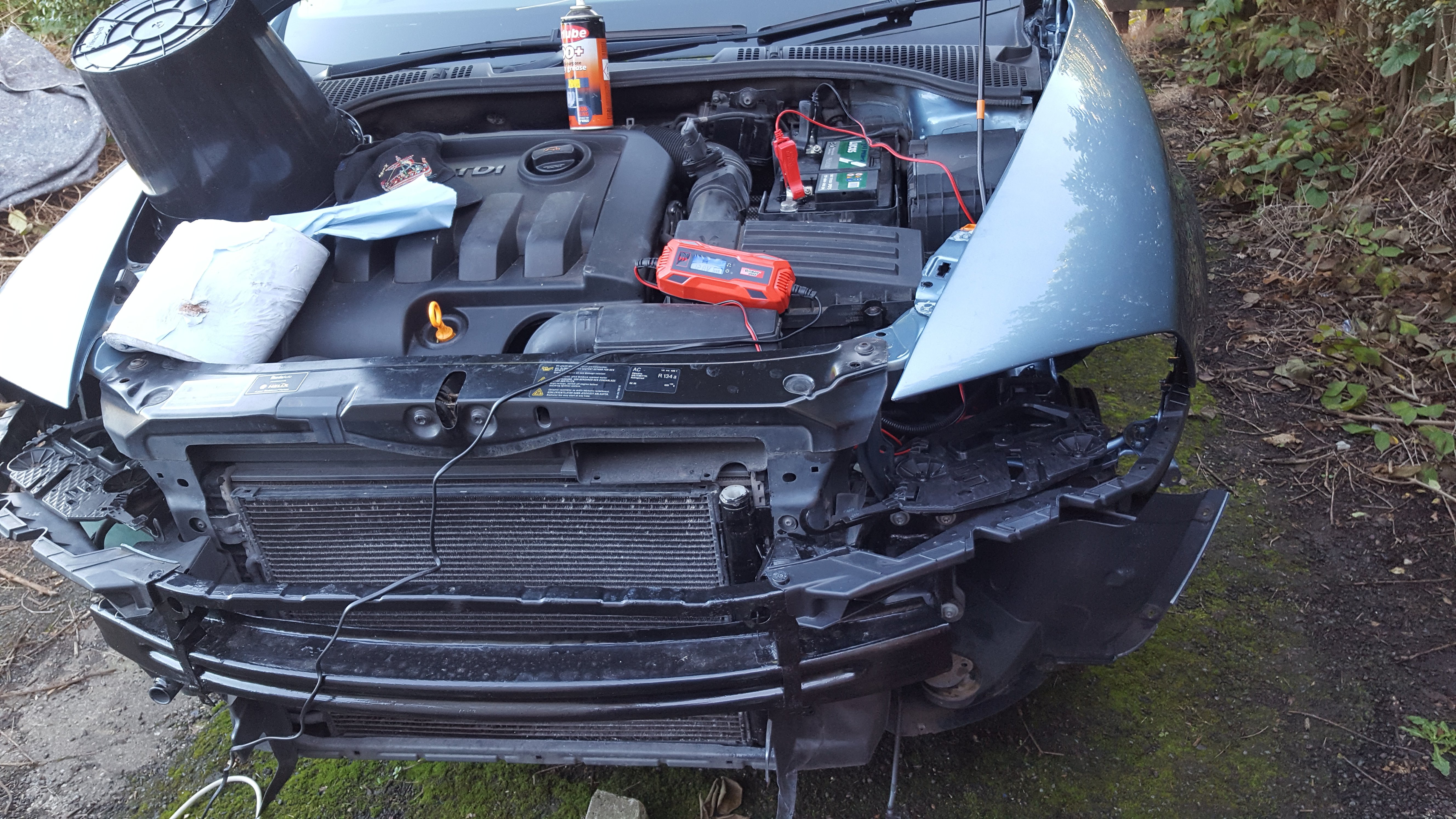

Here's a view of our 2007 1.9tdi mk2 Octy with the plastic bumper removed.
Note the bucket is not an original factory fitment :)
The photo was not at all clear which was why I asked the question:

I'll take another photo and hopefully you will get your bearings. The headlight is not above the damage I am referring to. Let's see what I have come up with here.... Do these give you your bearings? What are you trying to do? I'm just going to take my bumper off to replace the crash beam. This nasty bit of damage you can see in the second photo ruined it.

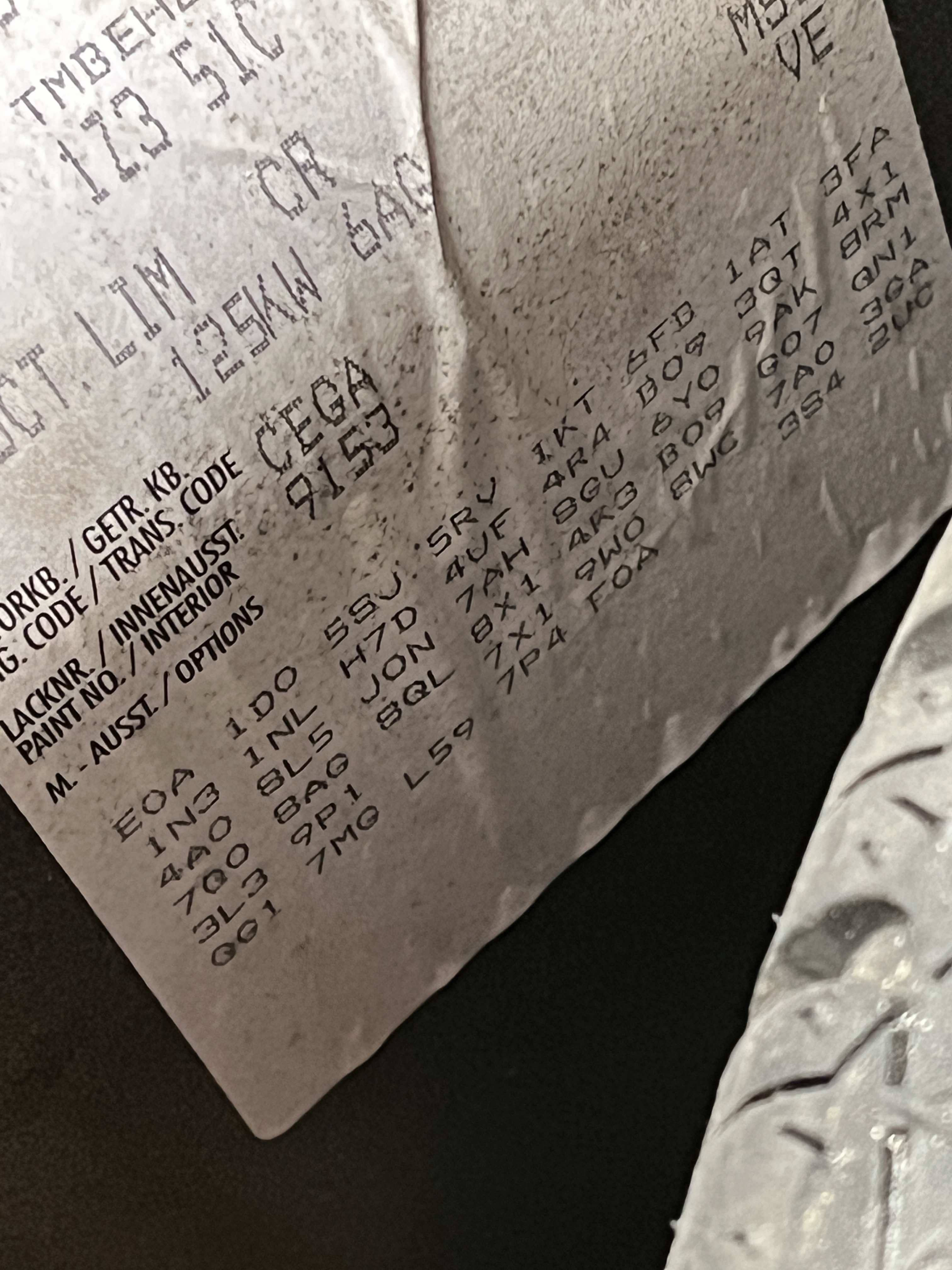

If you're lucky, you may see one of the PR codes 2JB, 2JD, 2JK or 2JX on the build options sticker in the boot. Only the last of those requires the suffix D part.
Thanks Breezy_Pete. As my car is a VRS, I presume (I know I mustn't do that) it may have 'sports bumpers'. I do come across some very strange names for VAG parts, often not intuitive at all. Anyway will take a look at that sticker in the boot just to make sure my sports car doesn't have comfort bumpers @Breezy_Pete! Thanks for that guidance.
