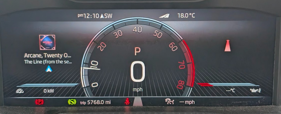

I am new here and have no idea where to post this but…. I need help, I’ve just got a Superb 2021 L&K and the image on the virtual cockpit shows the wrong doors open, I.e drivers door UK should be right image of car but it’s the passenger door showing as open and visa versa. Is there a way to change this via OBDEleven as it seems to be showing the car as non UK. Sorry if the post is in the wrong section!

I have attached the backup, I hope this helps. Thanks in advance.
OBDeleven_Log.txt
Have you done any coding at all?
Just to double check, your car in a UK RHD.
