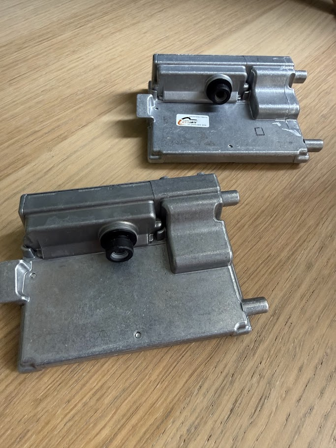

I have two cameras 2Q0 where I installed a patch to activate all SWAP functions - including TRAFFIC SING RECOGNITION.
So all You have to do is replace the camera and remove CP (eventually do some basic codings).
2Q0 980 653 H:11 SW:1027
2Q0 980 653 D H:16 SW:1401
If You are interested - contact me 😁
Why Change Camera? Firmware Update?
You can change to mine camera or I can update it remotely if You have ODIS interface.
But from my point of view it will be easier a lot just to "patch" camera on bench and then change it.
Misunderstood, poor translation on my part. I meant that I think replacing the camera is unnecessary.
Yeah - it can be done without replacing the camera.
But You need ODIS Online and a knowledge how to do it.
But still - if You want replace 3Q/5Q cameras to 2Q0 is a perfect solution.
And for most of people it will be just easier to change the camera instead of "patching" unit.

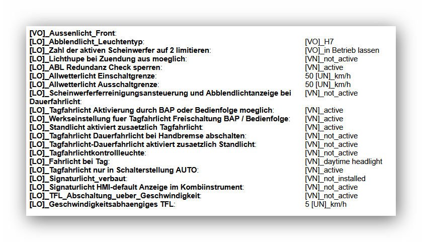

Hello, I also have a Superb FL 2019 with Matrix headlights. I’m not sure if I’m writing this correctly, but these are the adaptations for 09-Central Electrics. What do you have in the parameter Aussenlicht_Front (0A58) - Abblendlicht_Leuchtentyp (0/0/2)?
I have H7 there, and I don’t know why, since I don’t have halogen bulbs but LED Matrix headlights.
Hi,
I have taken a screen shot of my STG09 section in ODIS that you are looking at.
It is a 2023 SIII.
Do you have any problems with the light?
Edited by 26DIPP
My DRLs were not working in the AUTO position, but now they are. I’m only interested in the Abblendlicht_Leuchtentyp parameter – it is set to H7 (halogen headlights), even though I have Matrix headlights. So it should probably be set to GDL_mit_Zusatzscheinwerfer. But if you also have it set to H7, then it’s probably correct.
