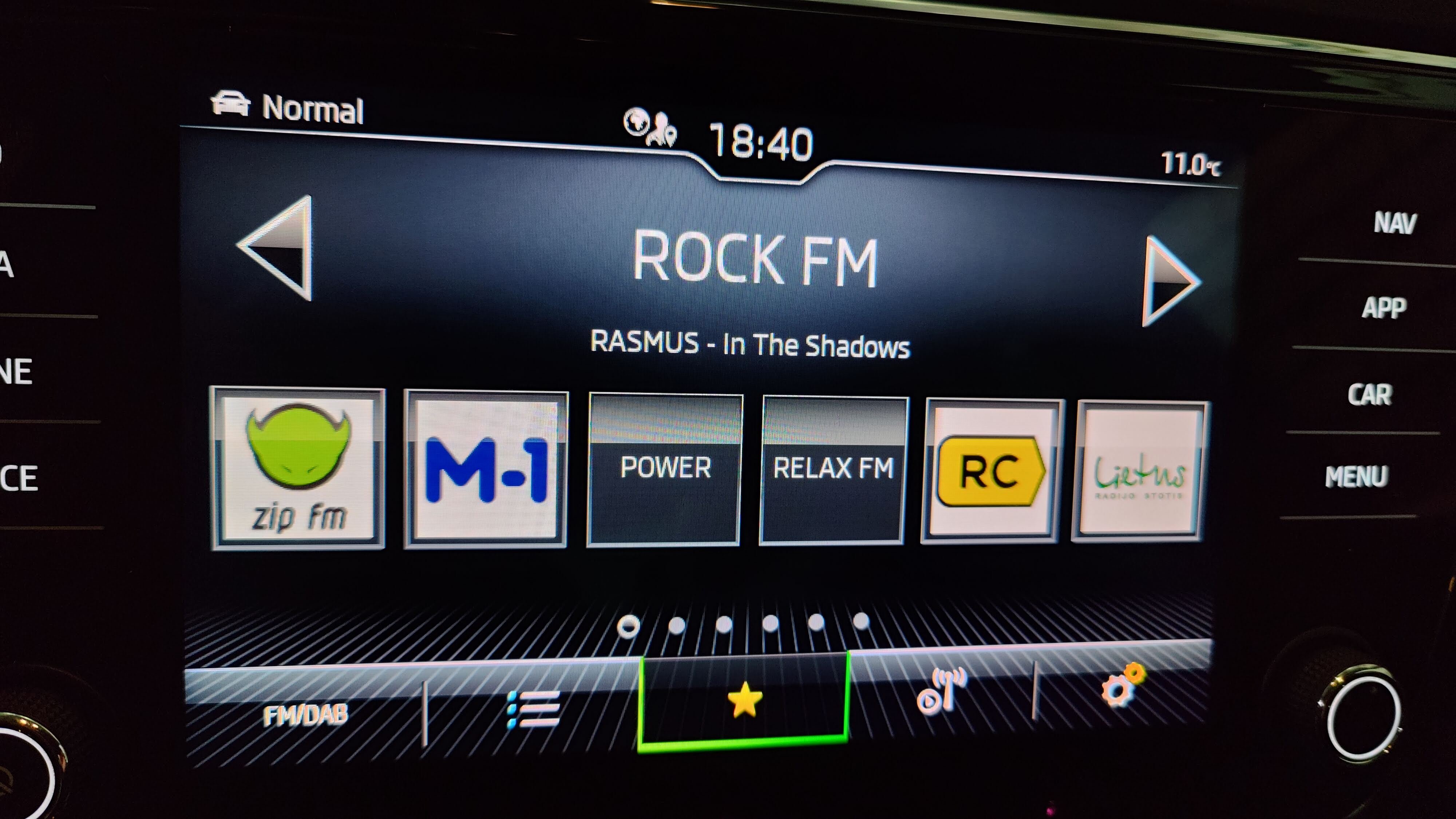

  • Thanks MartiniB.   The MIB3 (Superb etc) file loaded successfully into my Karoq's MIB3 Amundsen, and seems to have created some of the missing radio logos. (Pity I still haven't got any for

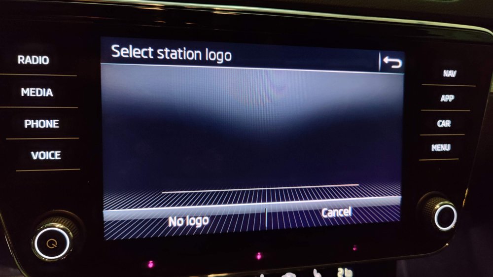

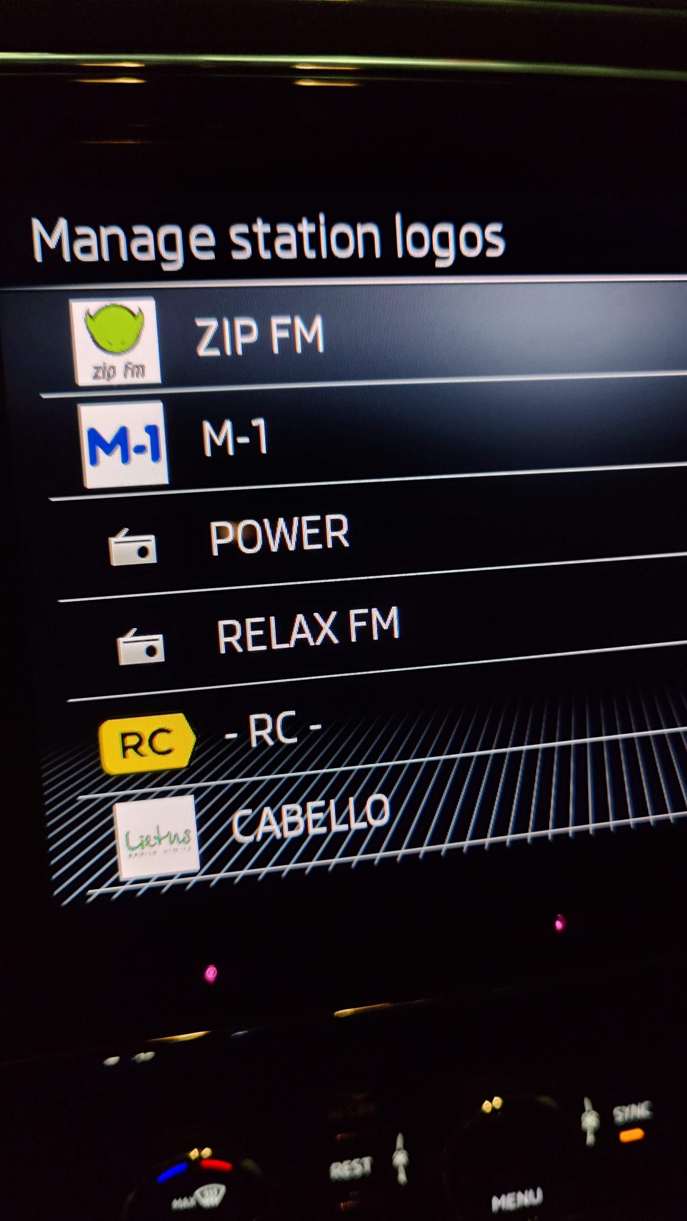

Here's how it looks. I’m only missing these (there are more but less important), all the others already had logos from before.

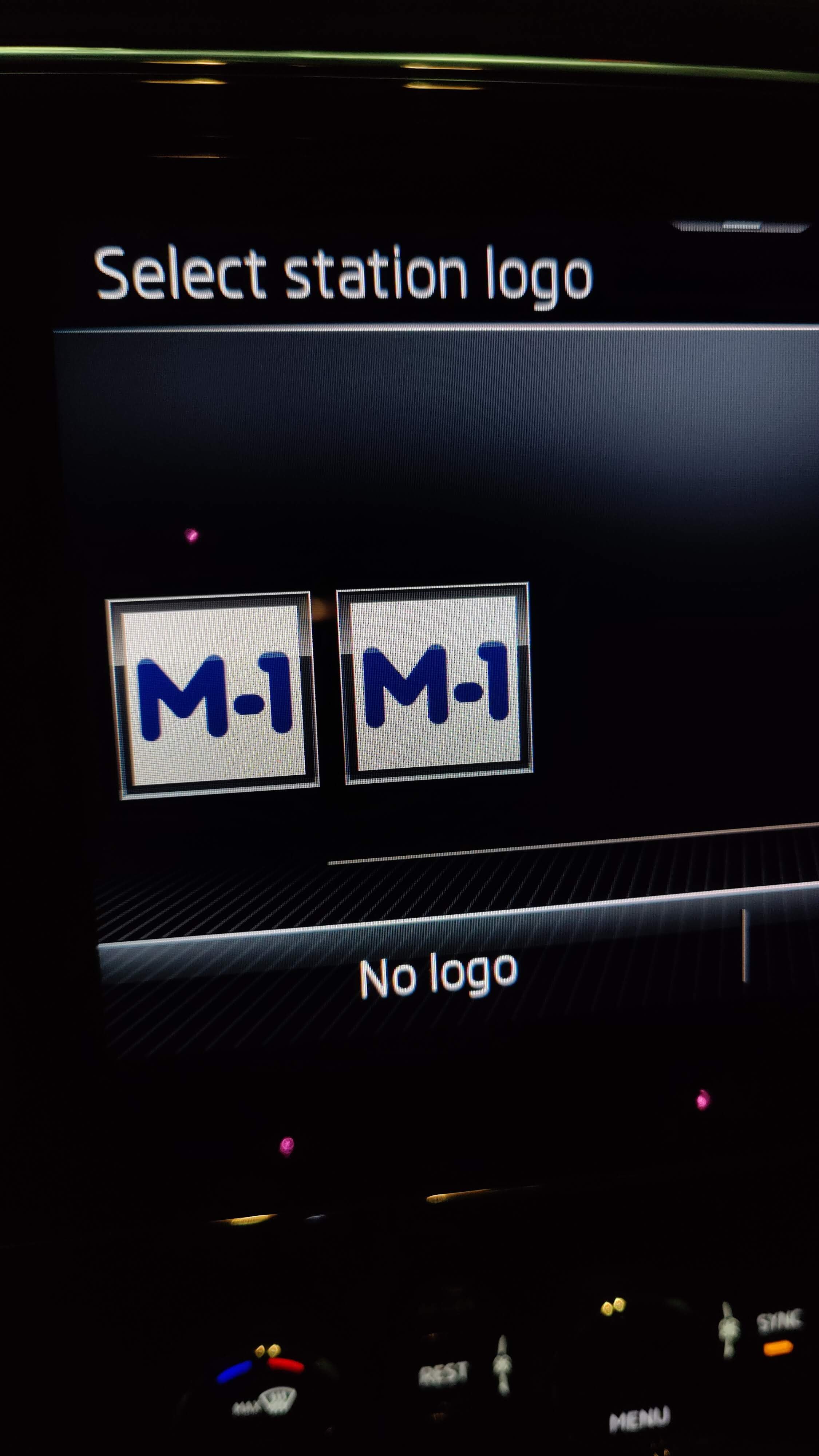

POWER, RELAX FM when try set logo show (5.jpg)

What is meant Phonostar hasn't populated the logos. I got the Phonostar TV Android app and I reckon if I searched in it I won't find them either... and you won't find them on the mib2 file either.
Reckon they don't broadcast that on their Internet service so it has no logo. The achilles heel of how Vag gets it's logos. It's not been thought out. In the UK commercial stations tend to get left out. Suspect in Germany the logos are fully populated. It's just poor QA by Vag on their contract with Phonostar.

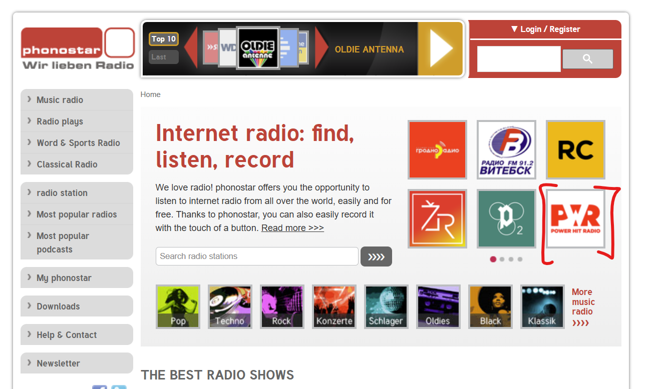

In website i see logo, old but logo is. New logo this (7.png). I try email phonestar.
Not consistent then.... for Seat Phonostar don't construct their files for Seat although the connect services do get the updates, not via the download since the identity for Seat is missing but still has the holes in the logos. It's a shambles between Phonostar and Vag. Something about keeping your old mib2 car 😉.
There is a broadcast identity and that has to link up to the logo so in your case they haven't got that right... Power Hit Radio is too lively for me. I did actually use Phonostar internet radio when the Kodi addon Radio... app stopped working on the migration of Kodi... but another developer released radio.de... no adverts like Phonostar and you can add your own logos.. unlike Mib3:).

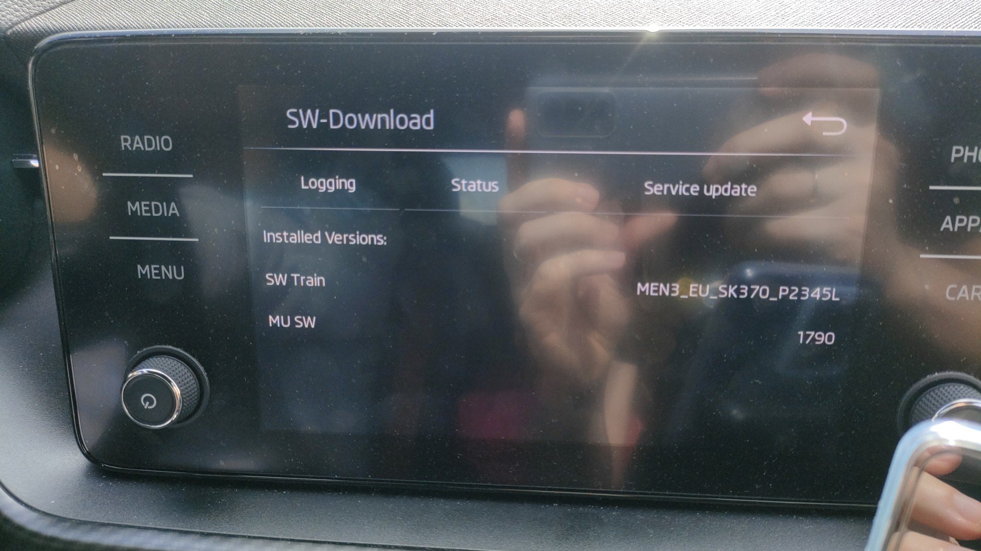

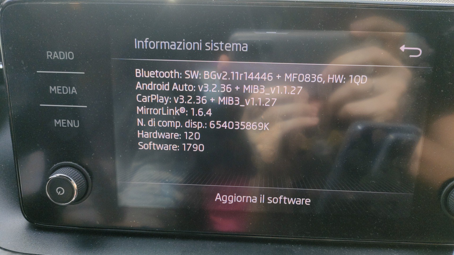

Hi, I have a Skoda Kamiq Monte Carlo from January 2024. The radio currently has the firmware shown in the attached photos. In the various menus, I couldn't find an option that clearly tells me which station logo database is currently installed
No way: I can't figure out which version of the database is installed on the radio; moreover, I tried all the packages available on the first page, but none of them are recognized as an "update" by my radio (I used a USB-C stick formatted in FAT32, and extracted the various archives directly onto the root of the USB stick, not inside subfolders).
It could be one of the ones where the part number is missing from the file. Vag use to do that and have done that or their contractor with the radio icon files. It gets a bit technical. You have to get hold of the firmware file, check the part number list against the one in the radio icon file. You may find a missing part number. Sadly if that's the case you can't edit it in. The files are locked down by the signature. You report it Phonestar and hope they sort it out if that is it.

Hi, I currently have this firmware installed: MEN3_EU_SK370_P3355L MU1800, and I have the zip archive saved on my PC. Where can I find this "component code"? And once I find it, what should I do with it? Keep in mind that in the radio menu, I can't find the version of the radio logo database listed anywhere clearly. While exploring the secret menu, I found this info: "tunerdb_device 1.30.22", but it is very hidden.

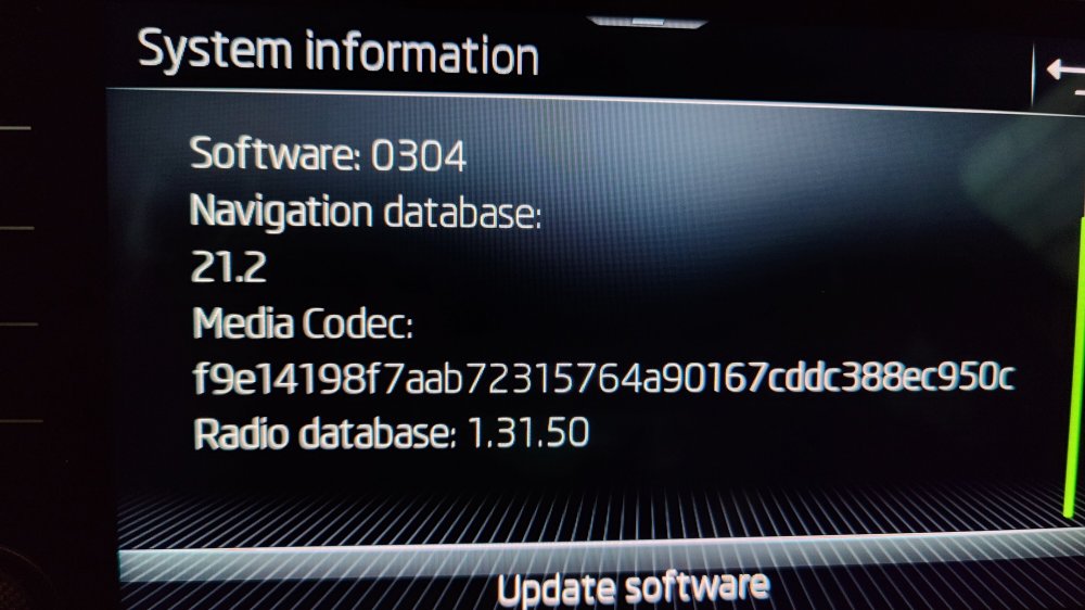

Hi, I also have a Skoda Kamiq (Montecarlo 2023), and I just updated the firmware to version 1800. Hidden in the secret menu, I found this: "tunerdb_device 1.30.22". Have you managed to update the radio logo database?
It's the main.mnf files that steer whether you can update and you can't edit these since they are locked down by encrypted signature.

Hello, everything is clear, thanks for the response. In the 'main.mnf' of the firmware I have installed "MEN3_EU_SK370_P3355L", I find under the 'Variant' section:
'Variant': [ 'FM3-E2---SK-MQB-PA-*'"
So, if I understand correctly, if I don't find this variant in the 'main.mnf' of the logo database update package, the update will definitely not start. I have no way of manually adding this variant to the 'main.mnf' because the file is digitally signed by the creator of the package using dedicated tools
That's correct. The * means any so you might see that broken down perhaps in the other.

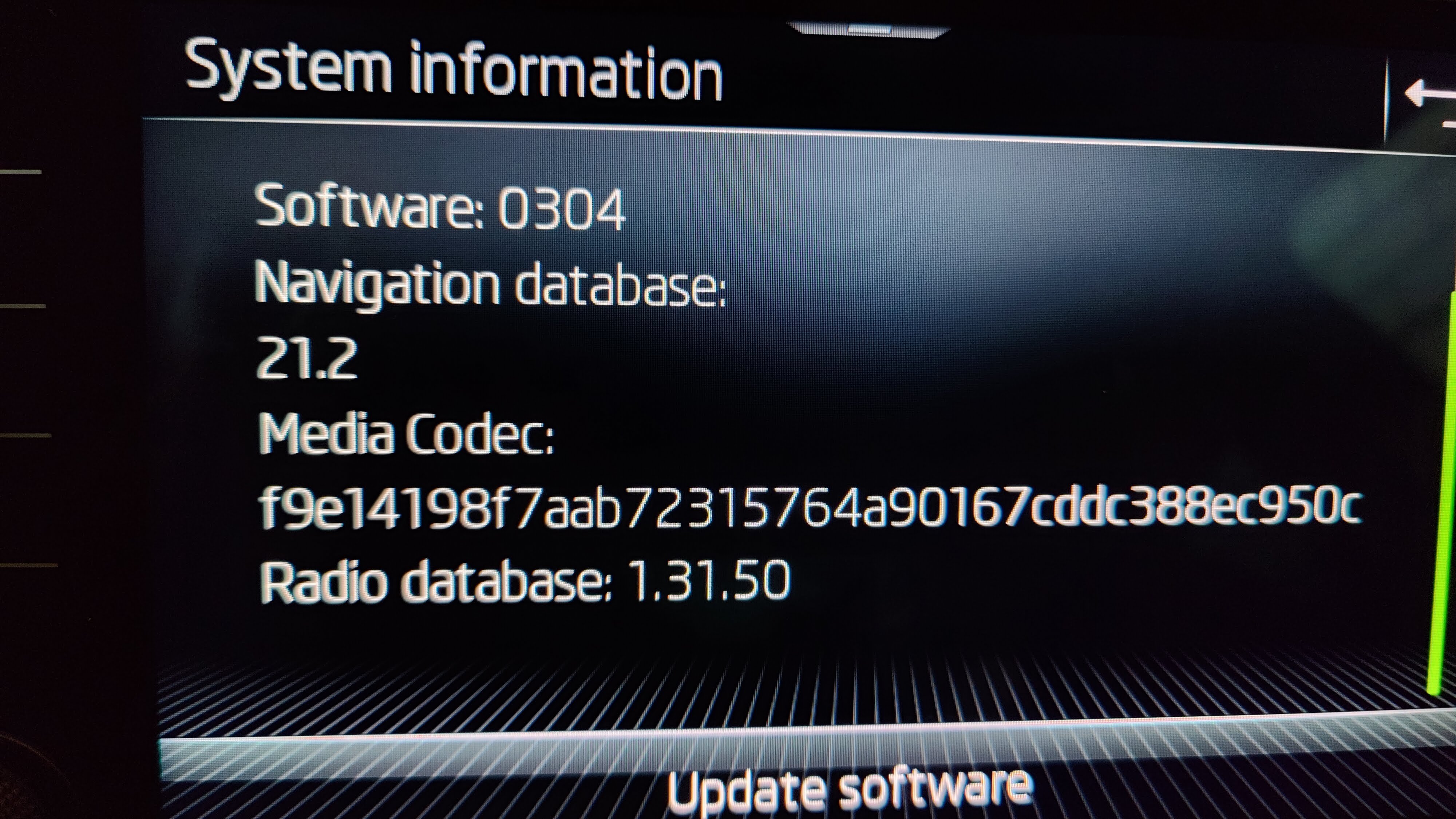

I say maybe be lucky to find a newer version by changing the number, I tried changing one number at a time AND: download/vw/MQB3_OI_JND_Europe_v1.31.50.zip to v1.31.51, v1.31.52 and at number 6 a new version was downloaded https://www.phonostar.de/download/vw/MQB3_OI_JND_Europe_v1.31.56.zip
Install and don't see any change, the required logos missing...
