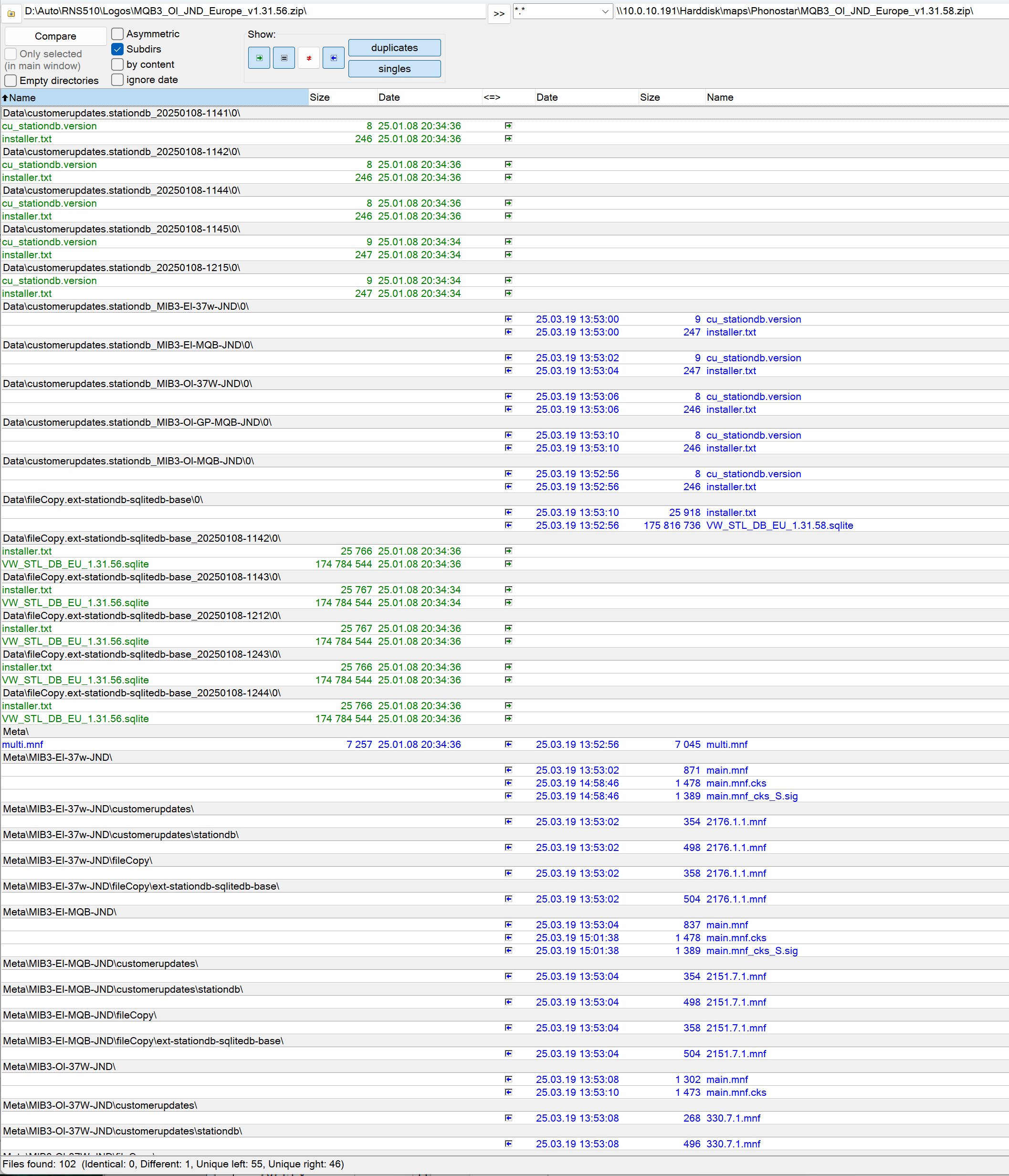

no joy with upload latest v1.31.58 into Mib3 Amundsen of ŠS Mk3.FL 2023
after confirm `Update` comes immediate "Complete" and nothing has been changed :(
structure of new archive is different
